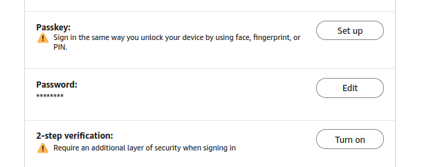

looks like your account may be trying to send to phone for a login -- can u remove 2fa maybe?
It already says 2fa is not enabled....
Screenshot from 2026-10-17 07-47-19
what about login and security at the top- is there a setting to use cell# for signing in (like One time password stuff?)... i see it on mine - looks like I could add support to do that - its been very successful in the other TVE providers.
I just did a manual login....no options, just says it sent a passcode to both my phone and email (I did receive the email). I agree it's strange...seems like 2fa is being forced regardless of the setting.
