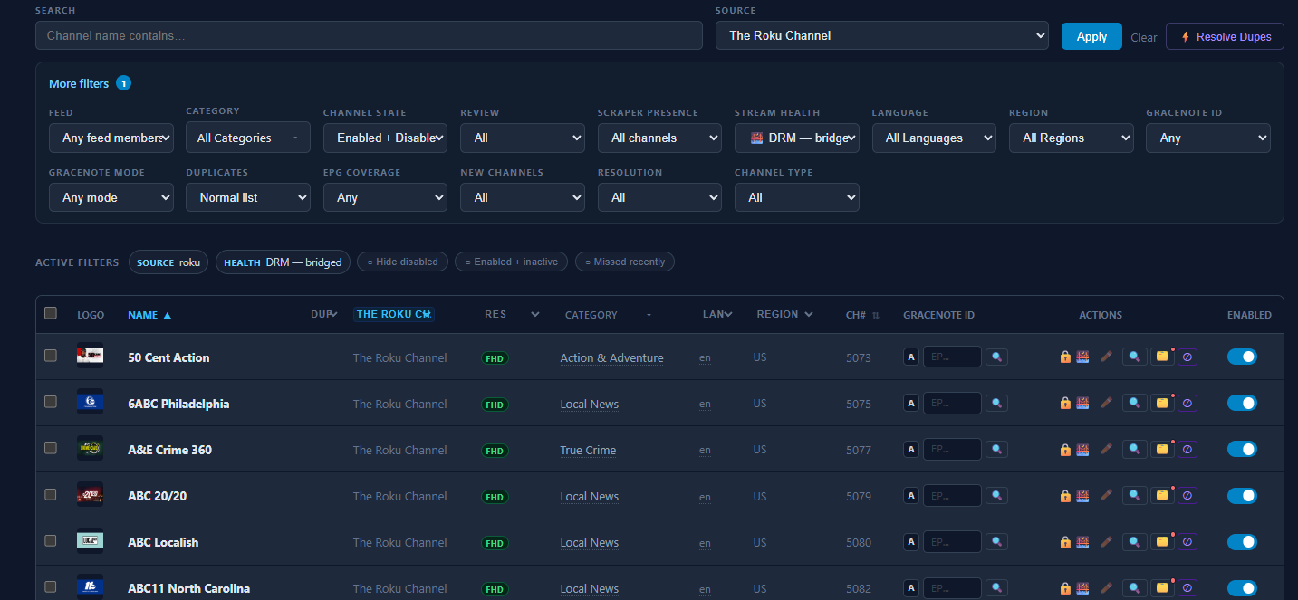

The filters show a ton of DRM Bridged stations - is that what you were looking for?
I didn’t know Pluto had some DRM stations (yuck). Is that under CA region?

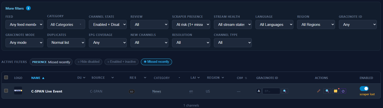

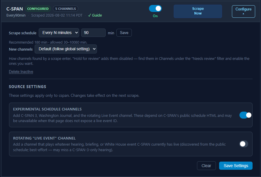

The C-SPAN Live Event channel keeps disabling due to missed scrapes.
Guess I have to pin it?

good point. that channel is very unique. it's kind of like an "overflow" type channel for this scraper so it could be missing during a scrape.
To answer your question, yes - pin it. I will add a way to auto-pin that channel in next version though.
