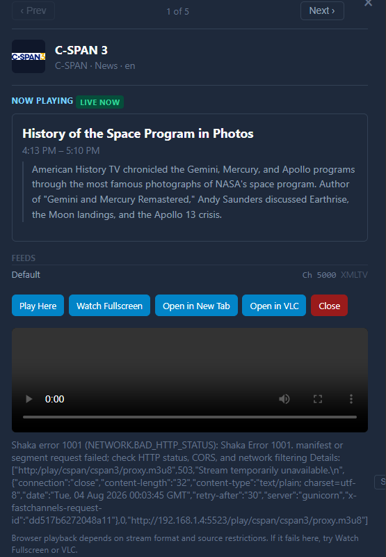

Is C-SPAN 3 DRM?
It gets a 503 error in Channels DVR
2026/08/03 16:52:51.751459 [ERR] Failed to start stream for ch5008: M3U: Could not fetch playlist from nas-1019:5523: GET: http://nas-1019:5523/play/cspan/cspan3/proxy.m3u8: 503 SERVICE UNAVAILABLE
and VLC
http debug: sending request: GET /play/cspan/cspan3/proxy.m3u8 HTTP/1.0 Host: nas-1019:5523 User-Agent: VLC/3.0.23 LibVLC/3.0.23 Icy-MetaData: 1
http debug: HTTP answer code 503
http error: error: HTTP/1.0 503 SERVICE UNAVAILABLE
and this Shaka error 1001 in FastChannels

that cspan scraper is funny... it's not a true "cspan3" channel. it goes to Cspan.com and grabs the live channels at that time. so think of it like "overflow" type channels.
basically, its unreliable... sorry wish it was cleaner - just out of my control.
I can see the same schedule on C-SPAN that's in FastChannels
https://www.c-span.org/schedule/?channel=3&timezone-toggle=PT
It just wont play
agreed-- but notice, there is no HLS link on that page at this time. Throughout the day, they publish an actual link that is playable. to get the true CSPAN3 (linear style), i'd have to get their TVE style link and link to your provider (and I think they have DRM). I haven't gone down that path with CSPAN3 but version 5.0.0 will have some cooler stuff than that -- certainly you dont REALLY want to watch cspan3 anyway? :rofl:
