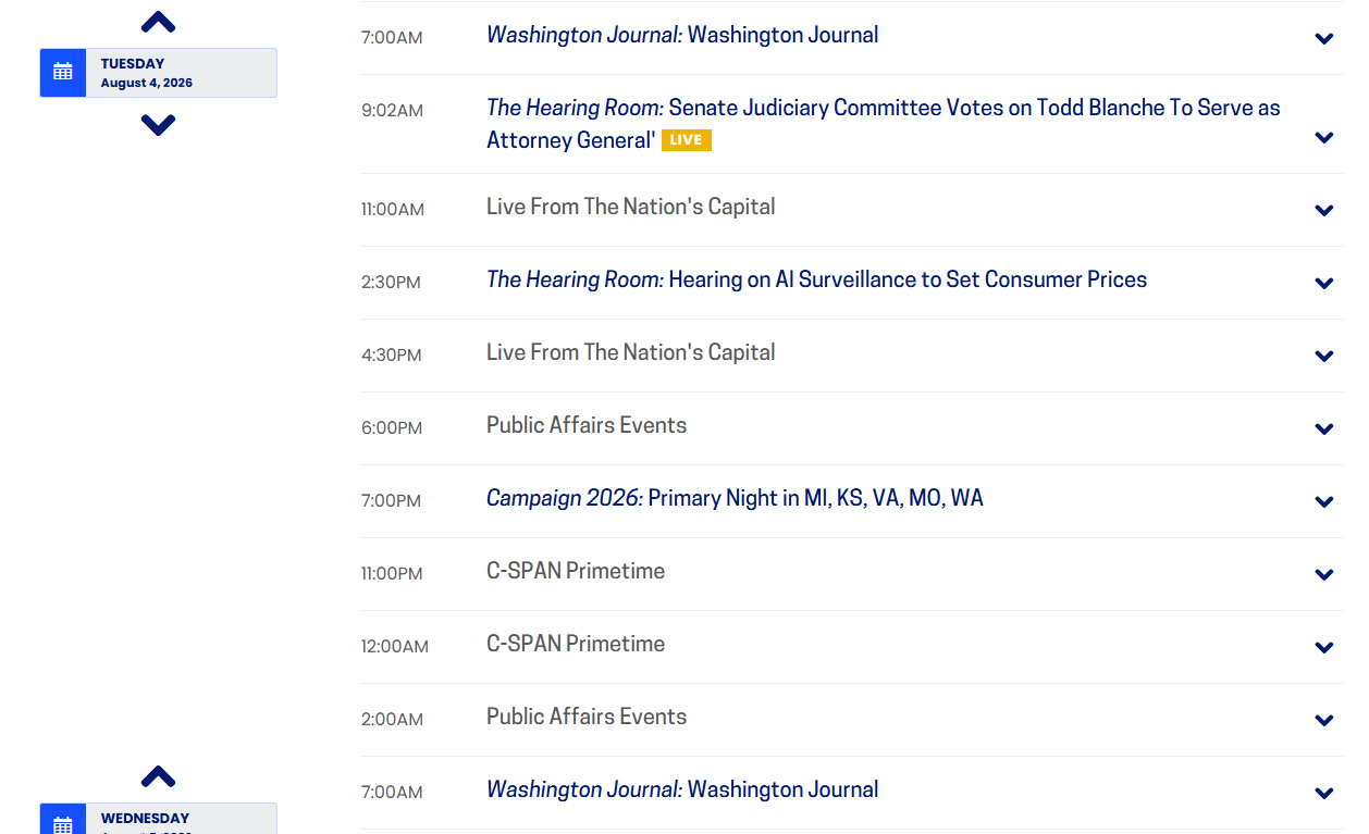

https://www.c-span.org/schedule/ ..
so the "LIVE" banner is what's playing on CSPAN Live Event right now (and Senate floor/House floor also have live streams right now).
I do agree it's confusing. Maybe I just rename CSPAN3 to "OVERFLOW"? Trying to think of a way to be most user friendly.

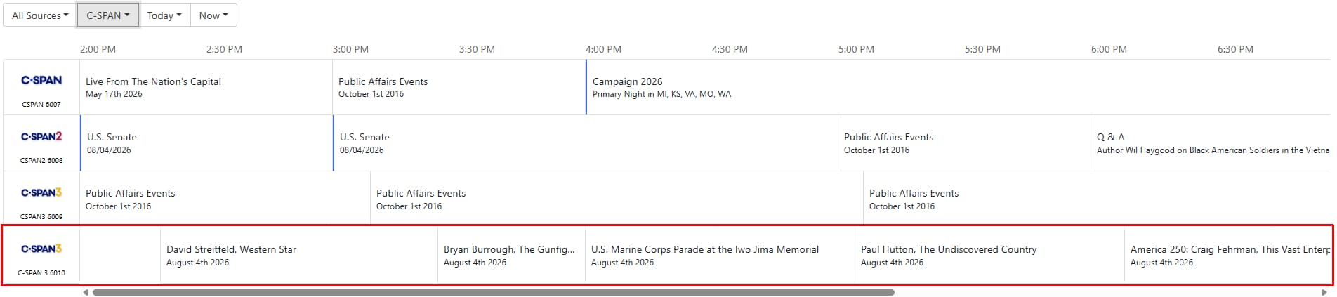

I was talking about C-SPAN 3, not your C-SPAN Live Event channel.
It's C-SPAN channel 3 (out of 3 channels there) and you are scraping the schedule for it

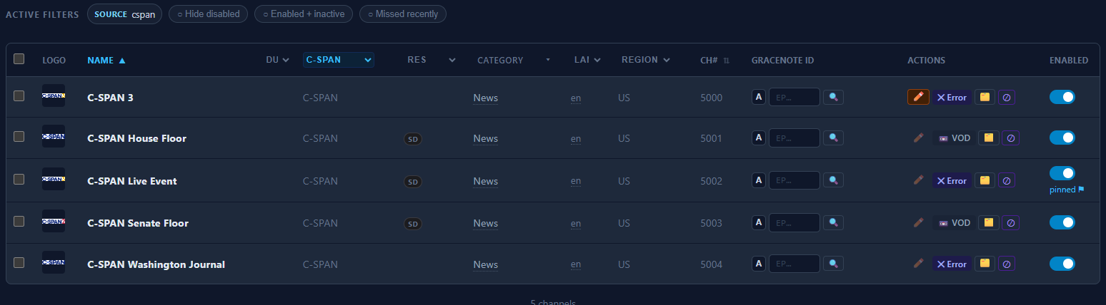

https://www.c-span.org/schedule/?channel=3
but you have to authenticate with TVE to play it, FastChannels won't play it.
https://www.c-span.org/networks/?channel=c-span-3
My question is why even list C-SPAN 3 in FastChannels if it doesn't play it. It led me to think it would.

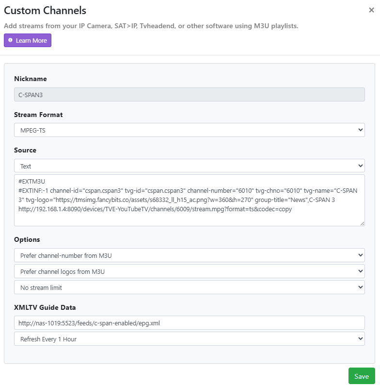

I figured out how to use your scraped epg and combine it with the TVE channel C-SPAN3 in CDVR, so playing or recording the channel uses CDVR TVE.
Just added custom channel 6010 pointing to my TVE channel
http://192.168.1.4:8090/devices/TVE-YouTubeTV/channels/6009/stream.mpg?format=ts&codec=copy
and your epg
http://nas-1019:5523/feeds/c-span-enabled/epg.xml
