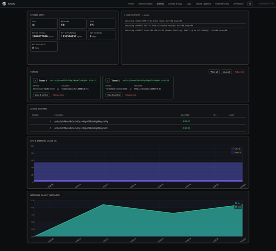

PR#41 submitted. ah4c now tells FastChannels, during the tuning process, which streaming stick to send commands to. This requires an updated set of scripts/firetv/fastchannels which can be downloaded in FastChannels, or they're now part of the ah4c container so that step can be skipped:
Two tuners in use, each tuned properly, with commands sent to the correct streaming stick -- based on the virtual tuner assigned:

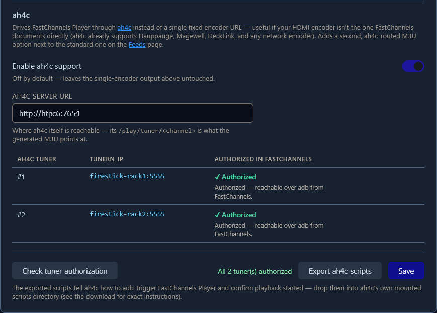

@KineticMan I'm also working on another PR that uses the ah4c API to get a list of defined virtual tuners, and confirm each streaming stick is ADB authorized in FastChannels. This seems important to me, since both ah4c and FastChannels need to maintain a separate set of valid authorizations to the same group of streaming sticks.
I'll probably submit this as-is, but I'm also envisioning a button, on each virtual tuner line to initiate a re-authorization -- if required:

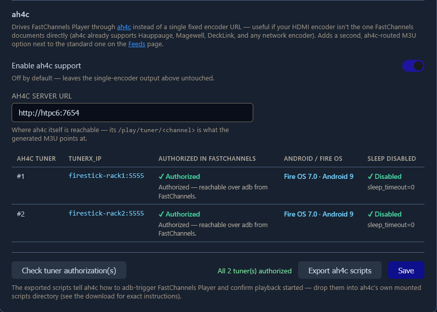

@KineticMan In fact, it's quick enough that I'm changing my tune on putting my sticks to sleep. Here's what I'm thinking for a revised check on adb authorizations, and whether sleep has been disabled (PR coming soon):
