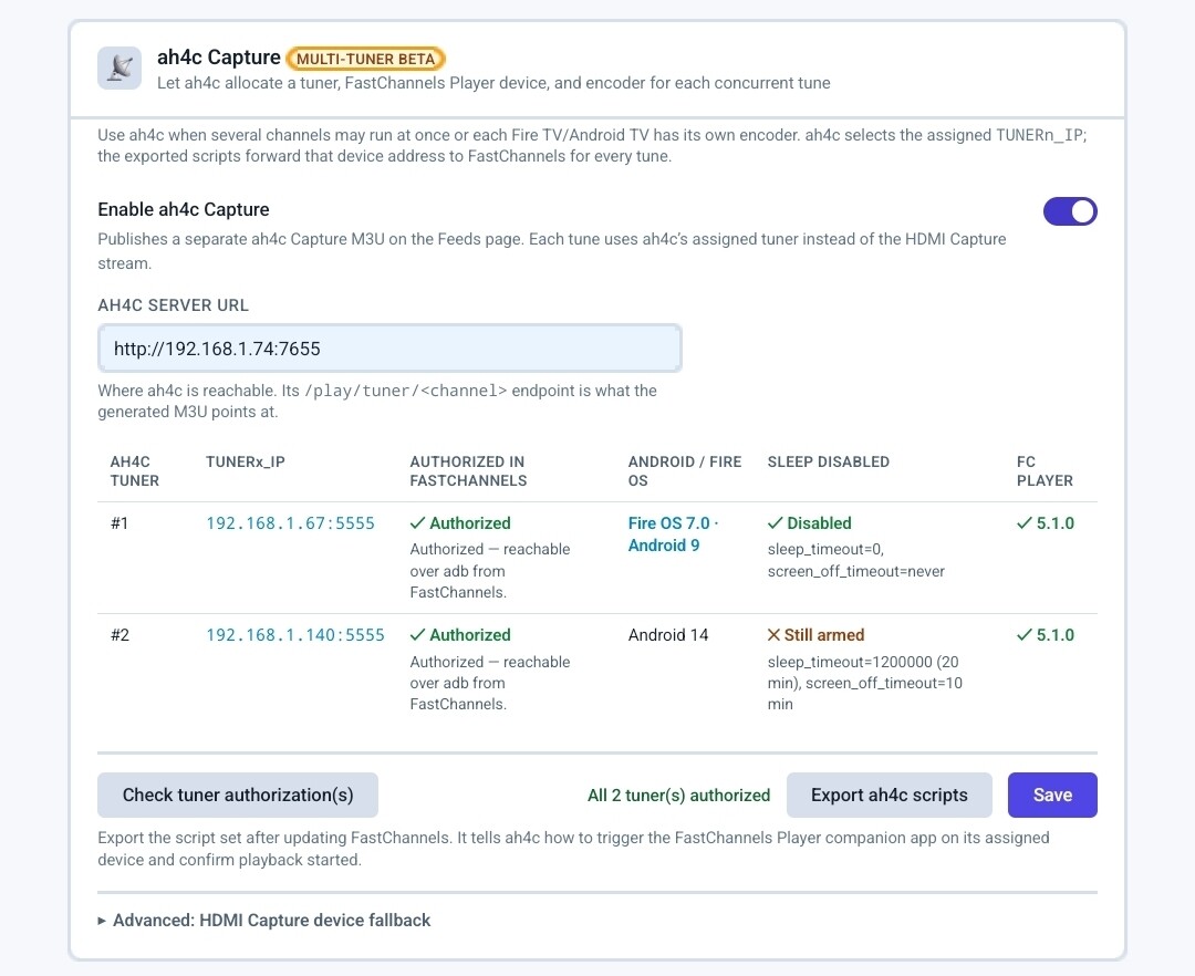

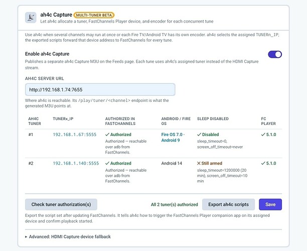

@Jean0987654321 What is ah4c Capture Check tuner authorization(s) in FastChannels showing?
@Jean0987654321
Make sure you're using this Docker Compose, and that you have the new FASTCHANNELS_URL env var defined in your overrides. Also, be sure you have the latest ah4c, and that your firetv/fastchannels scripts have a 2026.09.06 date a couple of lines below the shebang.

Ok, that worked. Must've missed that along the way lol
Things are moving quickly atm! :slight_smile:

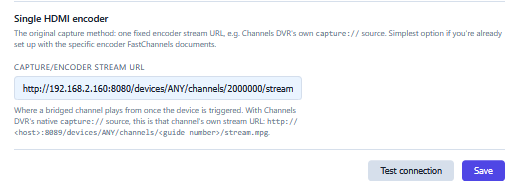

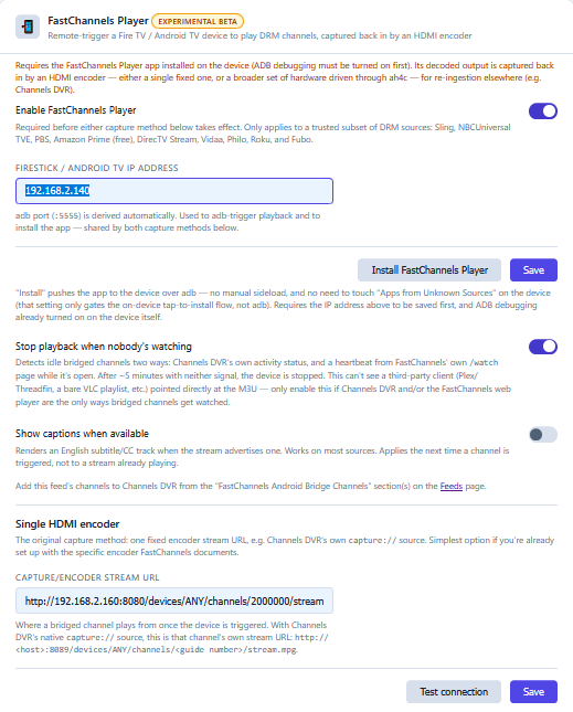

I clicked the install and it re-installed. I clicked test and got this:
Device reachable β€” FastChannels Player is installed. Encoder/capture stream URL is not reachable β€” bridged channels will fail until that stream is up.
Then I tried changing the IP included in the url under "single HDMI encoder' from 160 to 140 in case that was the issue (server is on 160 while stick is on 140), saved, and ran "test connection" again. Same results.

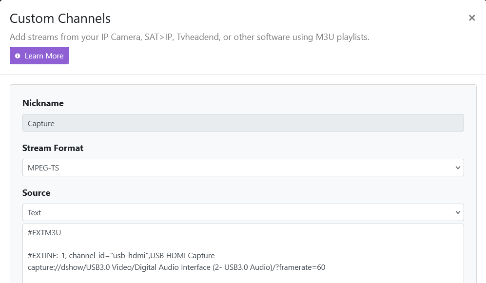

You should have a Custom Channel Source setup that looks very much like this one:
This custom source takes the input from your Capture Card and transcodes it into something useful. A Capture Card plus this Custom Source creates a "virtual encoder". These two together do basically the same job as a LinkPi or URayCoder.
This is the first building block we need to nail down.

I then tried setting up a source:
I also found some instructions (probably the ones you're thinking of) in the github docs folder (would have preferred them in the FC screens themselves, but I finally found them). Here's the part that I can't follow (starting with step 2):
Once the capture source appears as a device in Channels DVR:
  1. In FastChannels, configure the Channels DVR URL under Settings.
  2. In the HDMI Capture card, select Find from Channels DVR.
  3. Search for and select the channel backed by the HDMI capture device, then select Use selected stream. Capture/HDMI-like names are shown first.
  4. Select Save in the HDMI Capture card.
What does it mean "in the HDMI Capture card, select...." The capture card provides no obvious way to talk to it that I can find.

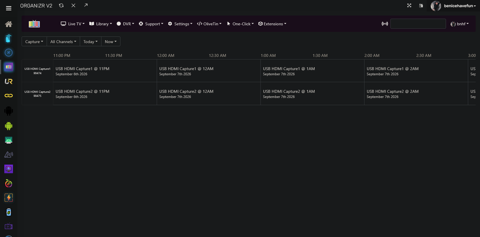

OK, good. Now, if you look in your WebUI guide, you should find a source that matched the nickname you chose. Here's mine:
I have two Capture Cards, but you'll only have one. Click on what's in the current time slot, and view it just like you would a normal channel. You should see the homescreen of your FireStick:
Make note of the assigned channel number (90474 in my case), and build your virtual encoder URL, using my description here:
That virtual encoder URL goes here, in place of the incorrect one you entered:
Screenshot 2026-09-07 at 23-14-14 image(2).png (PNG Image 519 Γ— 645 pixels)
Save it, and you should be able to Test connection.
If successful, you now have a virtual encoder.

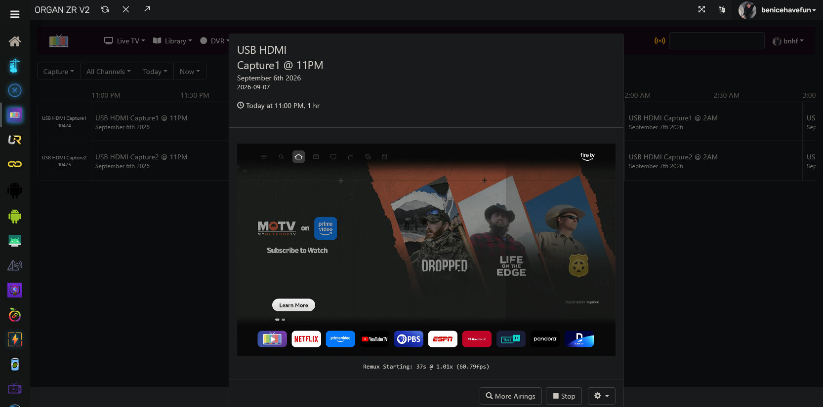

Ok, I think I finally got it (partially) working, with a few remaining significant issues:
I did finally (thanks to your instructions and one change that I had to make (see below) get to the point where I could watch video from the Android Bridge channels. However, there are two significant problems for making recordings (possibly also for just watching, but I'm in the process of testing that).
  1. To view anything but the screen saver (if the stick has been quiet for long enough to go into sleep mode), I have to press a button the remote.
  2. After just a few minutes (3 or so?) of recording an actual airing, the stick reverts back to the Fire Stick home screen and that's what gets recorded for whatever duration the airing was supposed to have. I am "watching" something on another tab right now and simultaneously recording it to see what happens, but while that might be somewhat diagnostic, it's not how I want to use the feature. (Update): In this case it lasted about 10-11 minutes before reverting to the home screen or screen saver.
I found the fire stick setting to disable the screen saver, and set up yet another recording for later to see what happens.
Here's what I ended up doing to get to the current point (in addition to your instructions, which were essential:
My server runs headless and I talk to it via Windows Remote Desktop from my daily driver PC which sits right next to the server. I had the RDP set so that it's supposed to send the server's audio to the remote PC (which is why the ffmpeg command referenced "remote audio." I made an alternate RDP profile that left the audio on the server machine and reran the ffmpeg command, which gave me a different result for the audio portion. I updated the USB-HDMI setup with the new string and all of a sudden I can see the fire stick when viewing the HDMI tuner in Channels, instead of an endlessly spinning circle of doom. (Odd that both audio and video were failing prior to the change when the only thing that I changed to fix was the audio setting).
I then proceeded with your instructions to complete the setup.
So I've made progress but still have the problems noted.
In the Github docs, I find the following, which doesn't match anything I see on my FC admin screen. It looks like it might be helpful in diagnosing the sleep and early reversion to home screen issues, but it doesn't seem to be available (could it be something planned but not yet implemented?) These are the ones I mean:
Before attempting a real bridge-only channel, use Bridge β†’ Post-install Healthcheck β†’ Run healthcheck. It checks the configured hardware paths without tuning a channel, samples the configured HDMI Capture stream from inside the FastChannels container, and Copy forum report creates a concise, credential-free report to attach to a support post. PrismCast has its own specialized capture test in the PrismCast Capture card.
When the non-disruptive check passes, Live bridge test is the optional end-to-end confirmation: choose one bridge-ready channel, confirm the warning, and FastChannels tunes the Player device then samples the HDMI Capture stream. It intentionally interrupts anything playing on that device. The result shows the tested stream path, payload size, timing, and whether the Player reports active playback. It also reports the MPEG-TS program's detected video/audio types when they appear in the short sample. Select Stop test playback when you are done to close the Player immediately.
The automatic stop option detects viewers using Channels DVR's activity status or the FastChannels /watch page. It cannot detect a third-party player connected directly to the M3U. Leave this option off if you watch that way.
Fire TV Device Controls next to the Install button is the quickest way to diagnose a headless device: it shows ADB reachability, whether the screen is awake, the installed player version, and current display timeouts. Apply headless preset keeps a powered device awake and prevents its screen/sleep timeouts from interrupting the HDMI encoder; FastChannels saves the prior values so Restore previous settings can put them back later.
I turned off the automatic stop feature in the FC admin page to see if that would fix reverting back to the home screen; it didn't, so I turned it back on.
Ok, I'm done for the night. Tomorrow I'll check the latest recording attempt, but if you have any ideas in the mean time, would appreciate.

I don't know FastChannels very well, but these are the steps I took to get this working.
FastChannels 5.1.0 (current docker version as of 2026-09-07)
Presuming FastChannels is configured (time zone, server url, etc.)
  1. Enable Channels DVR Support
    http://x.x.x.x:5523/admin/settings
    Enter your Channels DVR URL
    (this had to be enabled, otherwise FastChannels would throw an exception trying to convert "US:10511" into an integer)
  2. http://x.x.x.x:5523/admin/settings
    Enable FastChannels Player
    Enter one of your ADBTuner android device IP addresses here, click save, click Install FastChannels Player. Repeat for all ADBTuner connected Android devices. Leave one IP in this box, doesn't matter which.
I had to share my adb keys with FastChannels to make this work. Added an extra volume to docker-compose.yml and put my adbkey and adbkey.pub in the adb_keys directory next to the compose file. Not sure if there is a better way to import keys into FastChannels.
volumes:
  - db_data:/data
  - ./adb_keys:/root/.android
  1. http://x.x.x.x:5523/admin/settings
    Enable ah4c support, enter fake URL in box:
    http://127.0.0.1
    It seems this has to be enabled before FastChannels will provide a playlist of "bridge channels"?
  2. Add Vidaa source:
    http://x.x.x.x:5523/admin/sources
    Turn Vidaa TV on, click "Scrape Now." Wait until complete.
  3. Approve New Channels
    http://x.x.x.x:5523/admin/channels?review=pending
    Wait a bit until complete

Trying to read up on how to use this HDMI capture method for DRM before diving in. In the documentation, it says to follow this walkthrough to set up your capture device:
But if I click that link, it goes to this reply:
I looked at posts before and after and don't see anything that looks like a walkthrough on correctly setting up the capture device in Channels. Can anyone point me in the right direction?
I also saw someone making a comment that maybe some newer Firesticks don't work for this because you can't sideload. Is this correct? Is there a particular Firestick model I should be looking for?
Yes. The newest ones with the VegaOS won't work.
FireStick 4K Max (Gen 2)
Have you reviewed this document?
Yes, I was reviewing that document. That's where my first screenshot came from, telling me to go to a link in the forum for a walkthrough on setting up the capture device, but the link doesn't seem to go to any sort of walkthrough, it goes to someone talking about missing logos.
Here is a link to the whole thread, USB HDMI Capture. Hope it helps.
I'm hoping it's just that he's taking some well deserved relaxation time, but I'm a bit worried about @KineticMan. He's usually a prolific poster and we haven't heard a word from him in days. Are you doing okay man?
Latest recording attempt also reverted to home screen after about 10 minutes. To try to rule out Fire Stick issues vs. bridge issues, I set the Fire Stick (running on its own, not through FC, viewed using Potplayer) to play something from Netflix. It played through about 27 minutes before I manually stopped it.
Then I found Amazon Prime's live channels & played it for just under 20 minutes before manually stopping. Again, no problem. So the problem isn't with the fire stick or the HDMI to USB interface; it is happening somewhere in the FC-Channels chain.
