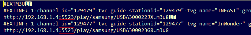

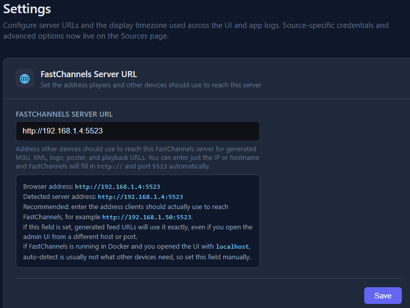

I wanted to check this out and had put it behind a local Traefik proxy and ran into a funny issue where all the generated URLs contained a custom port, but I was exposing it on the standard https port. Is there a trick to get it to not specify a custom port in the URLs in the m3u?

Never tested but I’ll add support (assume you mean external port)
Ah, thank you!!!!!! And let me add to everyone else's accolades that this is a phenomenal project. It must be since the Dev's highlighted it on their community project page. :slight_smile:
This port number
in the playback URL's?
