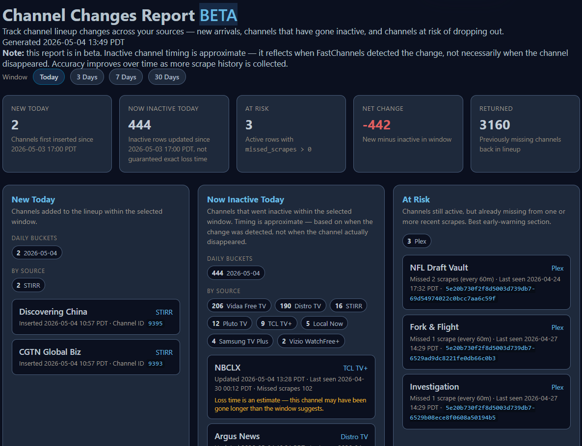

New Today and At Risk look correct for today.
Not sure about these numbers (seems too high)
  • Now Inactive Today - 445 - Inactive rows updated since 2026-05-02 17:00 PDT, not guaranteed exact loss time
  • Returned - 3164 - Previously missing channels back in lineup
Now Inactive Today
Channels that went inactive within the selected window. Timing is approximate — based on when the change was detected, not when the channel actually disappeared.

I'm finding the Channel Changes Report useful to see what new channels have been added and which channels are at risk.
My problem is trying to correlate the data for the at risk channels.

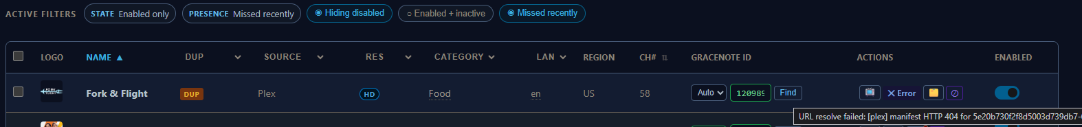

For example, Plex Fork & Flight is listed in the report as missing 1 scrape
It's still in my output feed, but doesn't stream.
I have my Plex source set to scrape every 60 minutes.
The report is saying "Last seen 2026-04-27 14:29 PDT", which is 7 days ago.
What does "Last seen" mean?
Going to the channels tab I do an inspect and see a 404 (not found?) error.

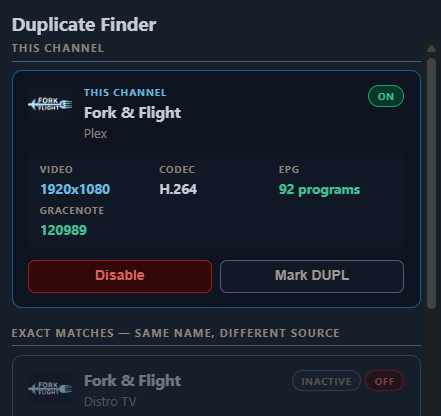

Looking at the Duplicate Finder to see how many scrapes were missed doesn't show any.
Even though the report says 1 missed scrape.

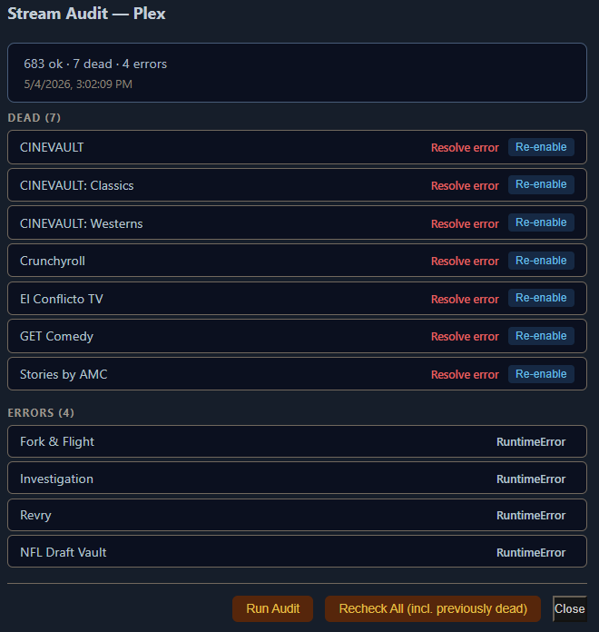

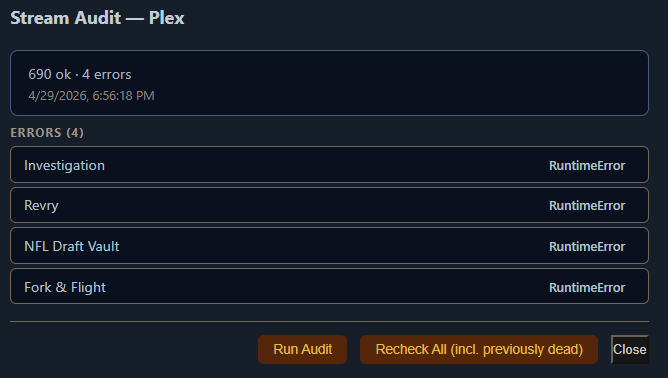

Looking at the Audit for my Plex source shows "RuntimeError" during last Audit 5 days ago
brave_screenshot (3)
So I ran the Audit again where 404 and 504 errors are shown as RuntimeError
2026-05-04 14:46:12,026 WARNING  app.worker: [audit] resolve failed for Fork & Flight: [plex] audit manifest HTTP 404 for 5e20b730f2f8d5003d739db7-6529ad9dc8221fe0db66c0b3
2026-05-04 14:50:01,893 WARNING  app.worker: [audit] resolve failed for Investigation: [plex] audit manifest HTTP 404 for 5e20b730f2f8d5003d739db7-6529b08ece8f0608a50194b5
2026-05-04 14:57:34,285 WARNING  app.worker: [audit] resolve failed for Revry: [plex] audit manifest HTTP 504 for 5e20b730f2f8d5003d739db7-68c86f0bda79d98d977dc90c
2026-05-04 15:01:48,684 WARNING  app.worker: [audit] resolve failed for NFL Draft Vault: [plex] audit manifest HTTP 404 for 5e20b730f2f8d5003d739db7-69d54974022c0bcc7aa6c59f
Shouldn't the ones getting a 404 be marked as Dead ?
