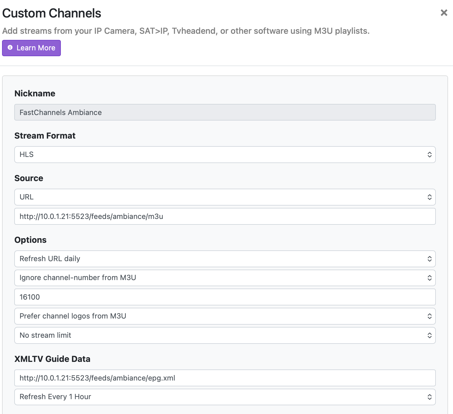

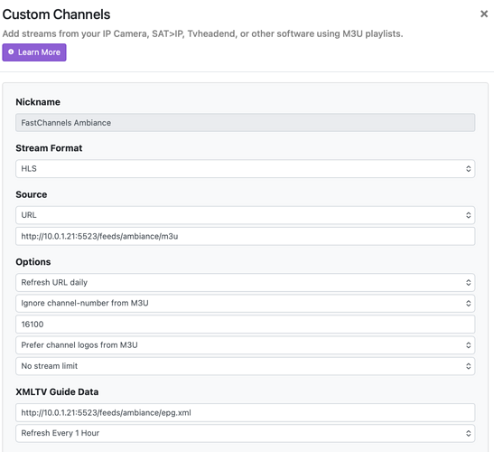

Hmm, I wonder what I'm doing wrong, then. I'm home now, and testing. Using FastChannels 3.5.1. Other channels are playing fine, but this first attempt at a YouTube livestream does not.
These are my settings:
The FastChannels log says:
2026-05-05 21:48:14,753 INFO app.routes.play: [play] request ip=192.168.65.1 source=custom channel_id=108ec551-bf4d-49aa-a6dc-5a1ec8ebd380 channel_name=Lofi Girl: Relaxing Piano Radio Calm Music to Focus To
But on AppleTV Channels client I get this error:
Streaming to the tuner failed. Press play to try again.
M3U: Could not parse playlist from 10.0.1.21:5523: Can't detect playlist type
Am I missing something obvious?

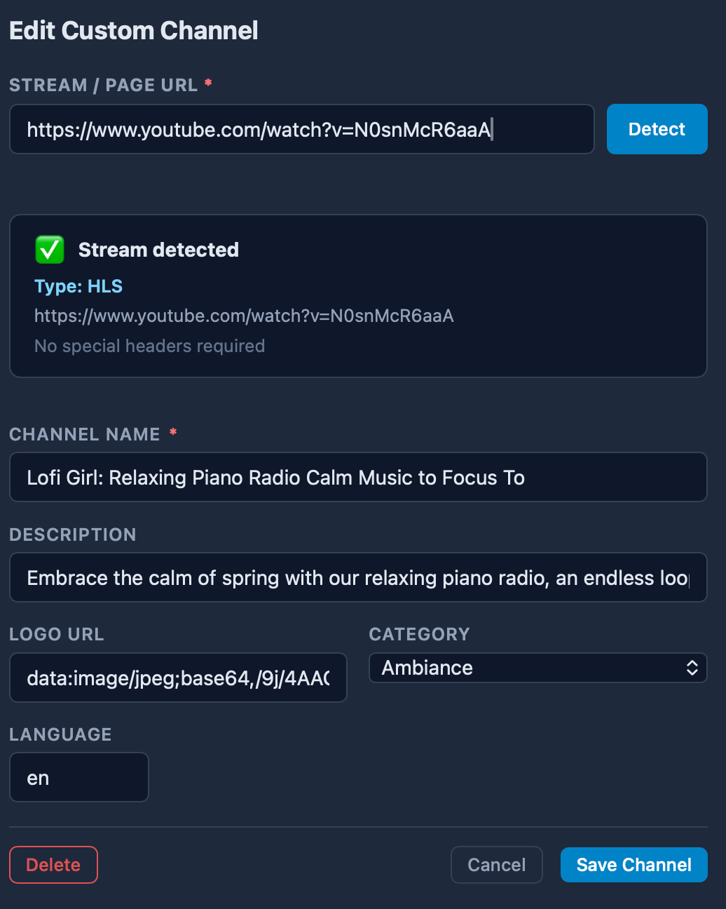

I don't think you did anything wrong. Looks like the detector didn't pickup the right URL after detection (notice it's still the webpage url). I tested the URL you put in there and got a really long one (what I've noticed with other YouTube live streams). Try detect again?
yep - bug in Plex detector. fixing.
also, i'll look more into the channels report. like I mentioned, I did very little with it to start. Basically, its looking at the data it has - which is last scrape. so, if one of your scrapes failed for some reason (most likely 403, the upstream API just had a hiccup), it would count that scrape as valid still (for this report). I'd probably need to re-think the logic there, but honestly not sure how deep I'll go on that report since it's pretty niche.
Thanks, that did the trick, it works. I'lll be using this feature a lot and will be adding lots of live streams now. Awesome!
I'm pleased to report that sometimes... triple stamping works! :slight_smile: I just tested remotely again (over cellular) and the same livestream is playing fine via Channels my usual way, without requiring a VPN or Tailscale. Turns out the error I was getting this weekend when traveling wasn't because of the stamps, it was because the correct URL hadn't been detected by FastChannels in the first place and I didn't notice. Thanks for the solution!

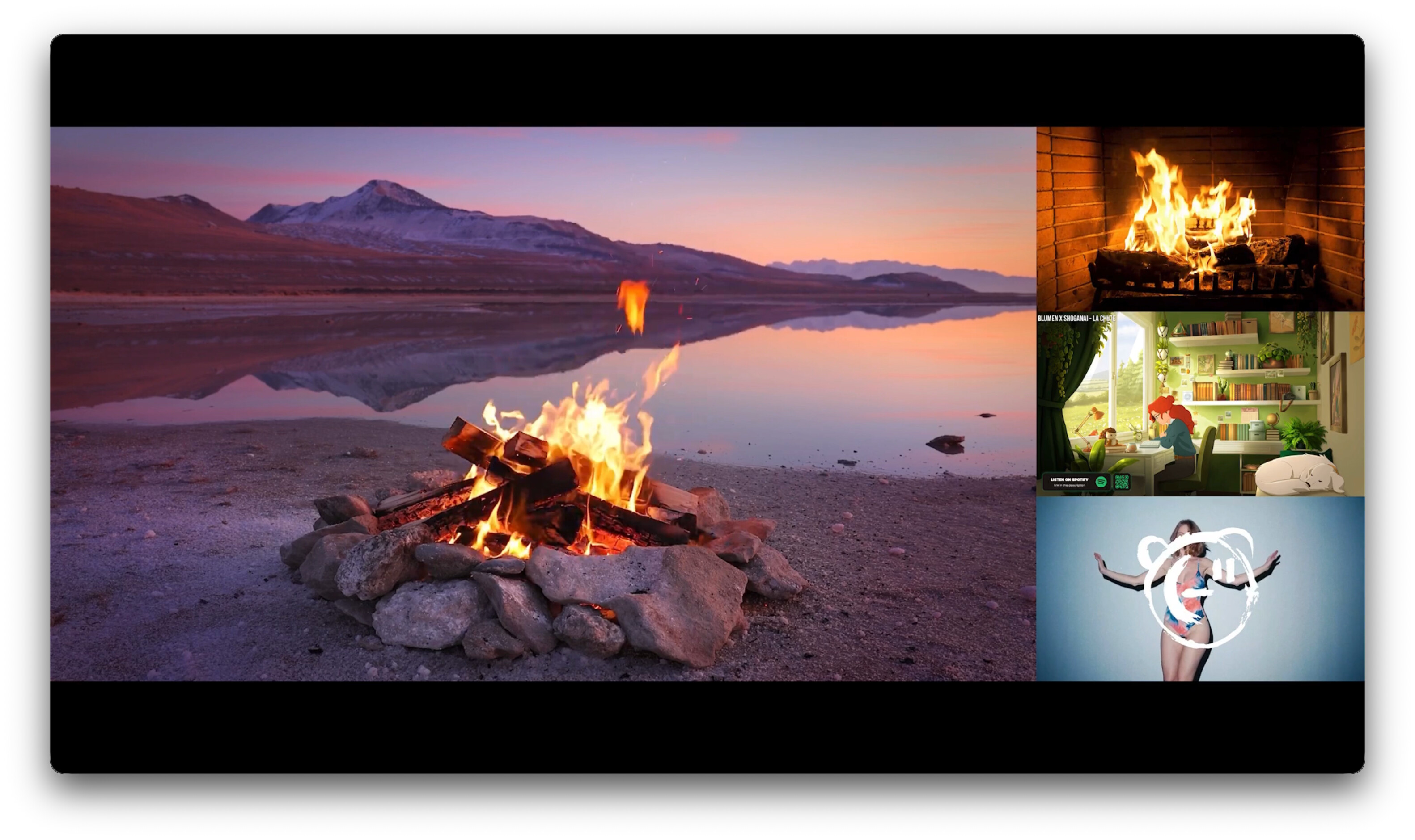

Also happy to see these channels work brilliantly as Multiview ingredients:
I imagine this coming in handy for next year’s Coachella with multiple live streams, or F1 races where they have multiple streams with different camera angles playing at once.

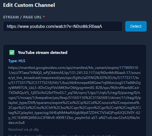

I've been gone for a bit, but I would have given you a warning about YouTube: for non-logged in users (and sometimes logged in ones) it can respond with a "check if you are a human" request. More so, it's something they are increasing the use of, so there is no guarantee how long this approach will work, or how consistently. yt-dlp, and thus PLM Streaming Stations has a built-in workaround to handle this, so if you want to continue supporting YouTube, Twitch, and other similar streaming sites, it's something you'd probably want to look into!
This ?
