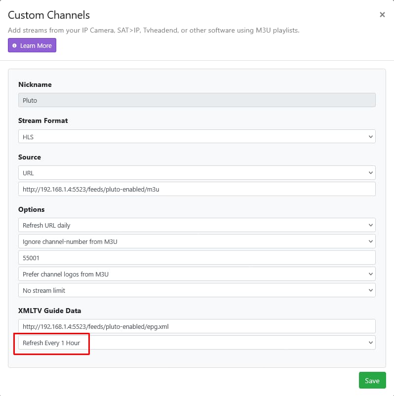

Do you have every source that uses XMLTV Guide Data refreshing every hour?
If not, some will only refresh once per day during the morning guide refresh.

Yep, have it set to every hour, only occurs on certain channels/sources, Hallmark being one and Pluto channels that appear to not having a Gracenote match. But when it does happen, I have to go through the whole process of re scraping and re adding to channels to get it back.

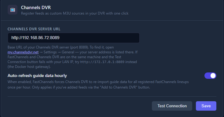

i think try what @chDVRuser suggested.. OR, even better-- if you have this setup properly, FastChannels will automatically refresh your feeds in CDVR using their API (assuming you used the auto Add to Channels DVR button from feeds).
For all Channels DVR sources that uses XMLTV Guide Data ?
Yes Sir, I went through that a few weeks back, have them all set for 1 hour, and the FastChannel settings is on auto-refresh guide data hourly. I do have all my sources set for 120 minutes for the scrape schedule on FC.

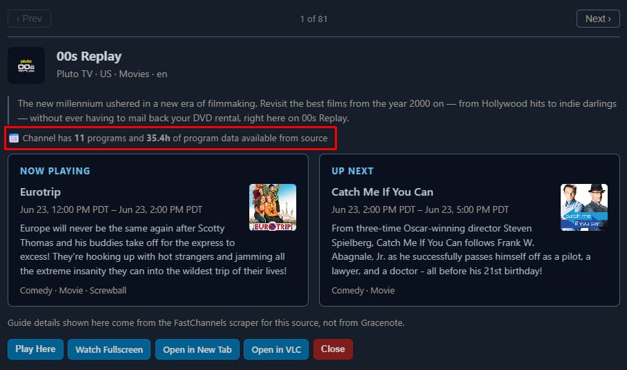

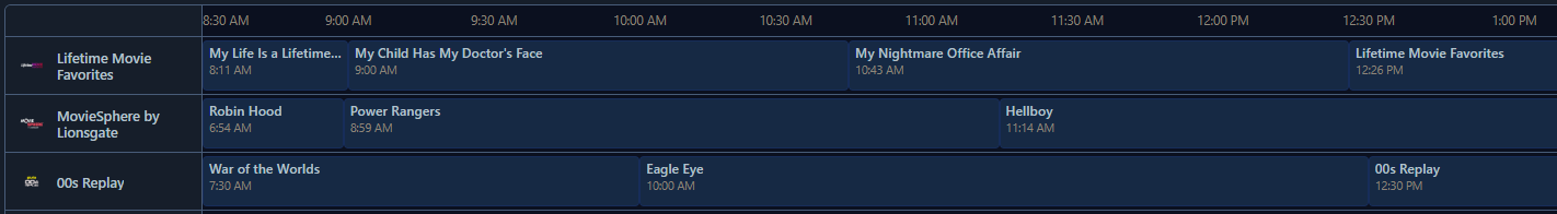

Click on the channel name in FastChannels
to see how much guide data it has scraped for it. I think it's including the listing 00s Replay tomorrow at 12:30 PM, listed as 11 hrs 30 min duration in its calculation of 35.4 hrs

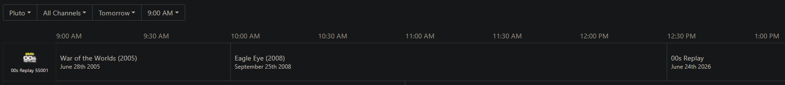

For that channel it shows listings to 10am tomorrow in Channels DVR
Guide tab in FastChannels shows the same
So I know mine are in sync.
Yea I checked one problem channel, it showed 22.8 hours of programs, and appears to end on my channels guide at 10am WED, just not sure why it gets out of sync, and just stops providing after a day or two and then I have to scrape and re add to get back to displaying. Thanks, didn’t know I could do a deep dive with FC for some clarity, but I still puzzled. :thinking:

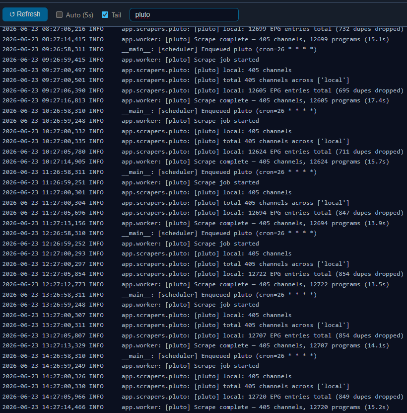

Have you looked at the logs for CDVR and FC to see if guide data updates are happening?
In the FC logs, look for "pushed guide refresh".
In the CDVR logs, look for "Fetched guide data".

I see the fetch guide data on the Channels Dvr log, don’t exactly see the pushed guide refresh on FC, will have to relook closely throughout the days…
You can easily see when FC scrapes your sources. Just put the source name in the logs filter

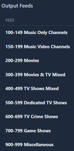

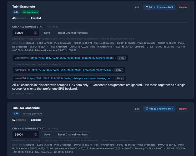

Is this how you guys organize your feeds? I have like 12 feeds.
I don't love it but this is what I have for now.
