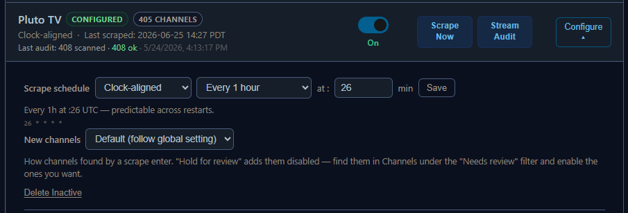

Since he enabled scheduled scraping, I implemented it for my sources to spread the scrapes out
Source            Interval Last Scraped         Next Scrape
Distro TV              60m 2026-06-25 14:11 PDT 2026-06-25 15:10 PDT
Frndly TV            1440m 2026-06-25 05:02 PDT 2026-06-25 17:01 PDT
LG Channels           720m 2026-06-25 14:07 PDT 2026-06-25 15:06 PDT
Local Now              60m 2026-06-25 14:19 PDT 2026-06-25 15:18 PDT
Plex                   60m 2026-06-25 14:24 PDT 2026-06-25 15:22 PDT
Pluto TV               60m 2026-06-25 14:27 PDT 2026-06-25 15:26 PDT
Samsung TV Plus        60m 2026-06-25 14:35 PDT 2026-06-25 15:34 PDT
STIRR                  60m 2026-06-25 14:32 PDT 2026-06-25 15:30 PDT
TCL TV+                60m 2026-06-25 14:42 PDT 2026-06-25 15:38 PDT
The Roku Channel       60m 2026-06-25 14:43 PDT 2026-06-25 15:42 PDT
Tubi TV	               60m 2026-06-25 13:47 PDT 2026-06-25 14:46 PDT
Vidaa Free TV          60m 2026-06-25 13:52 PDT 2026-06-25 14:50 PDT
Vizio WatchFree+       60m 2026-06-25 13:55 PDT 2026-06-25 14:54 PDT
Whale TV+             720m 2026-06-25 03:07 PDT 2026-06-25 15:07 PDT
Xumo Play              60m 2026-06-25 13:59 PDT 2026-06-25 14:58 PDT

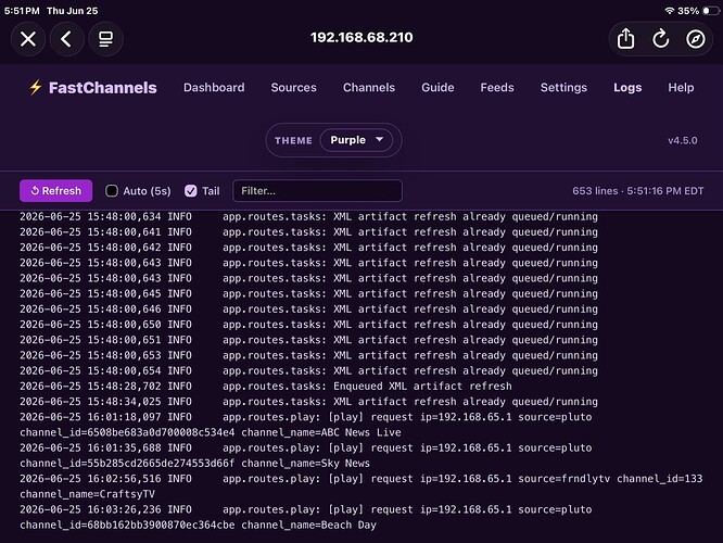

Yeah good plan, unfortunately I even nuked the FC container and database from Portainer and Docker Desktop, re-created my FC through Olivetin and once setup again I only selected few sources (Plex,Pluto,Hallmark) and did my initial scrape and feeds, came back a few hours later and those sources didn’t re-scrape, and logs didn’t show any scraping since initial manual run. I still see the channels and appears to be working on my channels DVR, just will get out of whack in a day or two without the scraping on those few channels.
Check the log to see if it's at least queueing up the scrapes
__main__: [scheduler] Enqueued

Nope no sign of that,just a long run of the “ app.routes.tasks: XML artifact refresh already queued/running”

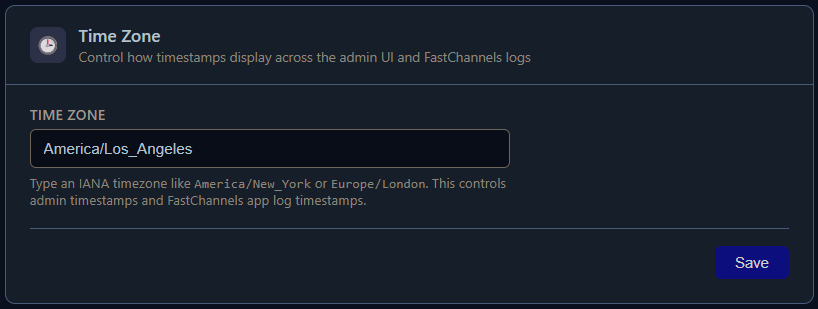

Change this to Continent/City form. Unfortunately, Country/Timezone has been deprecated.
Was just about to mention the same.
Also make sure you have it correct in FC Settings
Thank you Sir, appears to have started scraping, logs are updating… WOW
Thanks… may be all it needed.
Good detective work!
Adding defensive step to that field…
Maybe add a refence URL to look them up, like
which lists them in order by UTC offset, and mention to pick the Canonical – The primary, preferred zone name

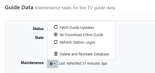

When I add/delete channels, do I need to manually reload the M3U for each feed in Channels to pick up the changes? It doesn't look like Channels has an "update all" command (for the M3Us; there is an update-all for the EPG).
The brute-force way on Channels admin portal is Settings/Live TV & DVR/Guide Data then Delete & Recreate DB. You can also just go to Admin/Sources/then select your Source and hit Reload M3U. But, to ensure everything syncs, use the hammer.
