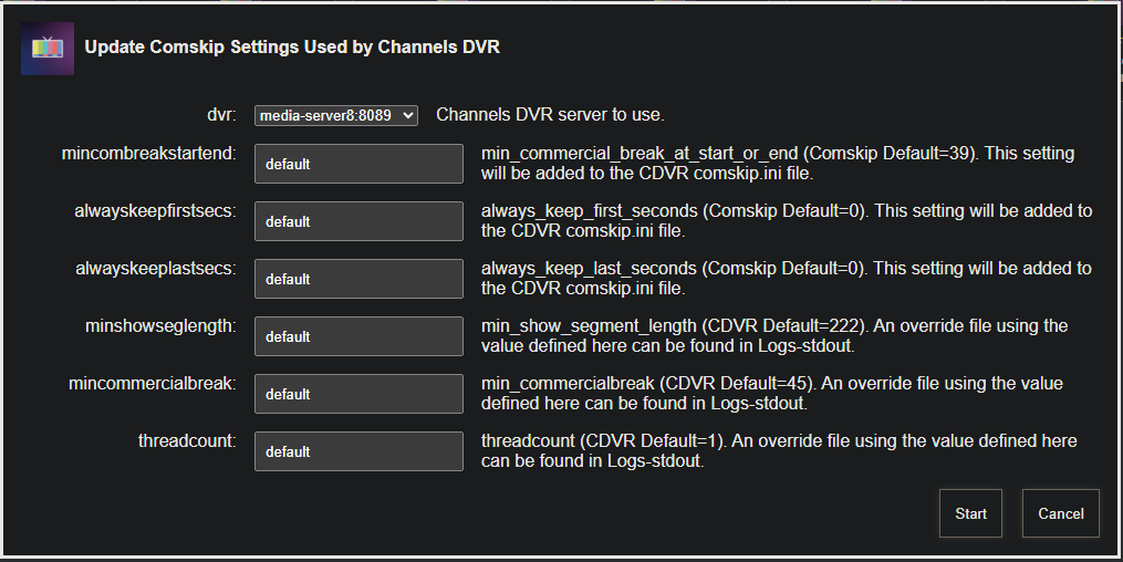

I setup an OliveTin-for-Channels Action to make it easier to adjust a subset of Comskip settings, and the basics (as I recall) are these:
The general Comskip settings used by Channels are not stored in a file, but rather are part of the API. These can be adjusted using OliveTin. Any other settings you want tweak require you to create a comskip.ini override file, and place it in C:\ProgramData\ChannelsDVR\data in the case of Windows.
Here's what the Olive Action looks like:
And the Action's output:
Current CDVR Comskip status:

I can always add additional options to the OliveTin Action, if there are others you'd like to tweak. The nice thing about the Action is that it adjusts settings through the API when possible, and produces an override file when a setting isn't available via the API.
