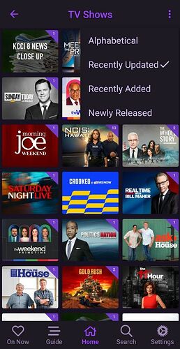

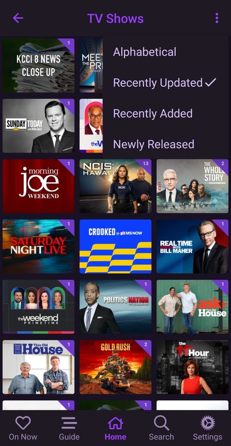

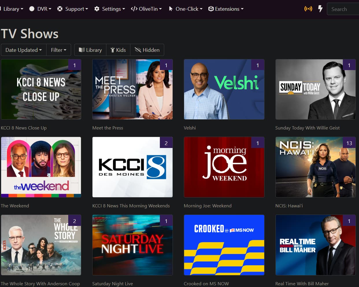

web interface says Date Updated
Android beta app says Recently Updated
I must have a bug in my sorting logic. I have it to sort by date added from the DVR. I have a small library and it is sorting as expected. I need to see a larger library can cause an issue. I will work on that later this week.

"Recently Updated" is working correctly here: I see shows with newest episodes first. I assume you're sorting by File ID? Looks good. I wonder if the size of Shaggylive's library is slowing down the sorting.
My next request would be for the filter selection to persist after we leave and return to TV Shows, or at least put "Recently Updated" at the top of the combobox and make it the default. Right now the sort goes back to the default "A-Z (alphabetical)", which could be another reason it doesn't look right to Shaggylive, although like I said it may just be the library size.
