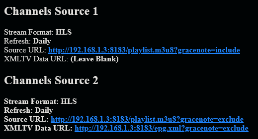

The new WEST channel is in my FRNDLY1 or main FRNDLY source. Using python.
Like deb said, it's included in Source 1
Screenshot 2025-10-19 at 11-38-41

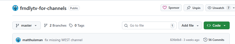

you probably need to update the code to get WEST channel...
Read above (about 3 weeks ago) before posting :slight_smile:
