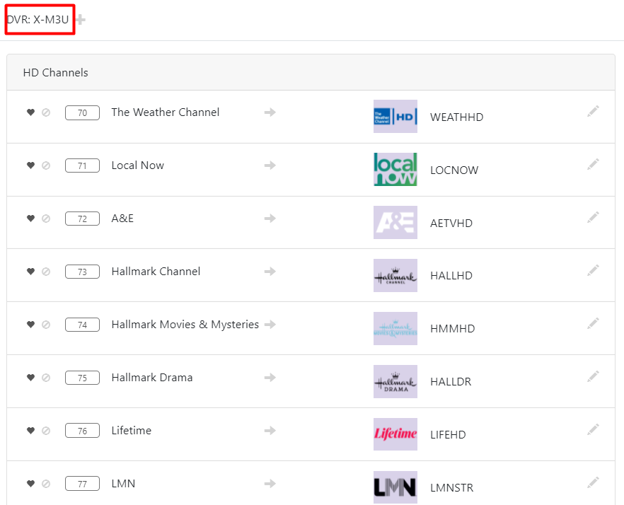

Just like @kennyb3653, I don't have guide data for Curiosity and Dove.
For Curiosity, it's nothing new for me, I never got it to work.
Thank you. I did it but that didn't help with Curiosity and Dove. The rest is fine.
Not a big deal but some logos are missing for me (just a display issue, the guide is fine). Also, why is there "59" in front of the HISTORY logo?
Some logos appear missing but are white and don't show in the listing.
Have an extention in my browser to set background colors on certain parts of Channels settings, viewing shows the white logo.
I think Dove and Curiosity are not actual Live Streams from the networks but, a live stream of videos, the m3u files show no "tvc-guide-stationid="XXXXX" for these channels. Yule Log" same thing but of course there's no need for guide info for that one.
just added the epg id for Dove
If you refresh playlist - it should grab it
