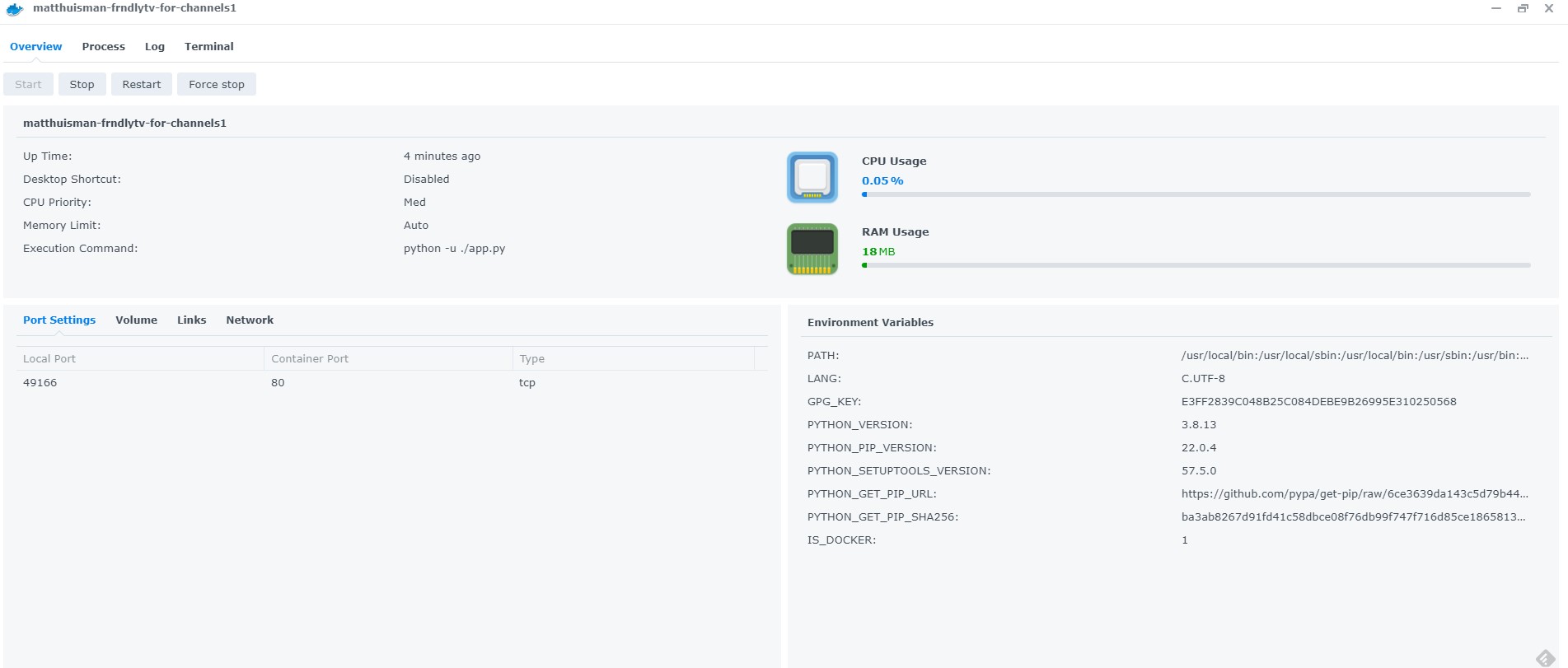

You can also view the container details from the Synology web UI
Docker > Container > Details
This will show the Environment Varialbles, so you can see what USERNAME and PASSWORD it got from the run command.

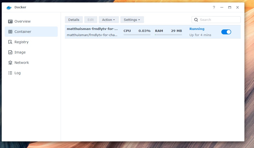

The container is running. There are no special characters in the password. Here is what I am getting: See screenshot.
What do you see at the container page http://192.168.11.224:8183
And did it get the correct username and password?
It doesn't seem to like port 8183. When it does show me what the playlist link is supposed to be it takes me to http://192.168.11.224:49163/. But it stops working after I try to run the command to feed the credentials. The credentials are correct.

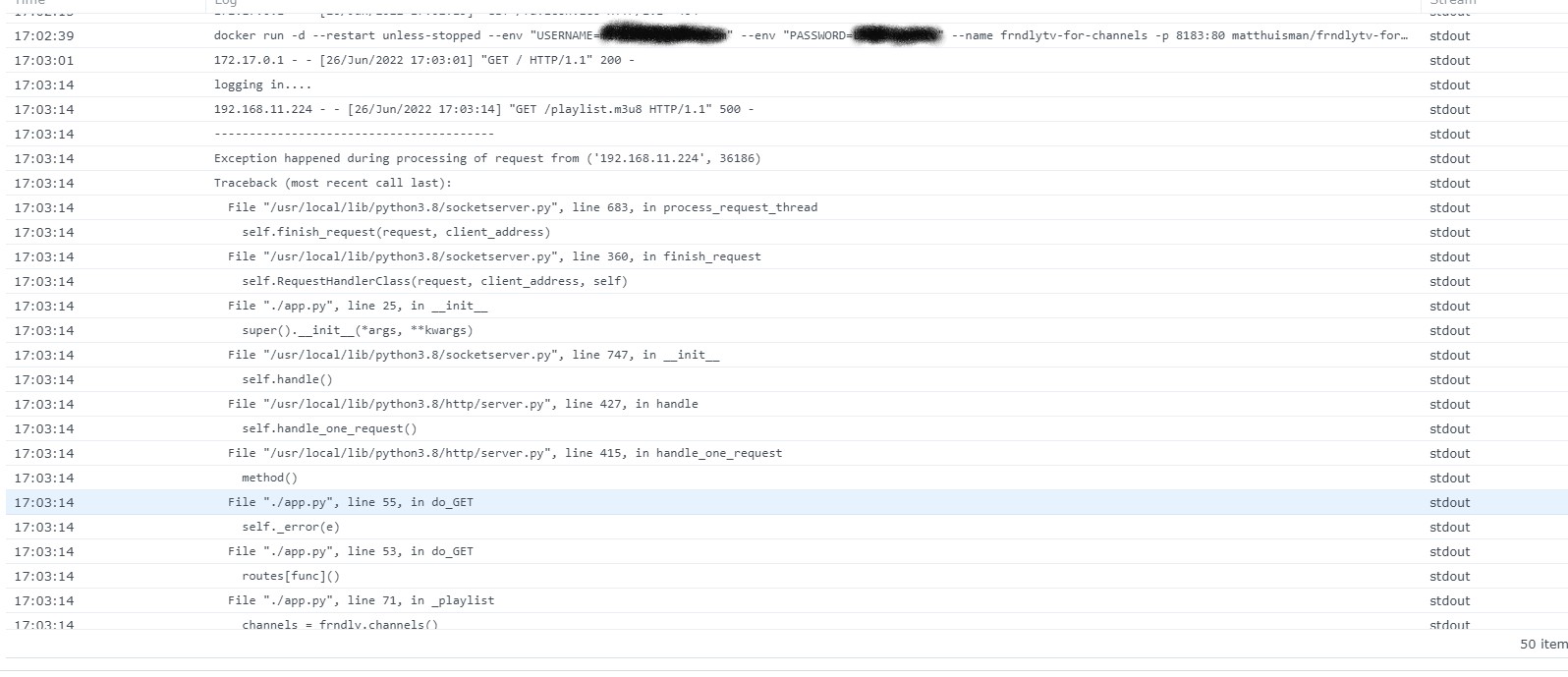

I only have one instance running. This is what the log looks like:
I don't have a status page the local address using port 8183 or port 49156 where it was before. This is what I am running in the command line: "docker run -d --restart unless-stopped --env "USERNAME=-------------------" --env "PASSWORD=---------" --name frndlytv-for-channels -p 8183:80 matthuisman/frndlytv-for-channels"

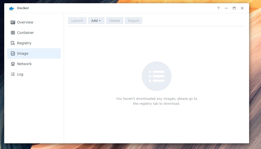

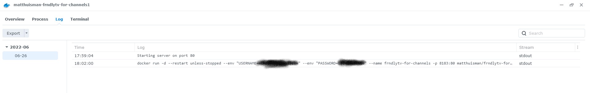

I believe I did as you asked. I deleted everything out of the docker app, image and the container.
I then ssh'ed into the Synolgy nas and got this response:
And it looks like that works and solved all of the issues for the most part.
But the quide isn't quite there. I guess that will fill in as it downloads.
