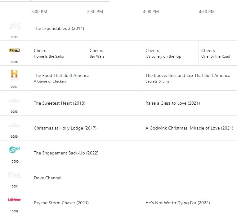

Concerning those four ”special” channels (Dove , Curiosity, Dove Kids and Dove family) that are a pain with the guide. They don’t have gracenotes so they are not covered by the Channels built in .EPG.
In case anyone is curious on how to tidy that issue up a little bit. My setup I actually use 2 Frndly sources. One called Frndly exactly like @chDVRuser uses in their screen shot (except I block those four special channels). No .EPG specified. It’s important you do not add an XMLTV guide link. And do not bother trying to manually map those four channels from manage lineup, the data will be wrong.
Then I have a second source called FrndlyHard2Get with “http://192.168.1.241:8183/playlist.m3u8?include=frndly-38,frndly-49,frndly-16,frndly-50” and I use the docker provided epg.xml. In my case http://192.168.1.241:8183/EPG.xml. Note that using include will exclude everything else. You may also have to go into manage lineup manually map each channel.
Then I combine those two sources into a channel collection containing both sources. The “special” channels will at least have show titles and times but do not have descriptions. But at least you can set individual recordings on those channels.
