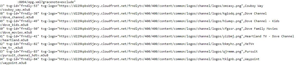

They still appear in the Playlist without include and exclude. The URL's are not mapping correctly to @matthuisman Server.

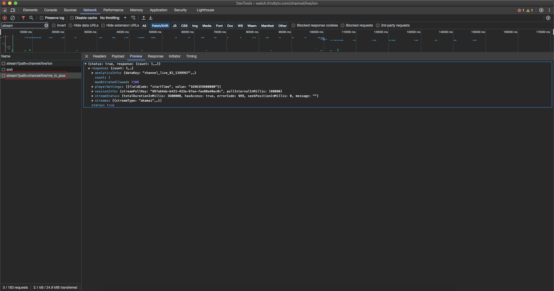

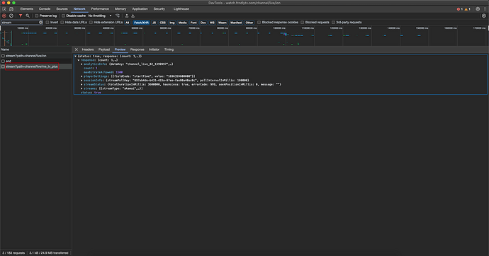

"/play/me_tv_.m3u8" should be "/play/me_tv_plus.m3u8"
It has to be changed on @matthuisman server so the docker container can retrieve the proper URL. I've set up my Frndly Source as text so a manual change will work. Thanks for the heads up on the proper URL. What can you see wrong with the others.
How did you figure out the proper URL. I couldn't figure it out from the Frndly Online Guide.
