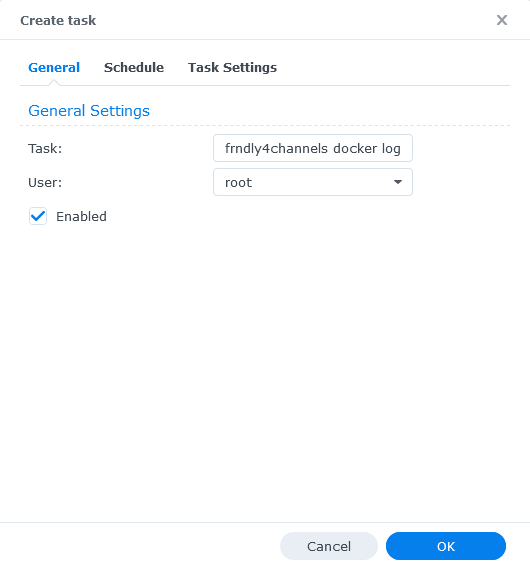

If you want to dump the container log, you can easily do it using the Synology Task Manager.
Create a user defined script as a new scheduled task and schedule it to run once in the past so it doesn't run, except when you choose to manually run it. docker commands need to be run as root, so do this and you can run it anytime you want, and edit it to dump more or less that 2hrs of log data
(--since=2h).
docker logs -t --since=2h frndlytv-for-channels >>/volume1/arkives/frndlycontainer.log 2>&1
