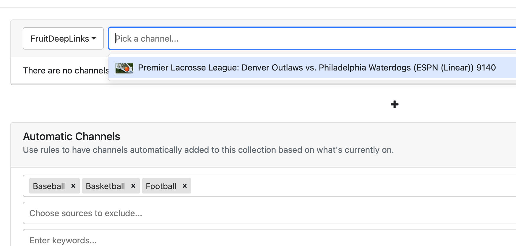

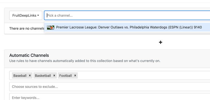

Day one it worked great. Now I get a blank on the channels guide....
If I go to Channels Collections -- I can add ESPN games ....but my automatic find doesn't work.

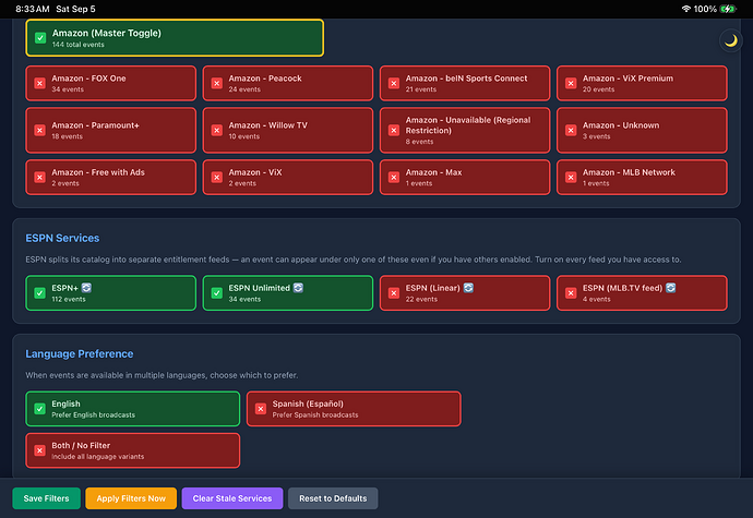

Any hint on where I should look? I just did another refresh......and I only have ESPN+, Paramount+, and Peacock.
So, if you look at the EPG for individual FDL sources in the WebUI, do you see events?
Is it only your Channel Collection that's not working?

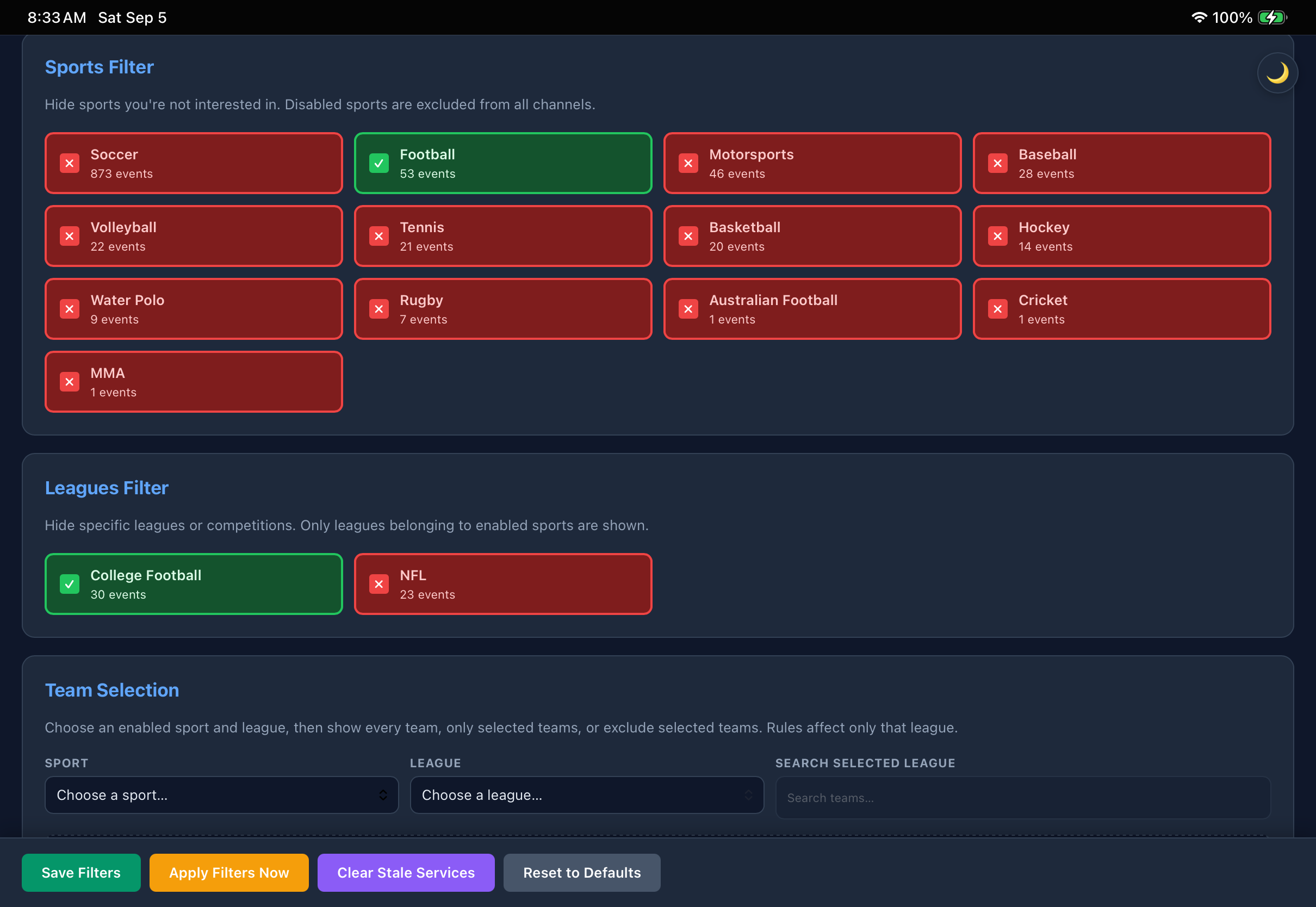

Yesterday I did a refresh and now it works again. It seems I lose it after a few days. Today it is showing a lacrosse event (I excluded all but football and baseball) but that's OK.....
But no football today

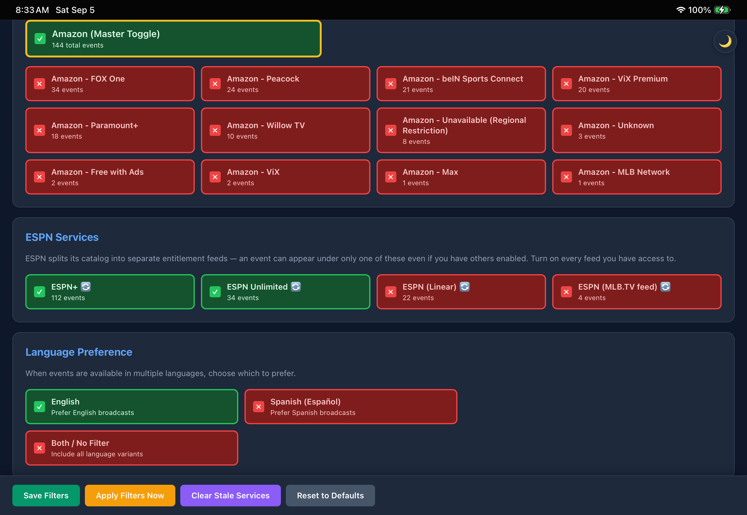

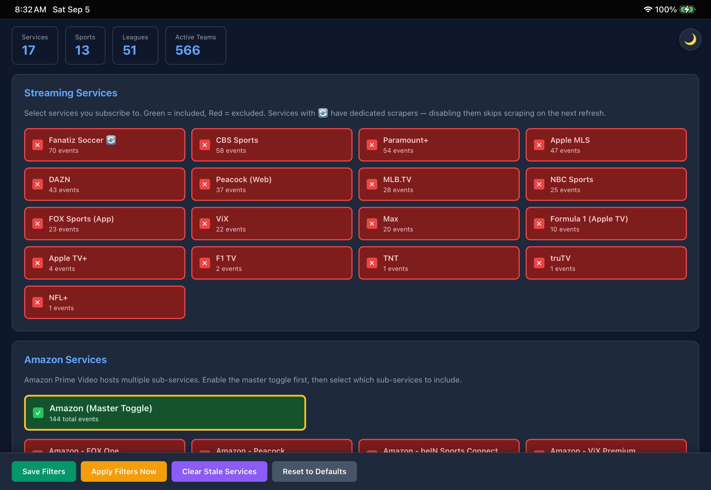

There are several different ways to configure FDL:
You can use streamlinks, so events show in your CDVR EPG, but will open the event in another app (live viewing only, no recording).
You can use ADBTuner, so events will be tuned on a streaming stick, and captured via an encoder.
Or, you can use PrismCast, to tune events in Chrome, and capture that.
A properly configured FDL will be setup to scrape events you're entitled to through subscriptions, and make those events available in your CDVR EPG.
So, the question is which way have you configured FDL based on the above, and which providers are you trying to use? And, since it sounds like one of them is ESPN, what specific ESPN plan are we talking about?
