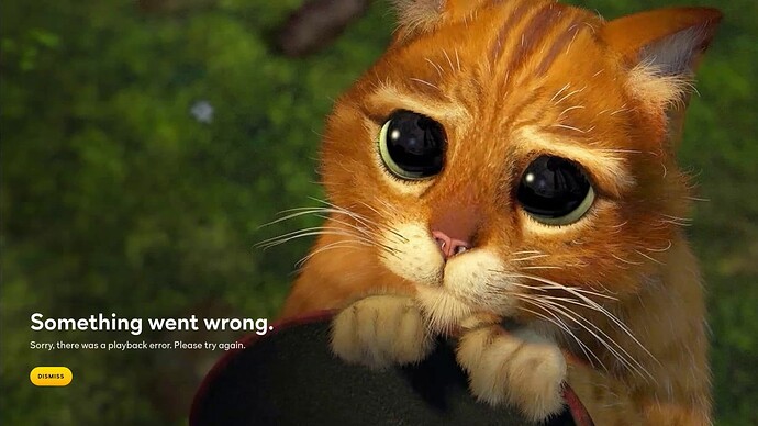

Not too sure why this is happening as Peacock fail to play back the stream
This started happening for me during live events in the last day or so while using the app directly. I have an ad-blocker running so I assume that they added a new required URL that needs to be whitelisted.
i havent changed anything specifically to Peacock... see if you can working URL and compare it to the scraped one.
