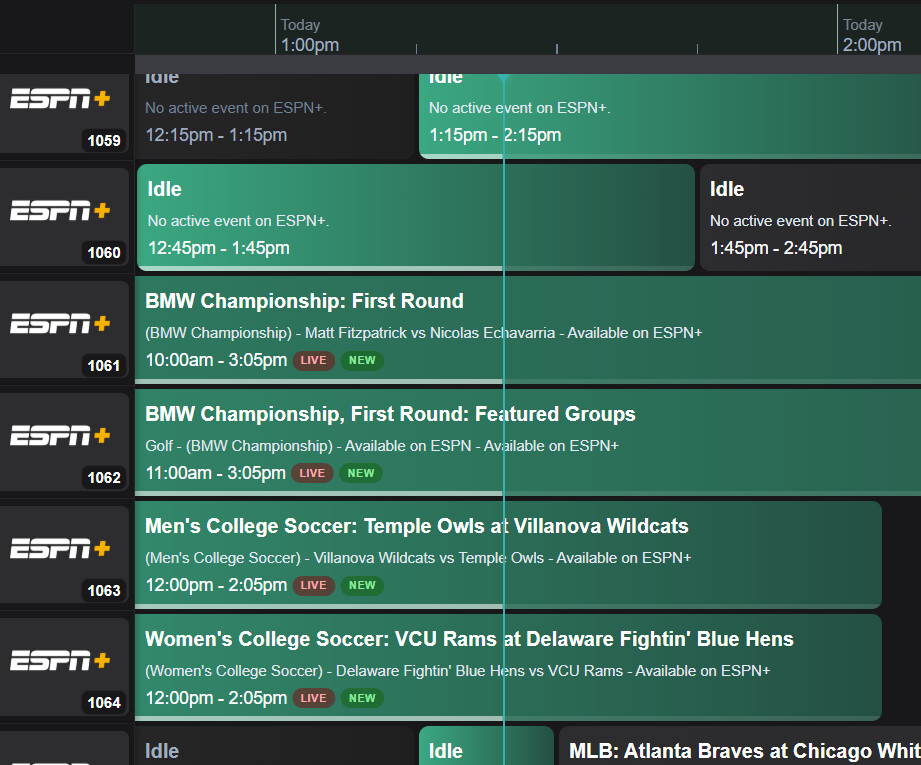

I have 350 lanes set for ADBTuner with FDL and all I pick are ESPN+ college events. It doesn’t hurt to have extra lanes available for when you need then.
dang you love some live sports! (me too)

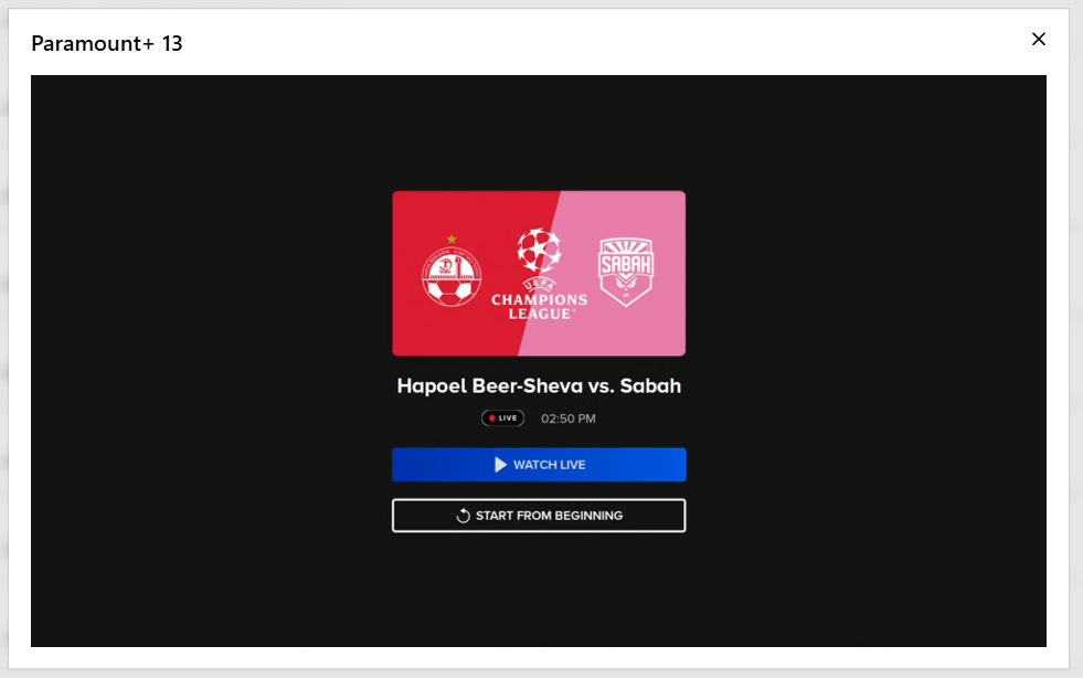

Setup the lanes and dispatcharr. Everything is populating as expected. However, noticed with Paramount+, I'm stopped at this prompt.

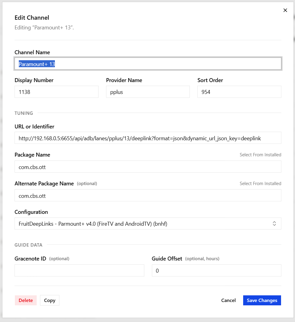

And here's the config within ADBTuner:

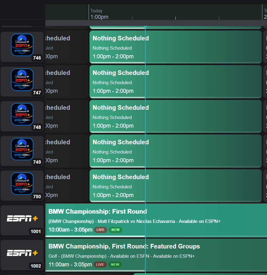

ESPN+ seems to be working with the limited content I have to watch right now.
For Amazon Prime, nothing is showing as available to watch ATM.

The current one looks like this:
    "name": "FruitDeepLinks - Parmount+ v4.0 (FireTV and AndroidTV)",
    "author": "bnhf",
    "version": "4.0",
    "description": "Paramount+ for FruitDeepLinks. Compatible with FireTV and AndroidTV devices.",
    "uuid": "62a01c95-94f8-41b7-b56b-4838859ab42d",
    "global_options": {
        "wait_for_video_playback_detection": false,
        "use_fixed_delay": true,
        "fixed_delay_seconds": 5,
    "pre_tune_commands": [
        "am force-stop ||TARGET_PACKAGE_NAME||"
    "tune_commands": [
        "am start -W -a android.intent.action.VIEW -d '||TARGET_URL_OR_IDENTIFIER||' '||TARGET_PACKAGE_NAME||'"
    "tune_match_text_commands": [
            "match_text": [
                "who's watching",
                "edit profiles"
            "commands": [
                "input keyevent KEYCODE_DPAD_CENTER"
            "check_after_seconds": 5
    "post_tune_commands": [
        "input keyevent KEYCODE_HOME",
Try adding "watch live" to the "match text" section, like this:
            "match_text": [
                "who's watching",
                "edit profiles",
                "watch live"
and report back. If this works in multiple tests on your end, we'll update the config as used in Project One-Click, so all will benefit. :slight_smile:
Added the extra command and appears to be working. 2 different channels worked.

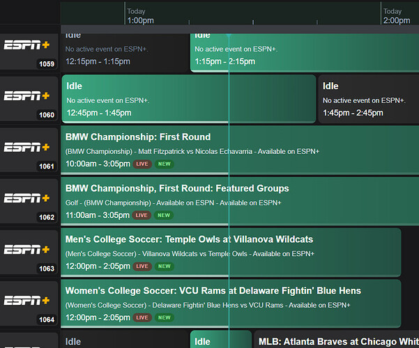

I'm clicking both of these golf events:

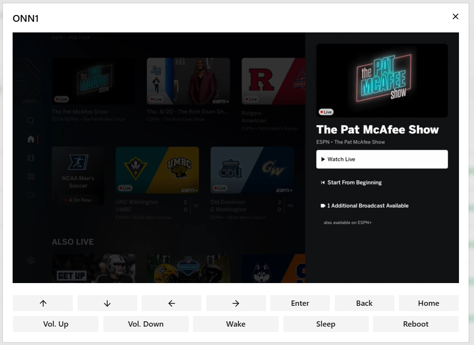

and it's taking me to this:
To add insult to injury, it's not showing the live version of Pat M show, just the option to watch live (which BTW, I don't pull in ESPN Linear content into).
So, 2 issues: 1) Wrong program is being selected; and 2) not showing live but prompt only.

In addition to the above, I'm seeing the same channels 1 & 2 also down in the 60s. The soccer games are tuning fine, it seems to be golf for some reason going to the Pat M show.
It does appear the event link is wrong for this golf event.
One of the side effects of going "live" by sending adb keycodes is that if the event ID doesn't work the keycodes get sent to the ESPN home screen. That results in a couple of DPAD moves and a select -- which in this case is the Pat McAfee show -- so don't get thrown by this bit of side noise.
The real issue is the event link, which you might want to dig into in the FDL interface, and see if you can figure out what's happening. @KineticMan will, I'm sure be happy to fix anything type of failure that can be identified and replicated. I've even been known to fix something here or there in this project. :slight_smile:

I am pulling into DISPATCHARR through the ADBTuner M3U and it was set for 24 hour refresh. I just updated to 1 hour refresh and rescanned. It's now trying to launch the correct content now I believe.
Still takes me to a Watch Live option, but when I tune to college soccer matches, it launches straight into the content.
sportscenter://x-callback-url/showWatchStream?playID=be1ae299-7cf3-4ab2-9b8e-ae8262fefee4
Confirmed bug .. Looking deeper at the raw JSON, there's still no clue on what ESPN playable we pick. Apple doesn't provide what ESPN playable it is -- linear, espn3, mlb, espn unlimited, etc.. BUT, I have a secondary step where I hit espn-graph API to upgrade the playable. Looking at the raw ESPN playable API, it does show what sub-service of espn it is.
I'm going to wire in that sub-service classification. Similar to how Amazon works - you guys will be able to select which ESPN service you want to prioritize.
I believe that's because it was selecting the ESPN Linear feed - not the ESPN+ feed. I don't think there's any fix available for linear feed to auto-play, but the ESPN+ feeds do auto-play (like the college soccer).
