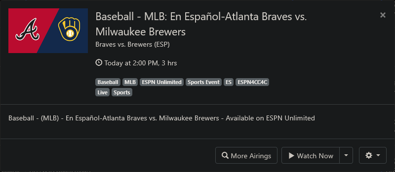

We're getting closer with ESPN+ and MLB but now it's trying to get the Spanish feed for the Braves game which starts at 4 PM ET. This is the only Unlimited event in the inspector.

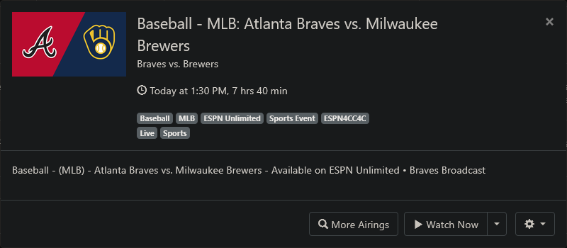

I had the default 'prefer English'' in languages.
It did not pick up the English broadcast which just started at 3:30, here is the JSON:

      "hexColor": "#EF4135",
      "id": "tvs.sbd.30061",
      "images": {
        "appIcon": {
          "height": 768,
          "supportsLayeredImage": true,
          "url": "https://is1-ssl.mzstatic.com/image/thumb/Purple211/v4/fe/b6/02/feb6025c-a23d-885c-6a90-0b56bb9cf6ef/App_Icon_-_Small-marketing.lsr/{w}x{h}.{f}",
          "width": 1280
        "logoGlyph": {
          "height": 58,
          "supportsLayeredImage": false,
          "url": "https://is1-ssl.mzstatic.com/image/thumb/UETqn_AmS3bWeVD1uzaDXA/{w}x{h}.{f}",
          "width": 110
        "squareColorLogo": {
          "height": 2963,
          "url": "https://is1-ssl.mzstatic.com/image/thumb/55bIoUyMmJKUAs6qbfcA-g/{w}x{h}SWL.TVARHBL1.{f}?bColor=EF4135",
          "width": 2963
        "whiteLogo": {
          "height": 742,
          "url": "https://is1-ssl.mzstatic.com/image/thumb/TFnNkhwyYGtAJ2k_ynBZgw/{w}x{h}.{f}",
          "width": 3000
      "isApSubscription": false,
      "isAppleMusicImmersiveBrand": false,
      "isAppleTvPlus": false,
      "isConsented": false,
      "isFirstParty": false,
      "isInstalled": false,
      "isItunes": false,
      "isMountainBrand": false,
      "isStaging": false,
      "isSubscribed": false,
      "isTvAppBrand": false,
      "isWatchlistEnabled": true,
      "minWatchlistAppVersion": "6.4.0",
      "name": "ESPN",
      "shouldTrackPlayActivity": true,
      "title": "ESPN",
      "type": "Brand",
      "url": "https://tv.apple.com/us/channel/espn/tvs.sbd.30061"
  "playables": {
    "tvs.sbd.30061:ed1c28e4-218f-40d7-8c7d-eb482e67172e:0399be96": {
      "airingType": "Live",
      "canonicalId": "umc.cse.4cxkorq1qjkaec882x8xwpyhk",
      "canonicalMetadata": {
        "images": {
          "contentImage": {
            "height": 2160,
            "joeColor": "b:rgb(194,194,194) p:rgb(4,4,4) s:rgb(46,46,46) t:rgb(42,42,42) q:rgb(75,75,75)",
            "url": "https://is1-ssl.mzstatic.com/image/thumb/AjA7BX8DVYT-GCUwBCUOFA/{w}x{h}Sports.TVAPrM04.{f}?colorRight=13294B&rtl=false&colorLeft=0C2340&imgEffectLogoRight=PZ4dwVFcbaS8Mj0vyH8Eig",
            "width": 3840
          "posterImageLive": {
            "height": 2160,
            "joeColor": "b:rgb(30,26,21) p:rgb(195,194,194) s:rgb(222,178,139) t:rgb(162,160,159) q:rgb(184,148,116)",
            "url": "https://is1-ssl.mzstatic.com/image/thumb/ECMvGCdAV2s6FMrm1SW3Ug/{w}x{h}sr.{f}",
            "width": 3840
          "posterImagePost": {
            "height": 2160,
            "url": "https://is1-ssl.mzstatic.com/image/thumb/gen/{w}x{h}Sports.TVAPoM02.{f}?imgEffectLogoLeft=AjA7BX8DVYT-GCUwBCUOFA&imgBG=PEErbWbZQW1_IuIP7hgXlA&rtl=false&imgEffectLogoRight=PZ4dwVFcbaS8Mj0vyH8Eig",
            "width": 3840
        "leagueId": "umc.csl.50vezwb1n14iqvdgtxwcpo2z1",
        "leagueName": "MLB",
        "leagueShortName": "MLB",
        "shortTitle": "Braves at Brewers",
        "sportName": "Baseball",
        "venueAddr": "Milwaukee, Wisconsin, United States",
        "venueName": "American Family Field"
      "channelId": "tvs.sbd.30061",
      "contentId": "umc.cmr.espn.sp.6p35zto4kjm2do5prh349ict1",
      "contentType": "SportingEvent",
      "entitlementReason": "Unknown",
      "eventTime": {
        "gameKickOffStartTime": 1787343000000,
        "liveBadgeTime": {
          "endTime": 1787368500000,
          "startTime": 1787340600000
        "playerInfoDisplayTime": {
          "endTime": 1787355000000,
        "playerInfoTransportBarTime": {
        "tuneInTime": {
      "externalId": "ed1c28e4-218f-40d7-8c7d-eb482e67172e",
      "externalServiceId": "com.espn.service.vod.espn_unlimited_events-v2",
      "id": "tvs.sbd.30061:ed1c28e4-218f-40d7-8c7d-eb482e67172e:0399be96",
      "isDownloadable": false,
      "isEligibleForPlayerTabs": true,
      "isEmbargoed": false,
      "isEntitledToPlay": false,
      "isEntitledToPlayOnDevice": false,
      "isGeoRestricted": true,
      "isItunes": false,
      "isKeyPlayAvailable": false,
      "isUpgradeEligible": false,
      "locales": [
          "displayName": "English (United States)",
          "locale": "en_US"
      "makeAdditionalPlayerTabsRequest": false,
      "playablePassThrough": "eyJwbGF5YWJsZUlkIjoidHZzLnNiZC4zMDA2MTplZDFjMjhlNC0yMThmLTQwZDctOGM3ZC1lYjQ4MmU2NzE3MmU6MDM5OWJlOTYifQ==",
      "primaryLocale": {
        "locale": "en_US"
      "punchoutUrls": {
        "open": "sportscenter://x-callback-url/showWatchStream?playID=55097618-cba9-4dc7-95ba-d8fa9e1631fd&x-source=AppleUMC",
        "play": "sportscenter://x-callback-url/showWatchStream?playID=55097618-cba9-4dc7-95ba-d8fa9e1631fd&x-source=AppleUMC"
      "releaseDate": 1787340600000,
      "requiresLocationConsent": false,
      "serviceId": "tvs.vds.1354303",
      "serviceLogo": {
        "height": 800,
        "url": "https://is1-ssl.mzstatic.com/image/thumb/KHkeGQxDJV49shBQAMD4sw/{w}x{h}.{f}",
        "width": 2000
      "serviceName": "ESPN Unlimited",
      "title": "Atlanta Braves vs. Milwaukee Brewers",
      "type": "EbsEvent"
    "tvs.sbd.30061:9b38388e-d504-4c39-881f-6a6e5a2fc802:7d9a8880": {
        "images": {
          "contentImage": {
            "height": 2160,
            "width": 3840
            "height": 2160,
            "width": 3840
            "height": 2160,
            "width": 3840
      "contentId": "umc.cmr.espn.sp.queizo6q2lpt4chstle3lwje",
      "eventTime": {
        "liveBadgeTime": {
          "endTime": 1787353500000,
          "startTime": 1787342400000
          "endTime": 1787356800000,
        "tuneInTime": {
      "externalId": "9b38388e-d504-4c39-881f-6a6e5a2fc802",
      "id": "tvs.sbd.30061:9b38388e-d504-4c39-881f-6a6e5a2fc802:7d9a8880",
      "isItunes": false,
      "locales": [
          "displayName": "Spanish (Mexico)",
          "locale": "es_MX"
      "playablePassThrough": "eyJwbGF5YWJsZUlkIjoidHZzLnNiZC4zMDA2MTo5YjM4Mzg4ZS1kNTA0LTRjMzktODgxZi02YTZlNWEyZmM4MDI6N2Q5YTg4ODAifQ==",
      "primaryLocale": {
        "locale": "es_MX"
      "punchoutUrls": {
        "open": "sportscenter://x-callback-url/showWatchStream?playID=01d04a46-e75b-4200-93ba-929fedf2c43a&x-source=AppleUMC",
        "play": "sportscenter://x-callback-url/showWatchStream?playID=01d04a46-e75b-4200-93ba-929fedf2c43a&x-source=AppleUMC"
      "releaseDate": 1787342400000,
      "serviceLogo": {
        "height": 800,
        "width": 2000
      "title": "En Español-Atlanta Braves vs. Milwaukee Brewers",
      "type": "EbsEvent"
    "tvs.sbd.30061:cfb36872-0312-4099-a44d-3e334c352e51:0399be96": {
        "images": {
          "contentImage": {
            "height": 2160,
            "width": 3840
            "height": 2160,
            "width": 3840
            "height": 2160,
            "width": 3840
      "contentId": "umc.cmr.espn.sp.3ghzn6039mh0uzp5fj1g8el1h",
      "eventTime": {
        "liveBadgeTime": {
        "tuneInTime": {
      "externalId": "cfb36872-0312-4099-a44d-3e334c352e51",
      "id": "tvs.sbd.30061:cfb36872-0312-4099-a44d-3e334c352e51:0399be96",
      "isItunes": false,
      "locales": [
          "locale": "en_US"
      "playablePassThrough": "eyJwbGF5YWJsZUlkIjoidHZzLnNiZC4zMDA2MTpjZmIzNjg3Mi0wMzEyLTQwOTktYTQ0ZC0zZTMzNGMzNTJlNTE6MDM5OWJlOTYifQ==",
      "primaryLocale": {
        "locale": "en_US"
      "punchoutUrls": {
        "open": "sportscenter://x-callback-url/showWatchStream?playID=35f80c49-ab84-46d6-9076-7a0e17c3c898&x-source=AppleUMC",
        "play": "sportscenter://x-callback-url/showWatchStream?playID=35f80c49-ab84-46d6-9076-7a0e17c3c898&x-source=AppleUMC"
      "serviceLogo": {
        "height": 800,
        "width": 2000
      "type": "EbsEvent"

¡Ay, caramba!
I have a step in there that's supposed to "demote" the Spanish language channels, but somehow this slipped through. will add to the list.
Interestingly, ESPN4cc4c (configured to use ADBTuner) shows five different variants (including the Spanish language feed) for this afternoon's Braves/Brewers game. Either team's broadcast either via ESPN Unlimited or MLB.tv:
Only the Spanish language one has the correct start time, and game duration...
EDIT: It would be great if FDL could also include (and identify) the alternative broadcasts for a given game.
