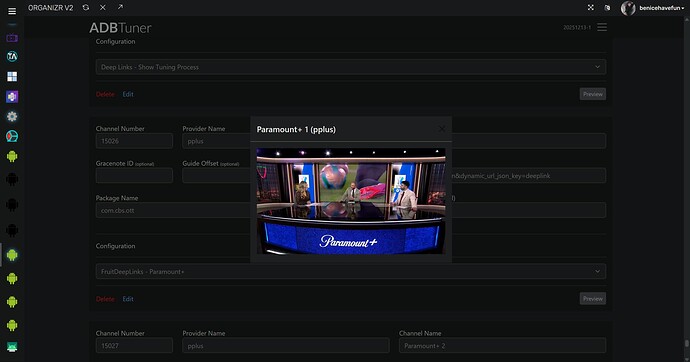

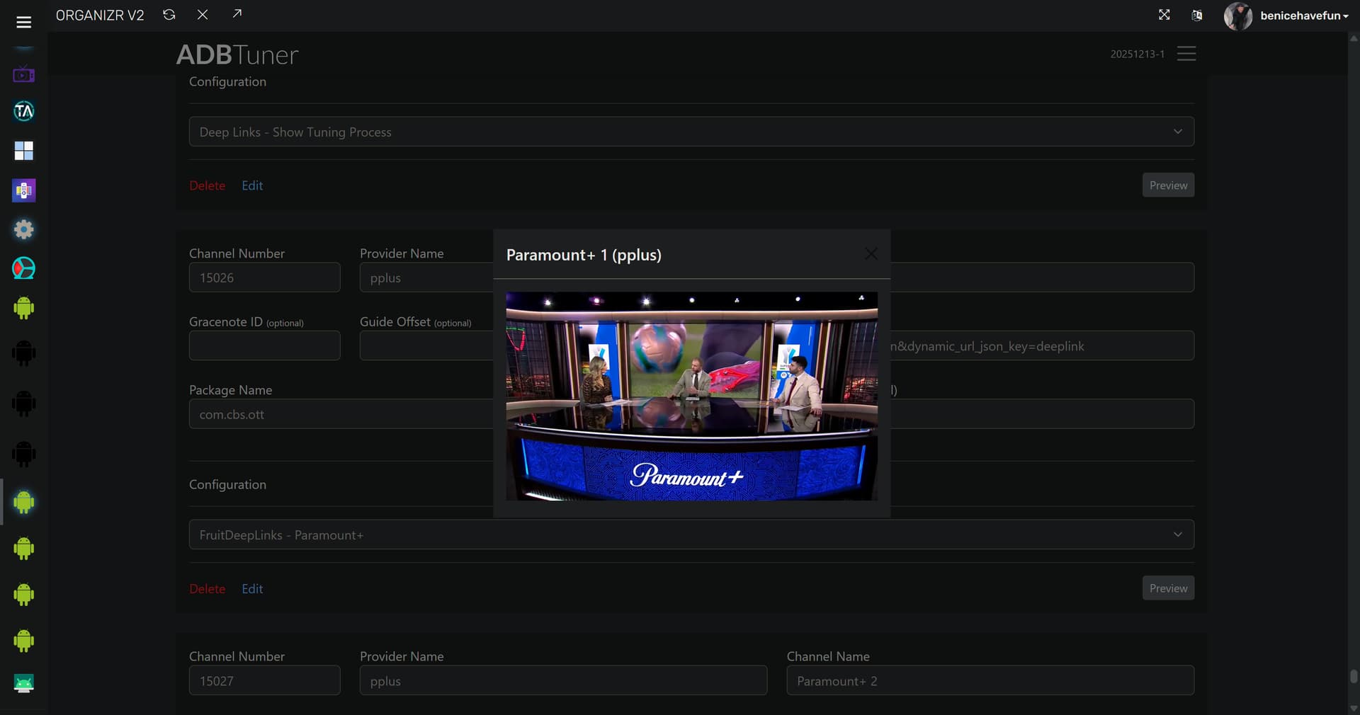

It works for me through doing the preview using the ADBTuner config page as well, but does not work when I actually try to tune the channel through CDVR. I see nothing in the ADBTuner logs when I try to tune the channel through CDVR. I also see nothing on the live logs on fruit dashboard. I tried to check for something strange in my setup of ADBTuner, did a complete manual delete of the source settings and all of the channels in ADBTuner for pplus, then did a reinstall through project one click, and same behavior as before.
How about in the CDVR logs, anything there that might help? I just tested with a FireStick client, instead of through the ADBTuner Preview -- and it worked there for me too:

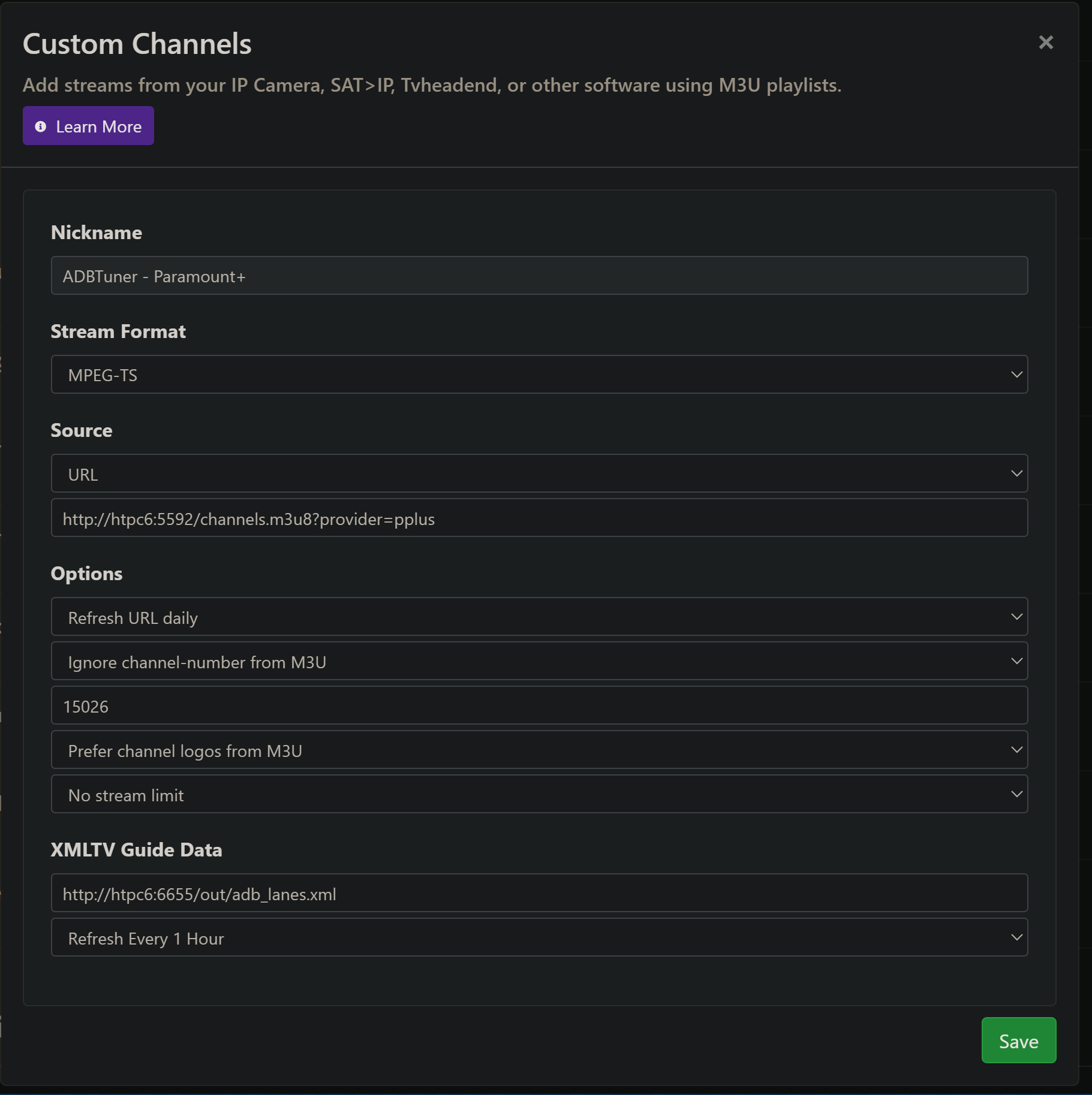

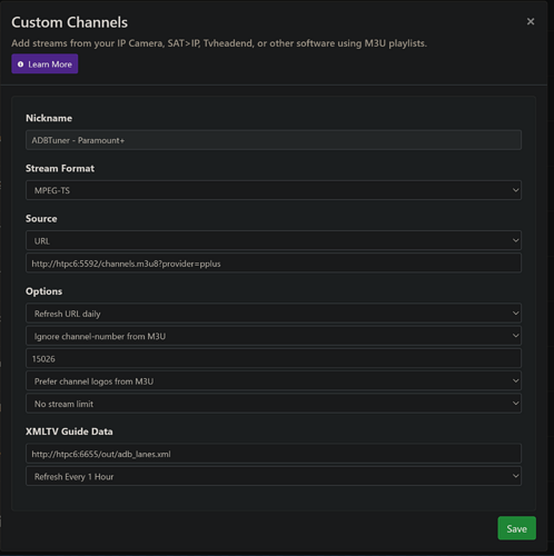

Also, here's what my CDVR Custom Channels setup looks like:

Success! I made my own source settings setup for the Paramount+ channels, and it was able to work on my Apple TV and all. Don't know that there were anything wrong with the way that project one click autogenerated ones were setup, but suspect that maybe things just somehow got corrupted in my CDVR under that particular name. I have been hammering my CDVR server with changes recently, playing around with all of these things to get these fruit channels tested. Probably the universe telling me I need to take a holiday break on all of this as well.
