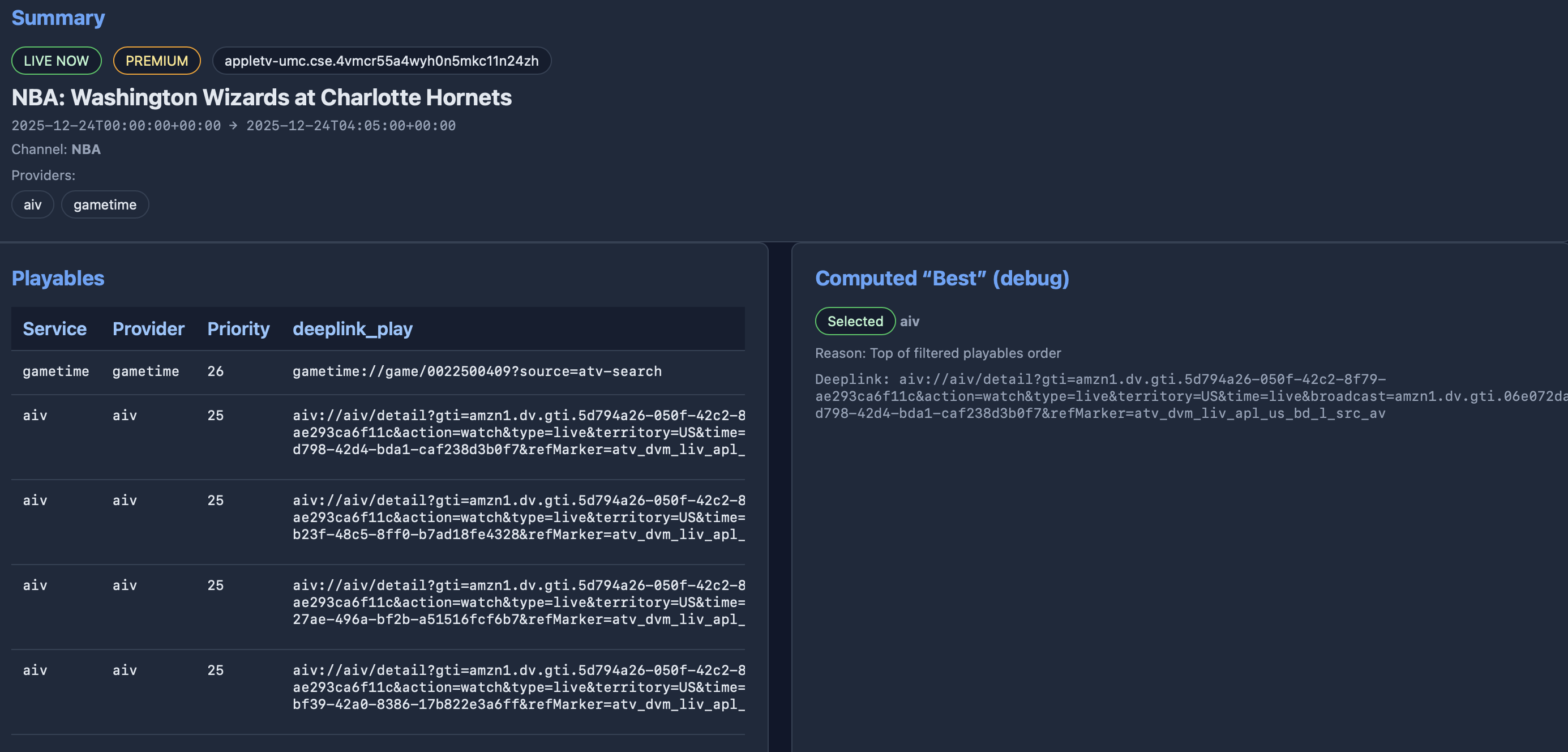

gametime:// is NBA app. Created a test channel in ADBTuner using gametime:// link found in image here.
First test only opened NBA app. Then scrubbed query string linking it to atv and it opened app, and set it to the event page of the game.
So deeplink that worked for this event looks like this: gametime://game/0022500409
So this looks like it should work. Maybe scrubbing the query string relating it to ATV for deep links that will be used outside of ATV is a good thing in general.

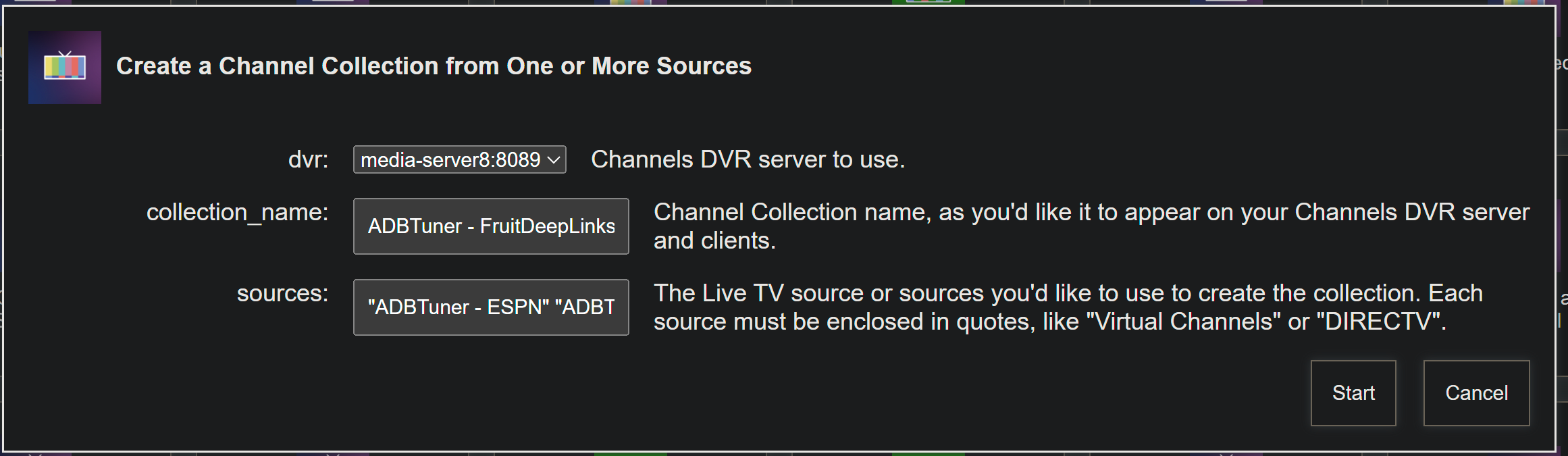

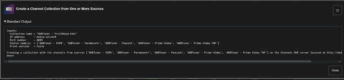

Just a little reminder for those that would like to combine one or more of their ADBTuner FruitDeepLinks sources into a single CDVR Channel Collection:
There's an OliveTin-for-Channels Action for that!
Contrary to this example, a shorter collection name actually looks better in the guide on a CDVR client. So, something like ADBFruit is recommended.
Name your collection, and add as many sources as you like, space-separated and enclosed in double quotes -- and a Channel Collection will be created.
