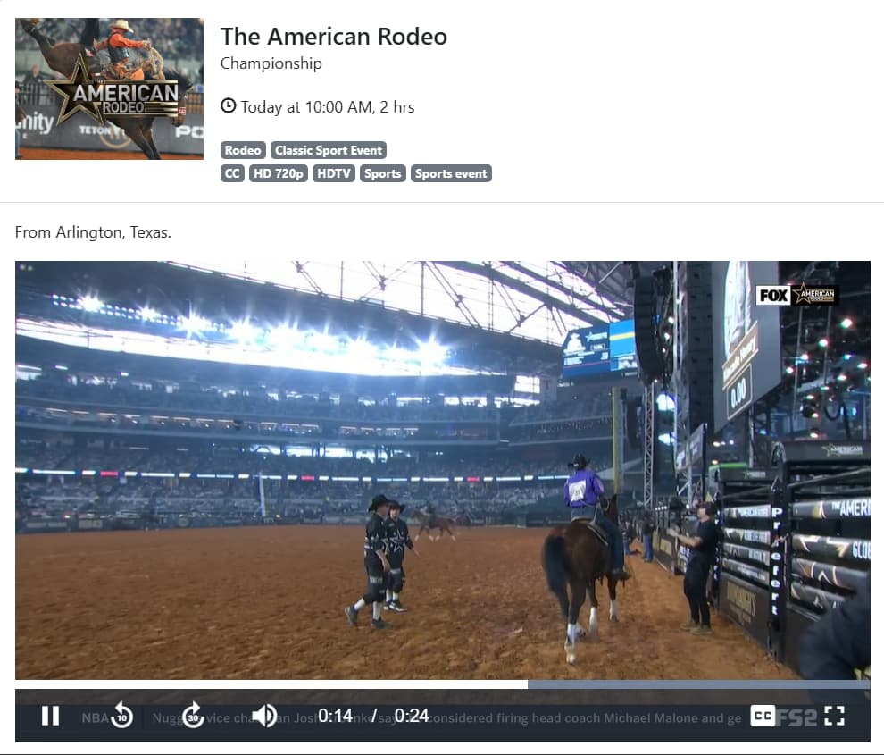

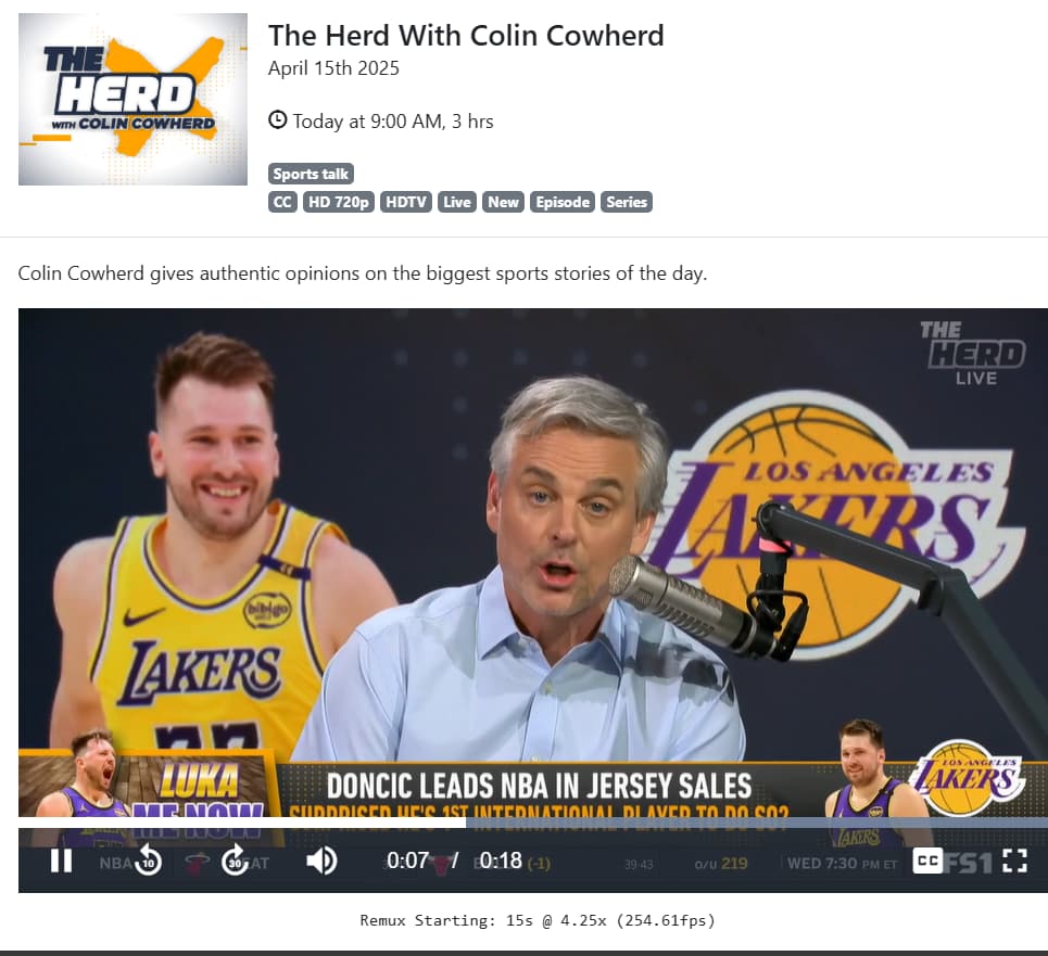

Looking good so far, updated to latest prerelease and did about half a dozen FS1 and 2 lives and all of them succeeded. This didn't happen before.
I've tried them a few times since updating and all 3 worked every time here. Thanks
