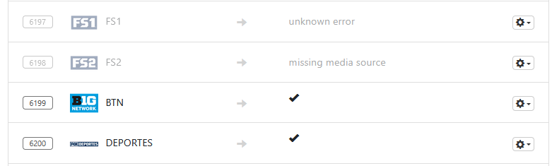

FS1 and 2 gone
I am also getting this today (was working at least as of Sunday night) on Cox.
It doesn't appear to be producing an error image to share, though.

Ya B1G, FS1, and FS2 have been super hit and miss lately. Will not work one minute then work 30 minutes later. Super odd.
Browsing to the FS1, FS2 and BigTen website in a browser on a PC in the same network seems to allow me to watch live at the same time Channels DVR is not able to authenticate. What can we do to help the developers resolve this?
I submitted logs this morning for these issues. I have both DTV Stream & Spectrum as sources. I could not watch FS1 - even though it scanned with no error. FS2 & BigTen both had errors when re-scanning.
I had a program set to record on BigTen @ noon and I scanned the channel @ 11:59 to check it - which failed. I assumed it would just fail to record when it was noon. I was surprised when it actually did record.
Plus now - I can get FS1 & BigTen - but not FS2.
Very weird..
