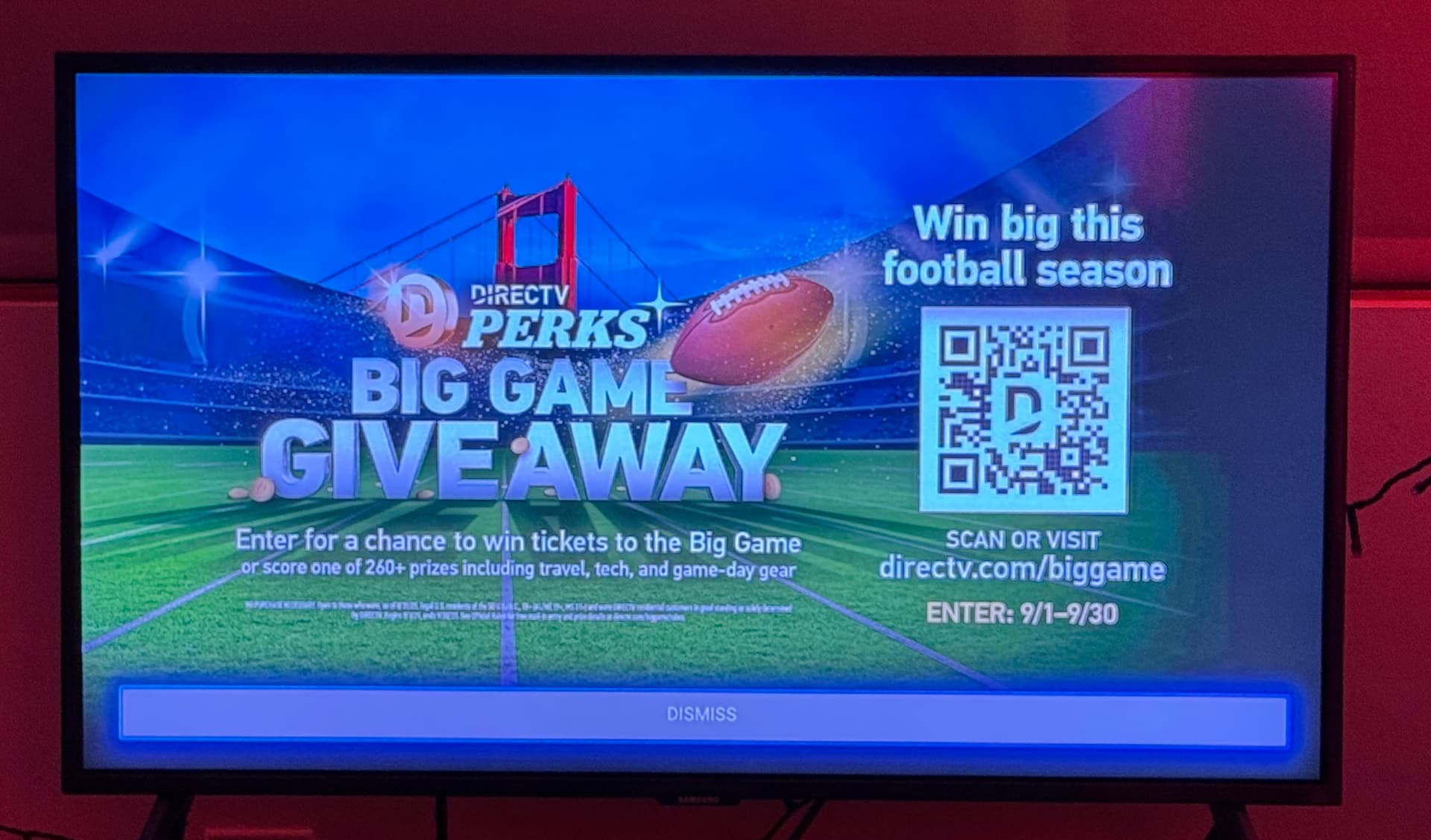

I went to watch one of my ah4c channels, and it wouldn't change the channel at first because it was stuck on this window. I had to go get the remote. Is this a popup or an add? Is this just something we have to watch out for with when using an Osprey box?
Those ads are a pain, fortunately they don't happen too often. Having e-mail alerts set up, to notify you of failed tunes, helps some -- as at least you don't end-up with multiple failed recordings that way.

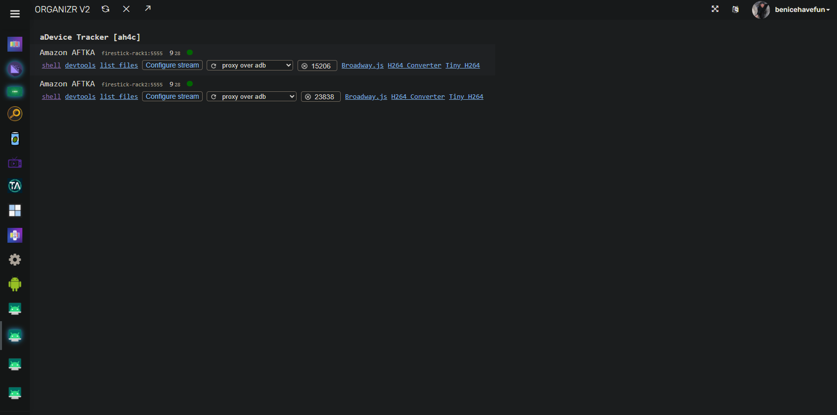

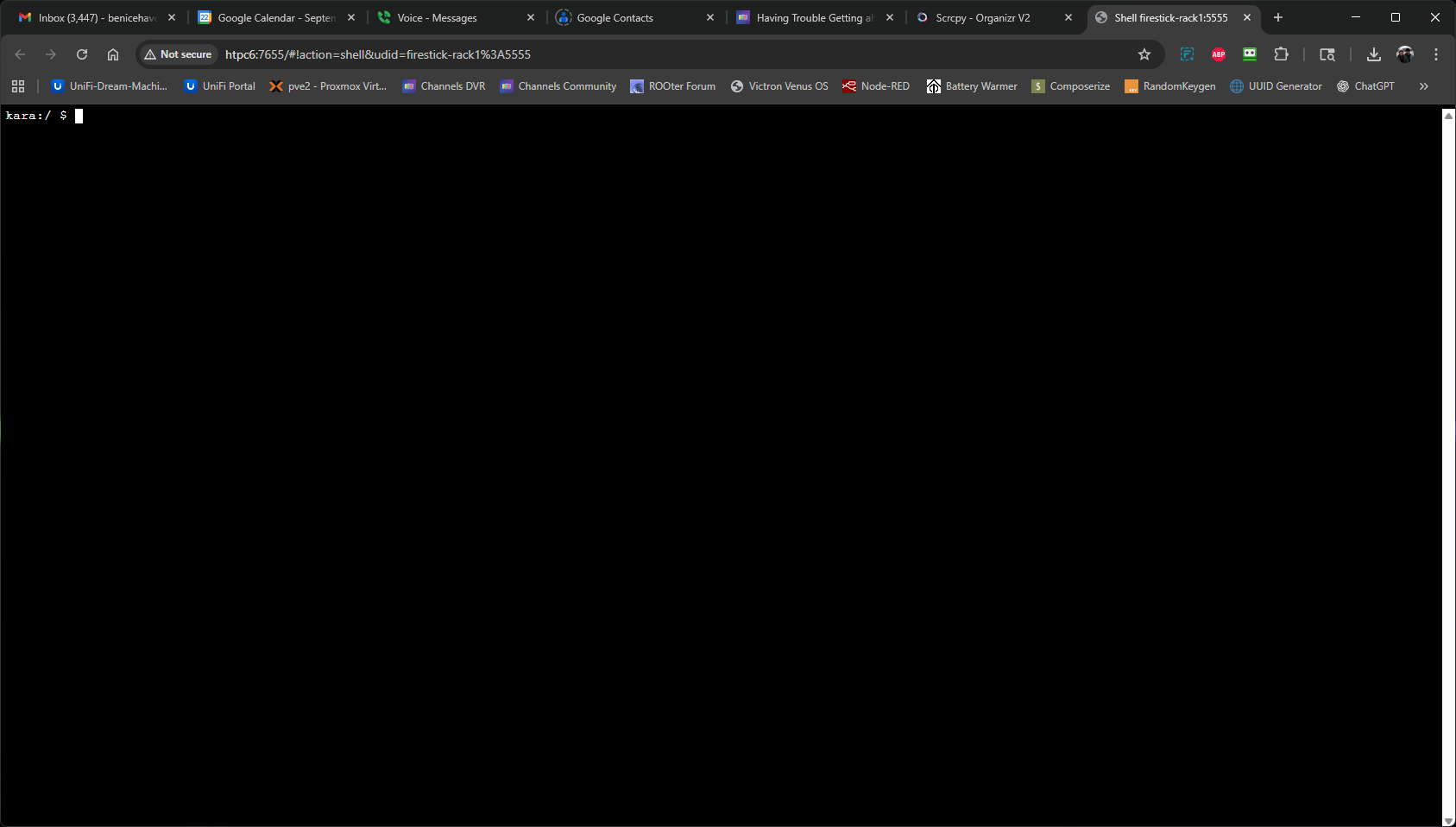

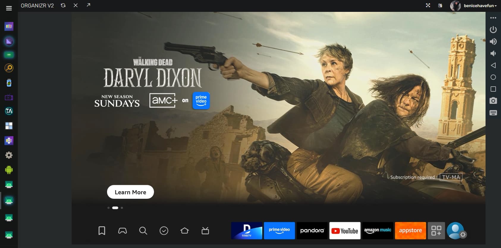

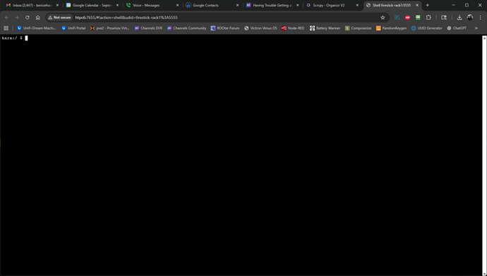

Also, I sometimes think I'm the only one that uses the built-in ws-scrcpy, but I find it very useful to be able to connect up to my sticks (from anywhere) to do whatever. You can either use an adb shell, or interact with the UI:
