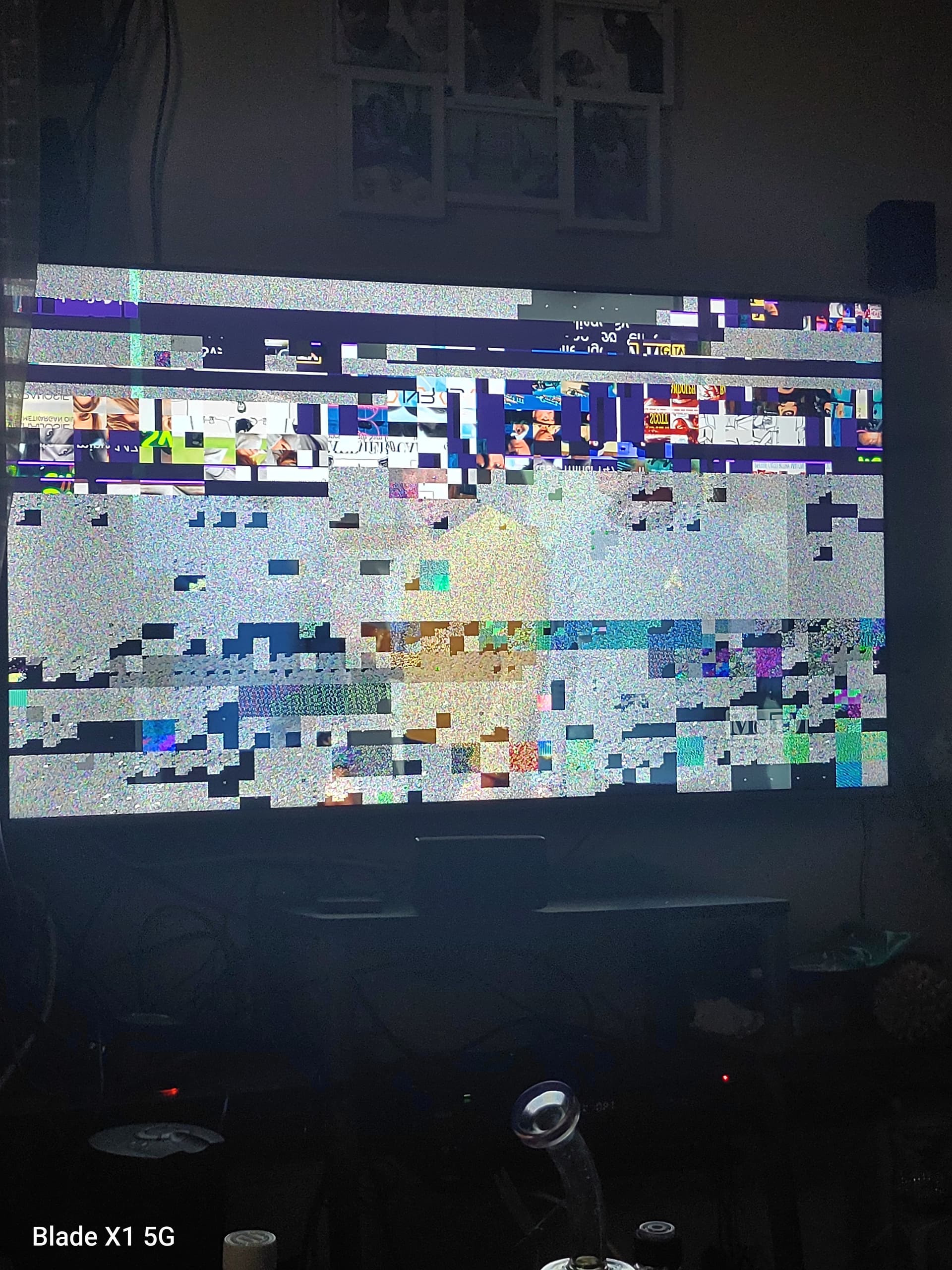

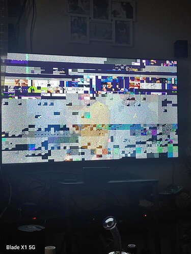

I've been having this issue ever since I started using channels. But luckily this issue never happens in my most watched channel. But when I switch to other channels it almost always happens.
When the captions are on. There these lives of graphics from the menu and guide covering the picture.
At least I figured out that if I turn off the captions it will go away. But that leaves me with basically not able to use the captions on most channels.
Is anyone else having this issue?? I can't believe that in the only one having this
Your image looks like macroblocking. If so, to me this indicates your signal has issues.
Perhaps you can share some details and log entries at the same time these visual issues occur ...
Naaa, it's not signal issues. It goes away when I turn off captions. It's graphics from the guide overlayed
Well, more actual technical details would help. But, still based upon your single picture and limited input, I offer this:
Your hardware (whichever device Channels is running on, likely some Amazon or no-name Android device) cannot handle decoding the video stream, the caption stream (CC, CEA-608/708, TTML), and the audio stream.
You can change the decoder/driver used, which may help. But otherwise, you need to offer details.

Did you try switching to software decoding?

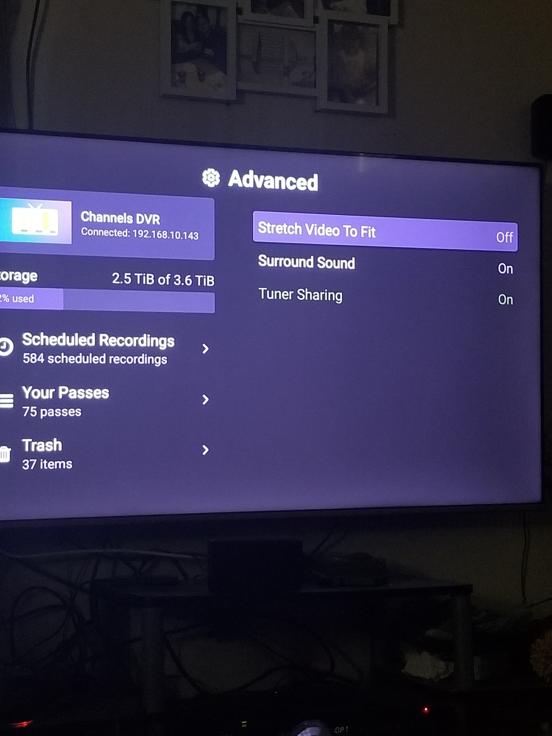

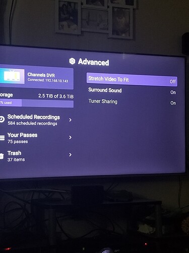

I don't see this option in the settings of the app on this device
On my Nvidia Shield it is in : Settings --> Playback --> Advanced --> Video Decoder
Isn't this where this setting is supposed to be??
I don't see on this android device on neither thre bata app, nor on the regular app.
So i checked the apps on my Fire TV, the bata app also doesn't have it, the regular app does on the Fire TV
But on this android device neither app has it
That's what i thought. Thanks for clarifying
