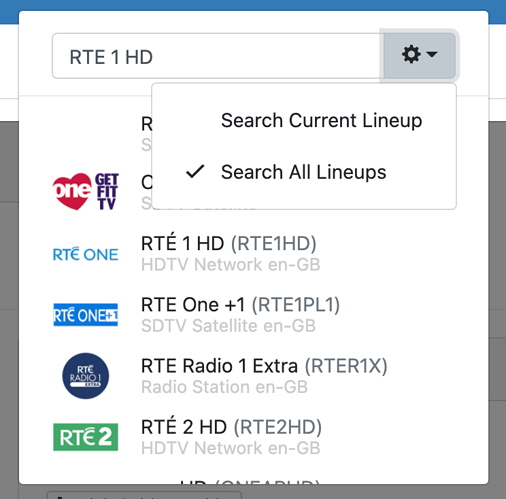

OK cheers - in that case. i am a bit of a novice and it seems hard for me to do this...is there a grace note list of numbers i can refer to for channels?
See:
But that is if the XMLT is found and inserted. The trouble is getting the XMLT
