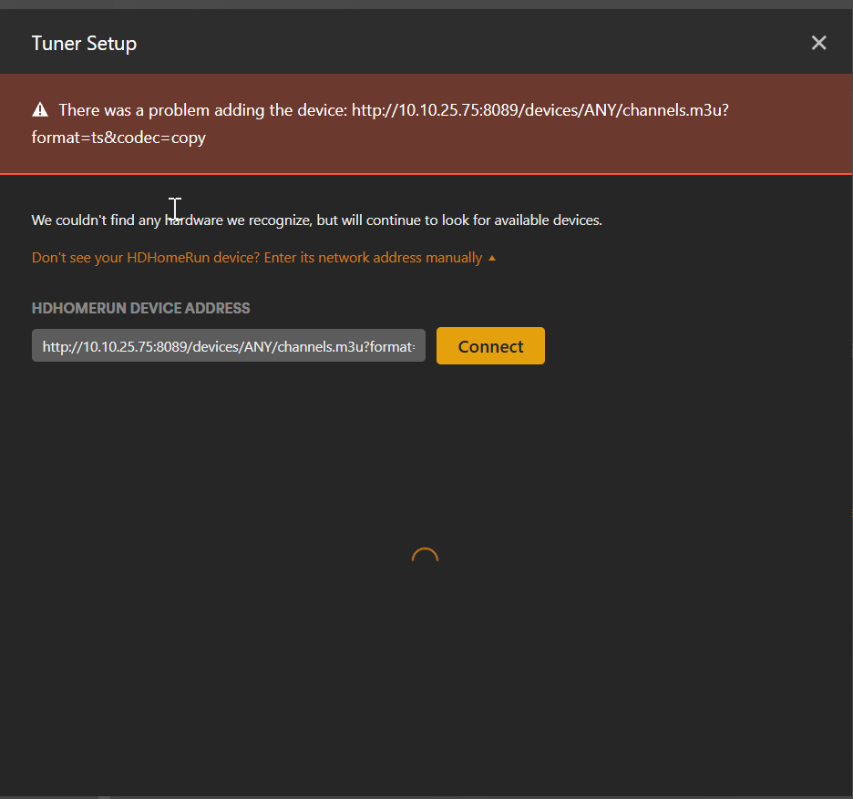

The Configuration Issue
When attempting to integrate my Channels DVR with Plex, I encountered an error. After copying the M3U URL directly from Channels DVR and attempting to add it to Plex as a tuner device, the system failed to recognize the connection.
The error message indicates: "There was a problem adding the device" with reference to the Channels M3U URL. Despite the system continuing to search for available devices, the connection cannot be established.
Are you sure the IPs can talk to each other?

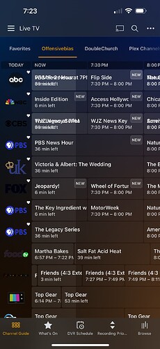

Thought I'd ask this here since it will probably take forever to get a response from Plex. When switching from Plex guide (with live TV playing in upper-right) back to full screen, there's a noticeable delay where screen goes black for 2-3 seconds.
Just wondering if anyone else has this issue?
