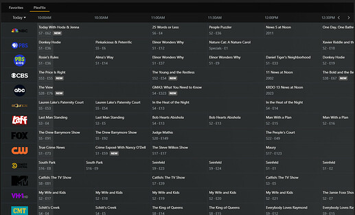

You show the View at 10:00 am ... I show some other guide data for that time slot .... As you can see the guide data is screwed up ....' in Plex.
But on Channels which is feeding Plex it is ok ... both on same machine ... so the time setting is ok ... Plex just sucks.
This is Emby same feed from ChannelsDVR as Plex ... everything on time.
