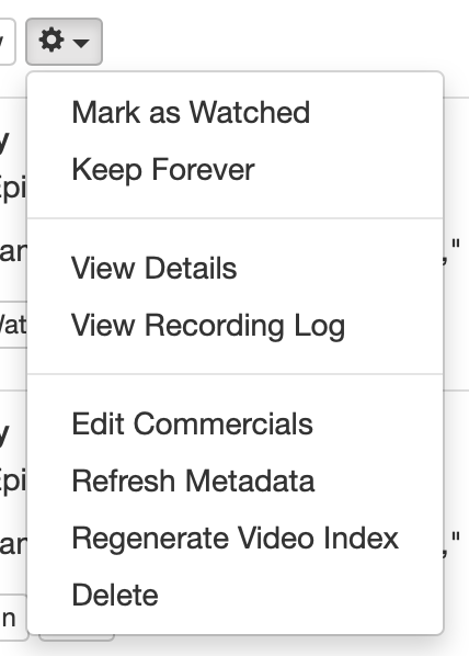

Could you email [email protected] with the Recording Log of the video you posted? You can get to it from the gear icon on the show listing.
