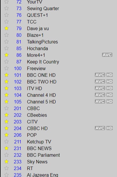

@tmm1 Looking at my HDHomeRun only a couple of the channels actually say anything next to them and its only on the HD channels bar 1 other channel More 4 +1 which says AVC ago. Am I right in assuming all the other channels with nothing next to them will be MPEG2?
The below shows a screenshot of my channels, the full list above and below have nothing next to the channels only these seem to show what format they are being streamed in
I've found the labels in the HDHR channel list to be somewhat unreliable; I think it has to do with how it scans and whether a channel is actually broadcasting when the scan occurs.
Not sure how technical you are but anything broadcast in DVB-T2 in the UK will be in H264 regardless of HD or SD. So all channels on the PSB3, COM7 and COM8 muxes are H264. Everything else is DVB-T and MPEG2. Here is a good site to see what channels are on which muxes: https://www.terrestrialtv.uk/

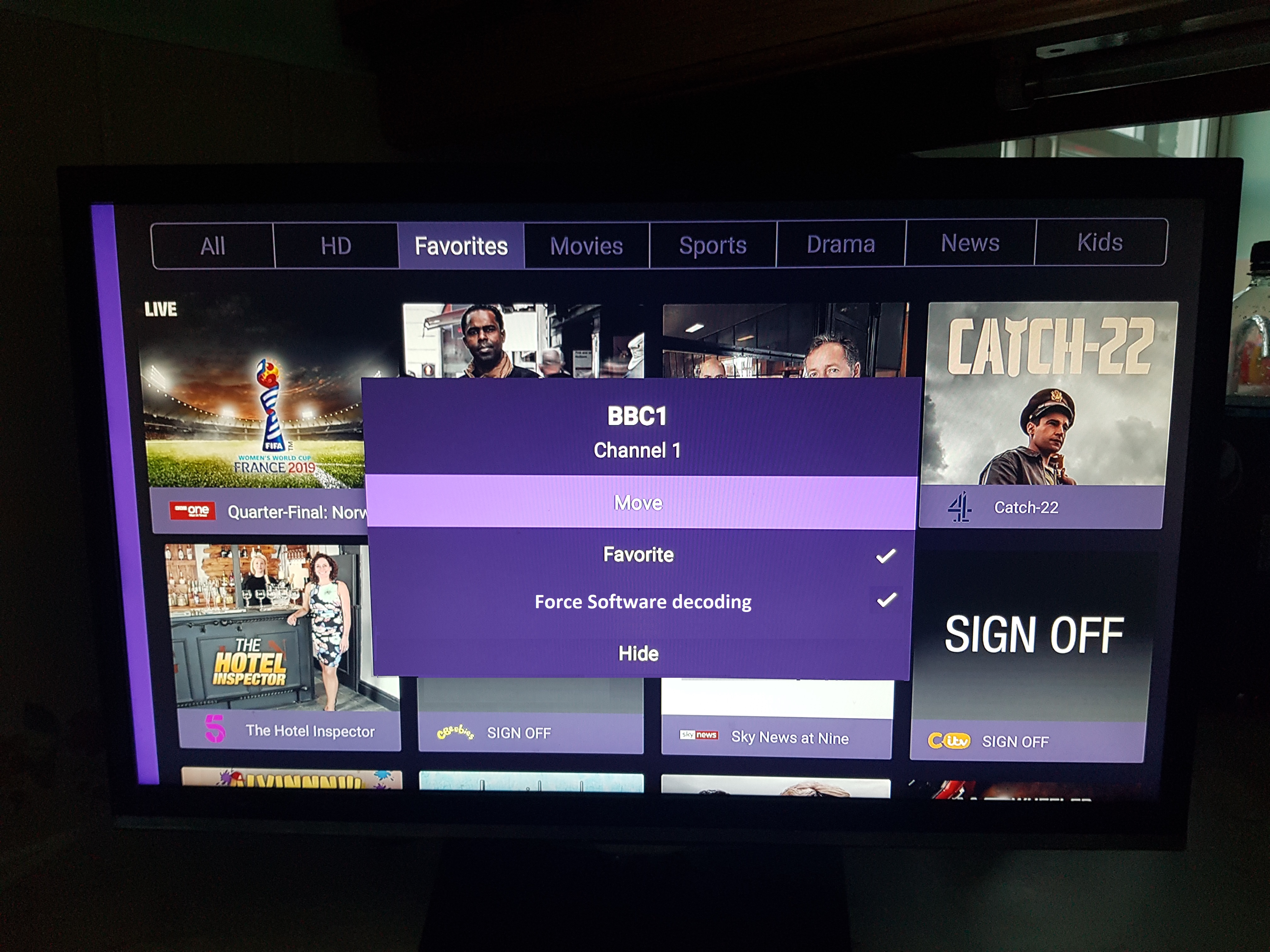

@tmm1 It would be nice if we could set the tuner to decode with hardware but when pressing the menu button on a channel you see a screen like below with the option to put a tick next to force software decoding. This would allow us to specify software decoding on a channel by channel basis
Don't get me wrong this isn't a solution as such but a bit of a work around until Amazon do fix the issue... if they ever do. This way we can use HD for lower frame rate required streams but switch to SD hardware for sports and such where they are currently unwatchable with software decoding and frame rate issues
