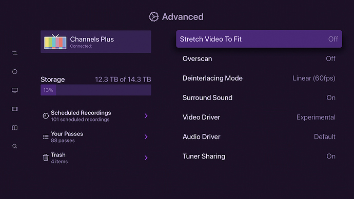

There are three stations where I live that appear to be broadcasting in 1080i. The stats show them as 1920x540. In the Channels app if you go into Playback > Advanced and change Deinterlacing Mode to Blend, and enable Stretch Video to Fit, it may fix it for you.

Thanks for the info. I had mine set to linear and experimental video driver.

No longer need to enable Stretch Video to Fit, which is nice. Still have to set Deinterlacing Mode to Blend. But, I'll take progress! Thx.
What happens if it is not Blend?
Linear: Blue Screen.
Experimental: Nothing, just a checkerboard bg.
This is on a 2015 iPad Pro.
Btw., this issue is only on the 1080i/540 channels. The one 720p channel works fine with Linear or Experimental.
