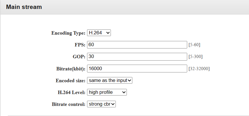

The Quality is great but playing in Channels DVR it is a bit jittery playing in NEXTPVR it is smooth.
I am really pushing it ....
Lowering FPS to 30 stopped the occasional jitters.
I found that using High H.264 profile didn’t play nice on one of my older client devices. Going to ā€œMainā€ fixed that. My limited understanding, which I’ll probably get wrong and oversimplify, is that High uses a more advanced instruction set, but older devices aren’t compatible with it,
This is what I am using in my Production System .... I will try Main to see if it makes a difference.
I did some testing, and you are right. Main is better. I had dropped frames using High on my FireTV but none using main.
I settled on this.
