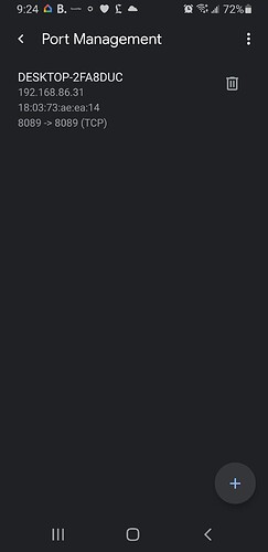

In your Google Router did you forward port 8089? If you didn't, open the Home app on your phone:
Advanced Networking --> Port Management --> Choose Device --> Add Rule --> 8089 == 8089 TCP
Yes, here is the screenshot

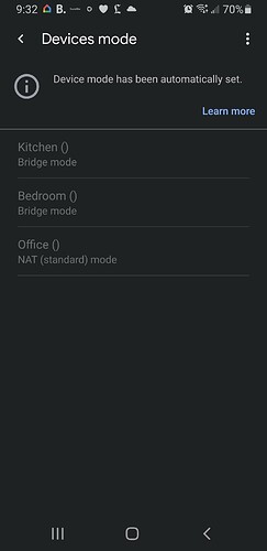

You could be in a double nat situation. Does your cable modem function as a router? If so what model is it? It's possible it could be placed in bridged mode.
That looks right.

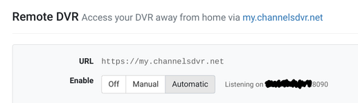

Further down on the Channels Settings page did you enable Remote DVR
I suspect that is the problem but don't know how to resolve, but the cable modem is not supposed to have a router function. Here is a screenshot showing bridge mode. Office is the connection to the switch.
Yes, it worked fine with my old ISP's router but not currently on either Manual or Automatic.
