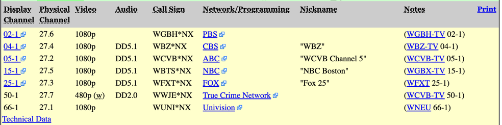

Actually, I'm not so sure. There are seven ATSC streams on a single lighthouse transmitter, as shown here (from rabbitears.info).
As you can see, the callsigns are different and the program streams may not have the same internal identifiers as the guests' ATSC 1.0 signals.

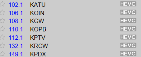

And I thought it came from the channel lineup of the HDHR tuner (that tunes each channel during a channels scan to determine SD, HD, HEVC, DRM, etc).
Anyone with an ATSC 3.0 tuner see HEVC as a tag on the channel lineup?
My HDHR Prime only shows tags AVC, HD and DRM
Screenshot 2023-02-05 at 12-13-38 HDHomeRun Lineup
http://hdhr_ip_address/lineup.html
So unless the devs can enlighten us, the ATSC 3.0 channels have higher priority because they're a higher channel number, not because HEVC trump HD in priority (HEVC is a codec like AVC). Maybe when UHD-4k is common we'll see a UHD or 4K tag.
