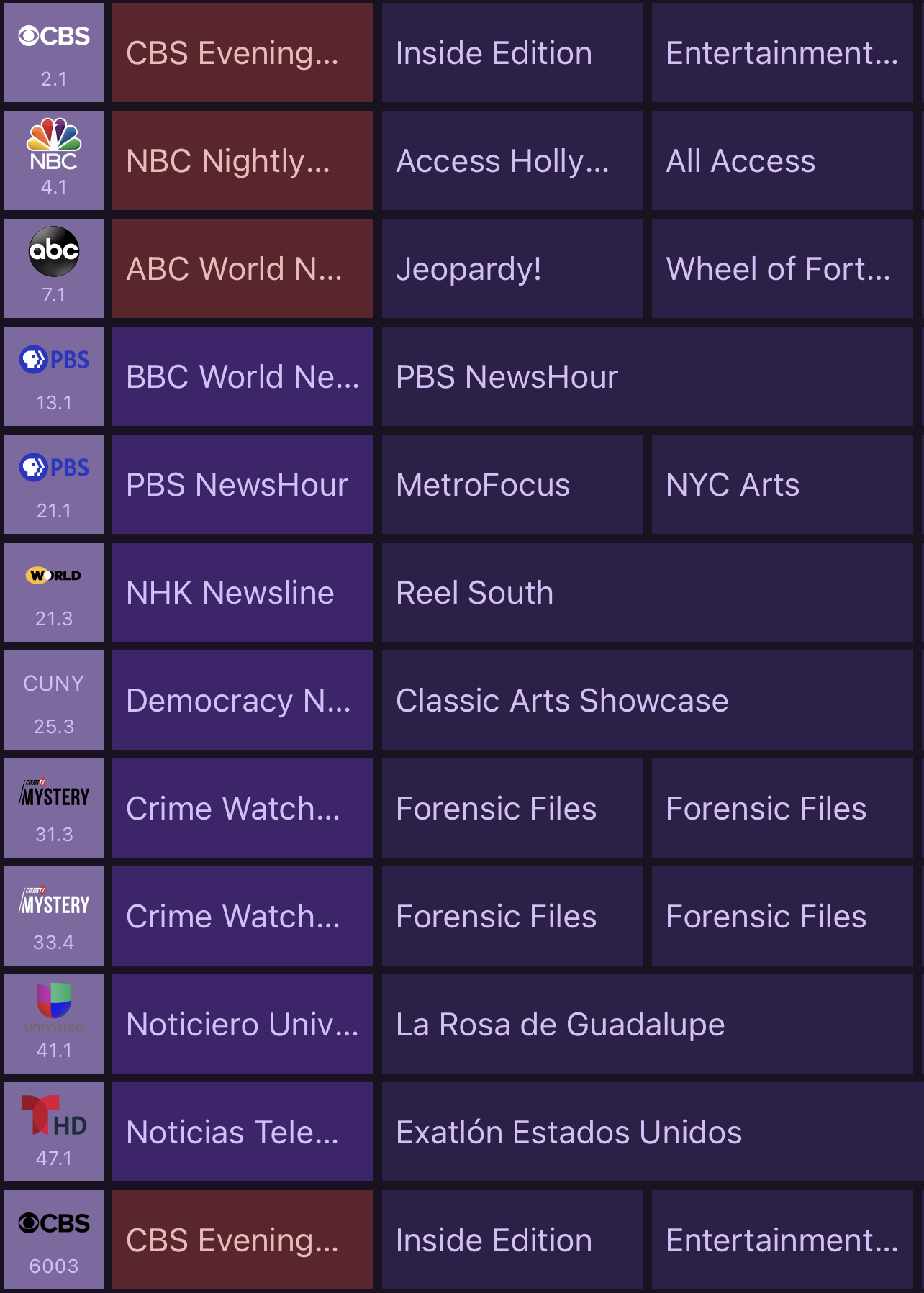

Ok. So in my area, we get 3 locals over TVE that the bulk of our recordings come from. When it is recording, it will be red for the channel in the hdhr lineup, and also for the tve channel. There are times when 2 recording are going at once. Trying to watch a different antenna channel will tell me all tuners in use, just a 2 tuner. If I can get it to record from the tve channels it would never use a tuner, correct? Is this possible?
This means the program is recording, but not necessarily from that channel. Since both channels are airing the same content, both instances will show it as being recorded.
Yes. Just set your TVE source as a higher priority on the DVR. (Priority settings in the client are only for live viewing preferences; recording priority is only set at the DVR.) Or, favorite the TVE version of those local channels, and they will be attempted first for recording.
Only the actual channel being recorded should be red. Looks like this was not working as intended on Android and has been fixed in the next beta.

It doesn't seem to be defaulting to the TVE channel, it chose the tuner.
Recording ch29.1 for American Masters until 8:30PM.
It only shows the one recording. But the Frontline is listed gold twice, so maybe that fix was only for currently recording and not scheduled? @tmm1
The DVR > Schedule tab shows the channels considered for each job in the order of preference. Frontline is scheduled for either channel, so both show in yellow. When the channel is picked, one of them will turn red.
