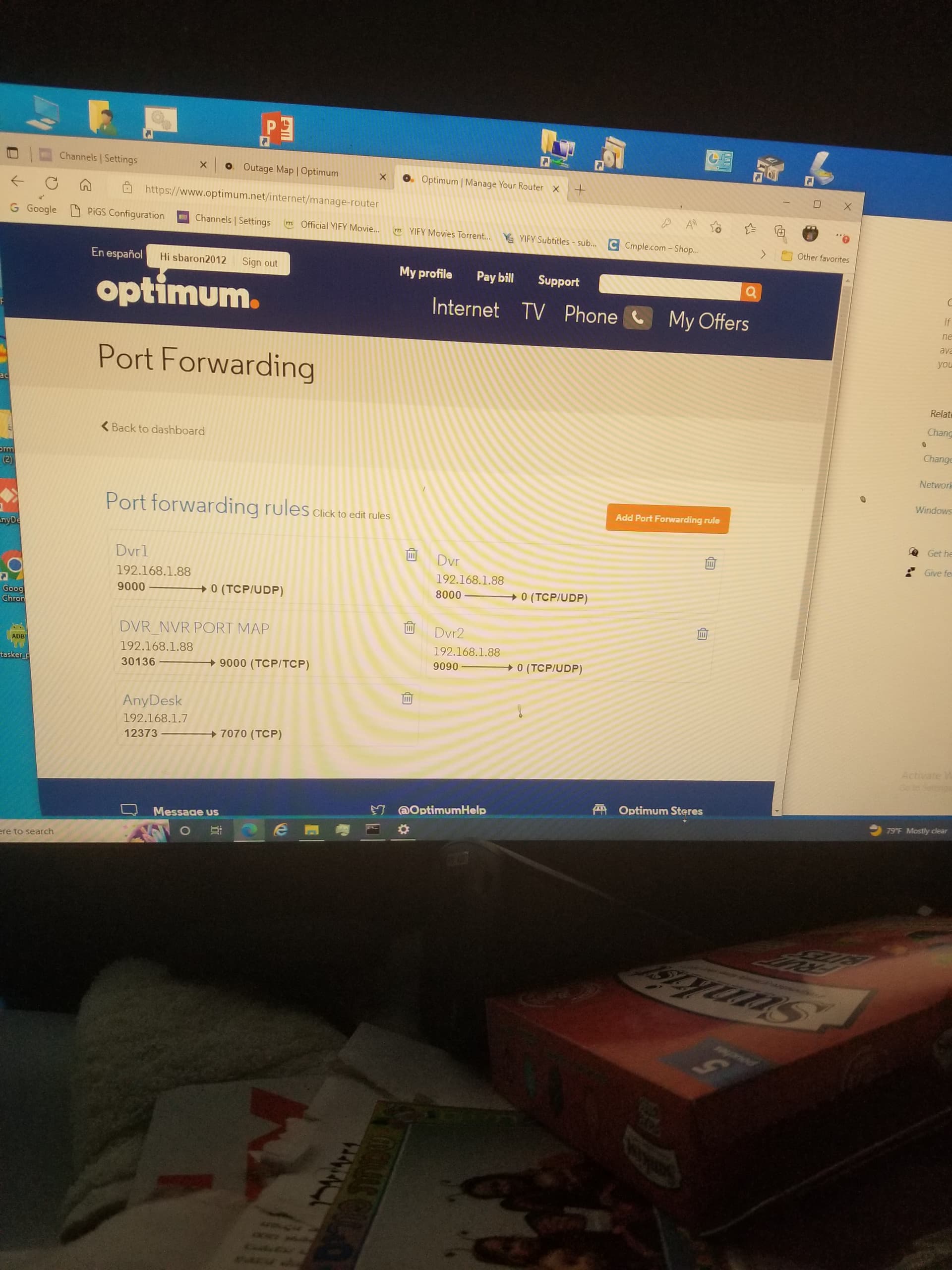

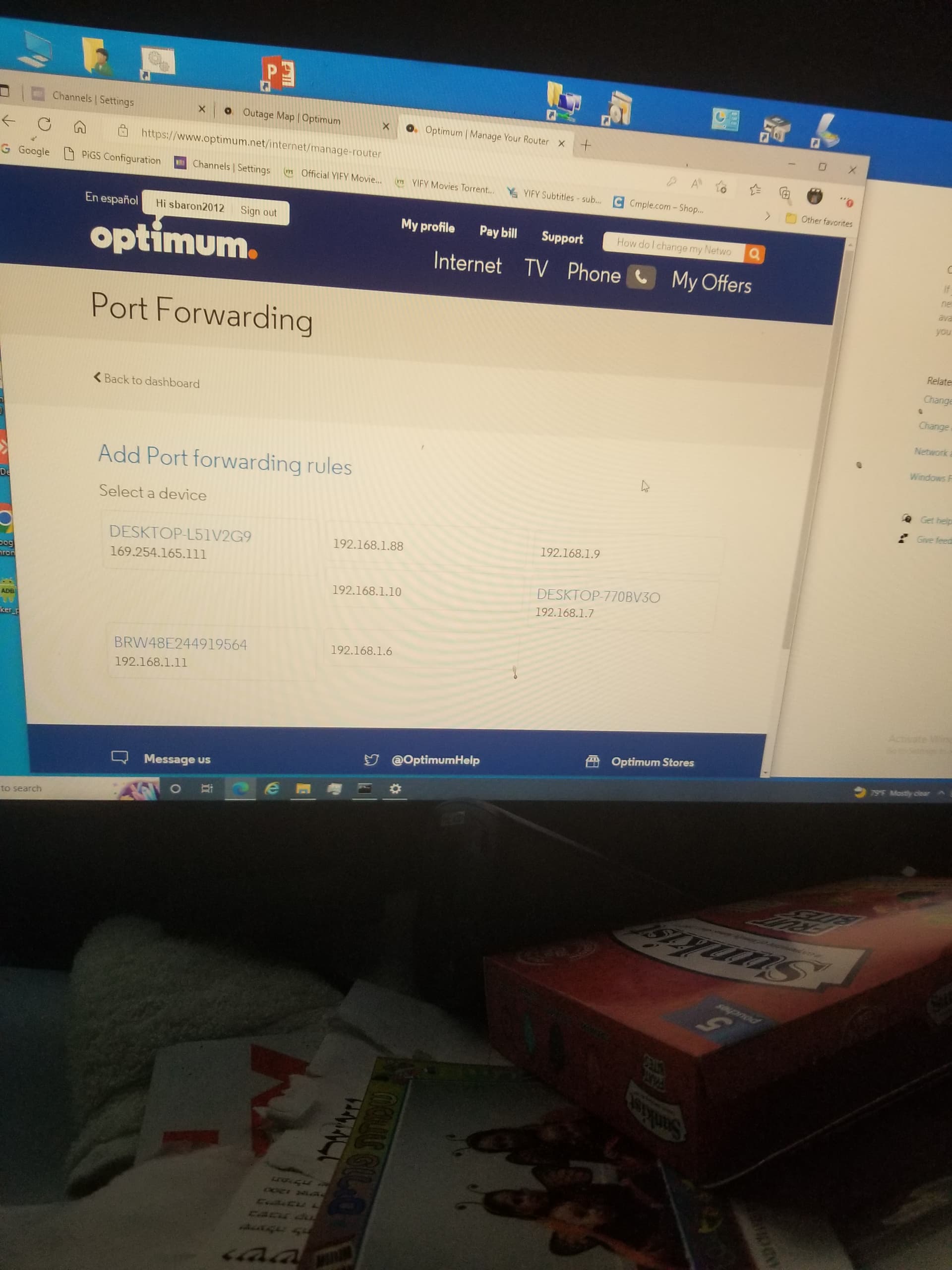

Nope, sadly i do not see a way to type in a address, i tried that when i first tried this. It only allows me to choose from connected devices.
I'll take a photo of the page
If i click that orange button to add a new port forwarding rule, it then opens that second photo page, which only lets me select from connected devices. No way to add one manually. Which sucks.

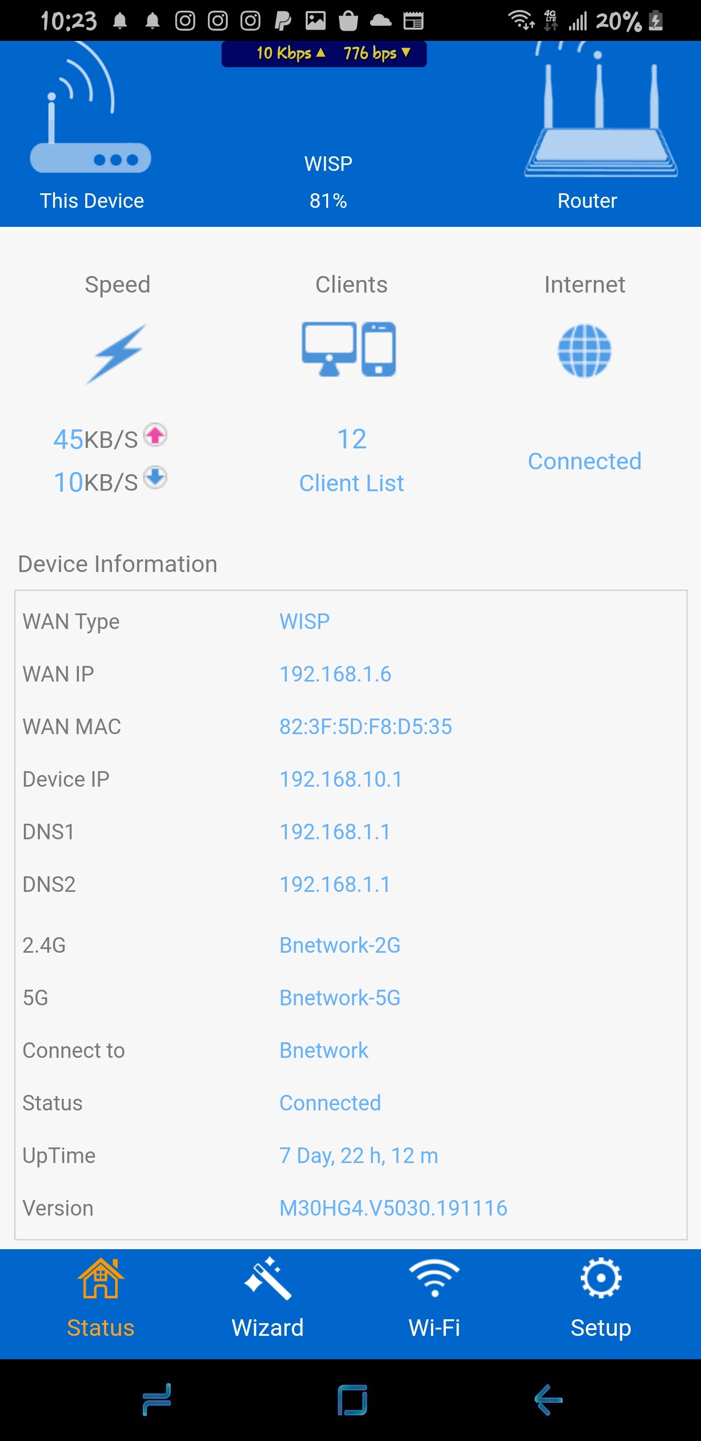

Those are all 192.168.1.x
Your dvr is 192.168.10.x
So your repeater has its own NAT.
On the repeater web UI does it have port forward settings? What does it show on the main settings as WAN IP

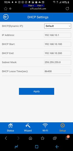

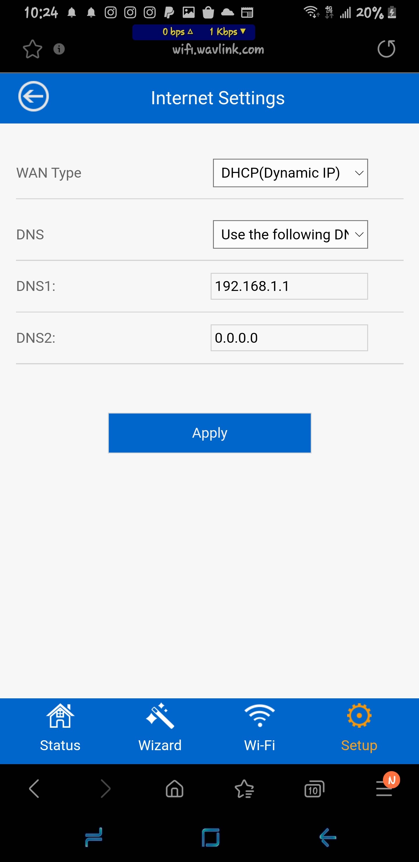

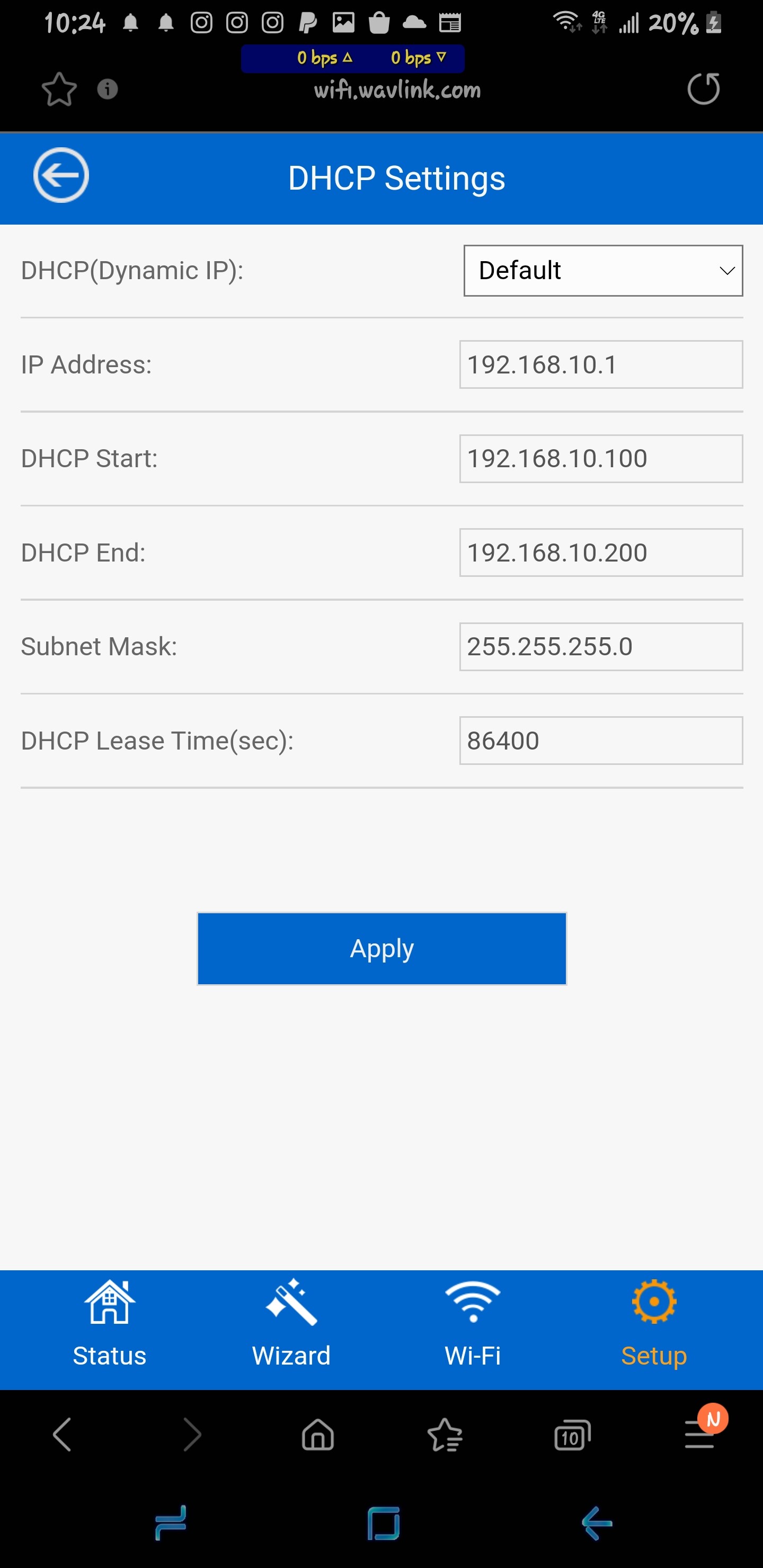

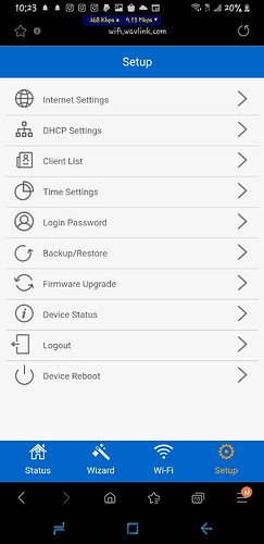

On the reappear web settings page there is no options for port forwarding, none. Let me show you a screenshot of that settings page. Maybe they call it something else? But there is very limited options there. Take a look....
First photo is the first home screen.
Then the setup tab...
On other WAVLINK devices there is a Network Tools section. Seems like your repeater doesn't have that so there's nothing you can do with that hardware..

What I’ve always done is turn off dhcp on the repeater. That way it’s not assigning its own clients ip addresses. When you do that what ever you connect through the repeater gets an assigned ip address from the main router. Then you can port forward to your channels server. But there will be two caveats. One…….make sure you have all your settings set correctly on your repeater cause most likely you won’t be able to access the gui of the repeater unless you fully reset it. Two…….you will be visible to everything connected to the main router.
Ahhhhhhh. Thanks !! I knew it's one of these settings! SSI it's the dhcp! Thanks thanks thanks.
