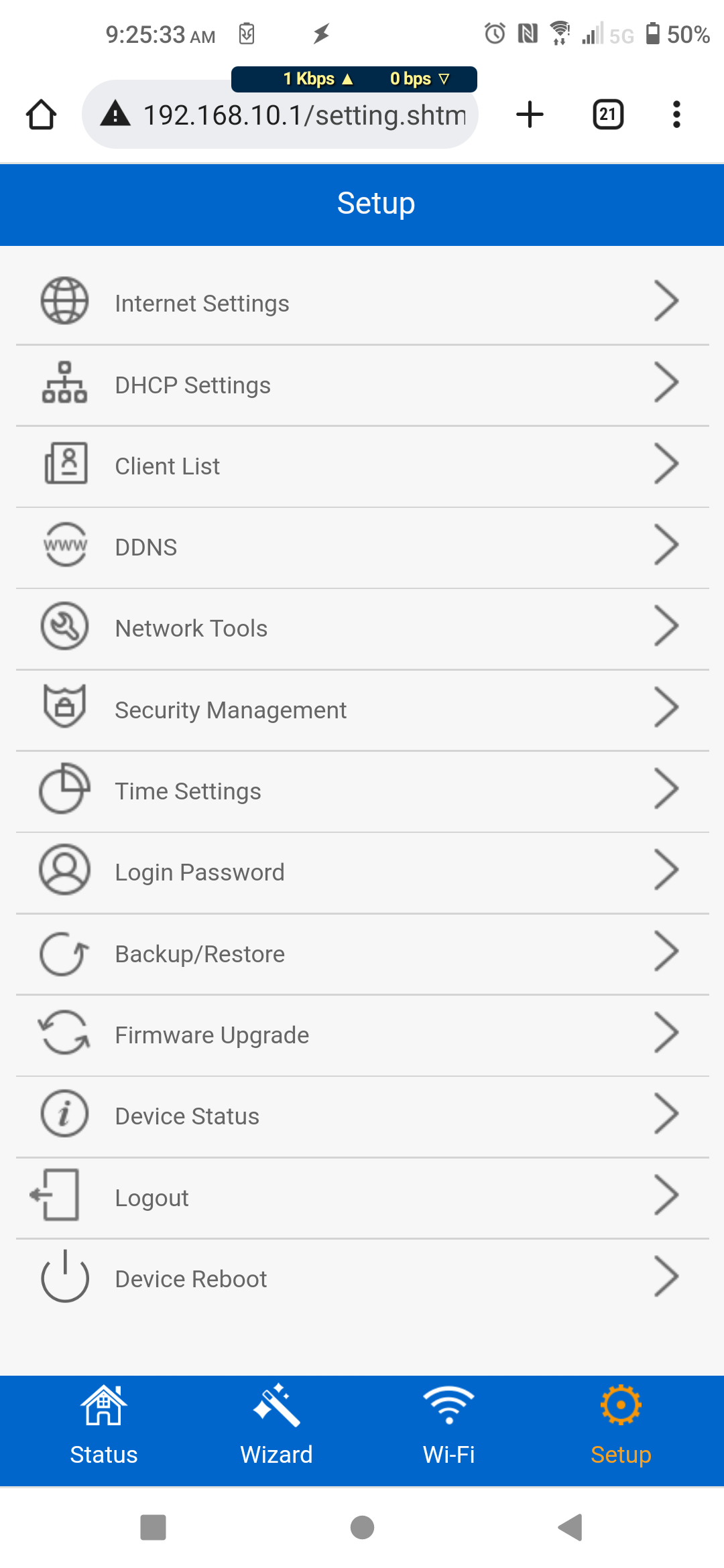

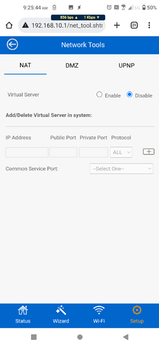

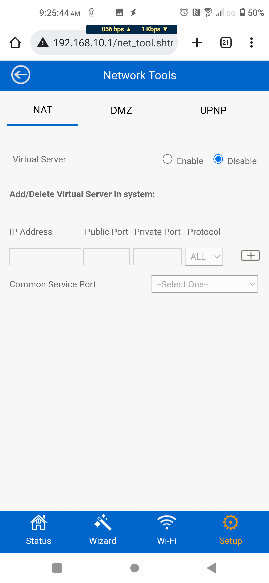

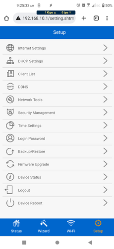

So while I did a factory reset today of the router, I checked the setup tab before seeing it up as a repeat (or WISP mode as they call it). And now I saw a whole bunch of other settings that I didn't have before, including the network tool manager you mentioned.
But once I connected it and set it up in repeater mode, those settings disappeared.
So I guess in repeater mode it's limited with options
