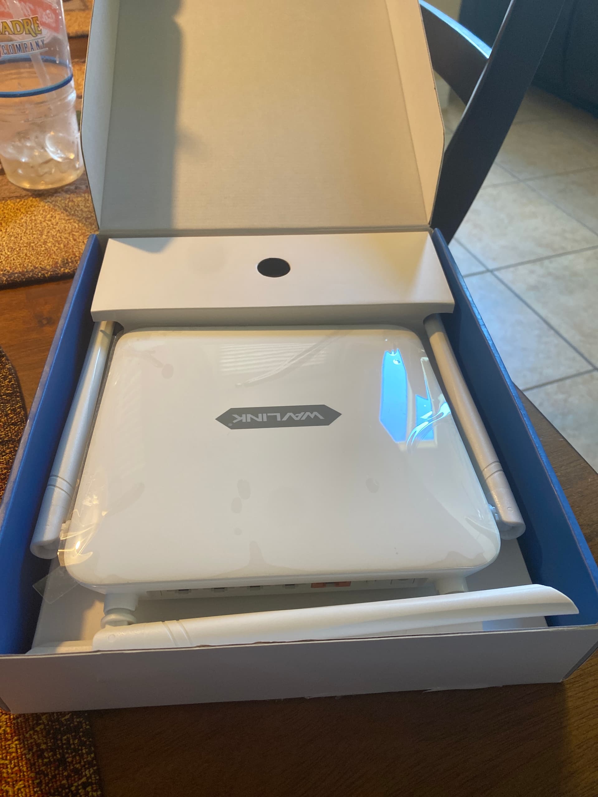

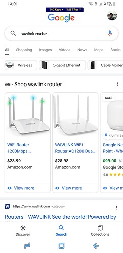

Na, it's white, and not round
Ok I ordered it…….imma try to replicate your setup and see what can be done. It comes in tomorrow so give me till Wednesday for a solution.

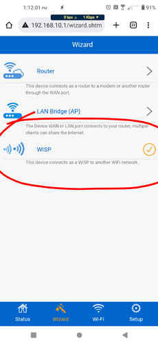

Keep in mind, I use it in WISP mode. Which is their name for repeater mode
Are you sure about that? Typically, WISP (wireless ISP) would use a wireless connection as your WAN (as opposed to a wired Ethernet connection), but still provide NAT and routing using a different local/private network (LAN). (Basically the same as a standard router, except with a wireless connection to the modem/gateway instead of a wired as one typically sees.)
I am not saying that you are wrong. I am just saying that if that is indeed the case, then their terminology is confusing and non-standard.
This device connects as a WISP to another WiFi network.
That does not necessarily mean it is operating in bridge mode. That description is rather vague.

The actual model number would be most helpful. (It ought to be labeled on the device somewhere, perhaps the bottom.)

Wisp mode is repeater mode! It connect via WiFi to a network, In my case my landlords wifi network. And after I connect to my landlords wifi and put in his password and it's connected. It repeats my own wifi network that I can name and select the password for. So I connect everything to that wifi and to the 5 available lan ports.
Makes sense?

You're describing a separate router, not a bridge/repeater. In a bridge/repeater, your AP would be rebroadcasting your landlord's SSID.
I never said bridge. In fact bridge mode is one of the other 3 modes it has. I only kept saying repeater
It appears that the only way to gain access is to allow DMZ on the Landlord's router to your router ... and then you can open your ports... but other than that it appears you are SOL.
By definition, a repeater would be "repeating" or "rebroadcasting" the Wi-Fi you are connecting to. If you are creating your network different/separate from that Wi-Fi, you are not repeating it.
(And based upon the screenshot you posted, the device only bridges on the WAN port, not the WLAN.)

Just got it so let’s see what can be done!
