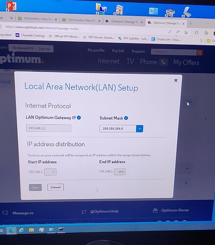

The DHCP lease time is probably set to every hour on the main router you can change that to Forever.
I saw no DHCP settings on the Optimum router
Look under Connection ... local ip settings or something like that.
Na I'm telling you the is nothing. Zero DHCP settings.
It sucks.
I think I read online that optimum orders DHCP settings only for business Customers with a high speed. .... Idk.

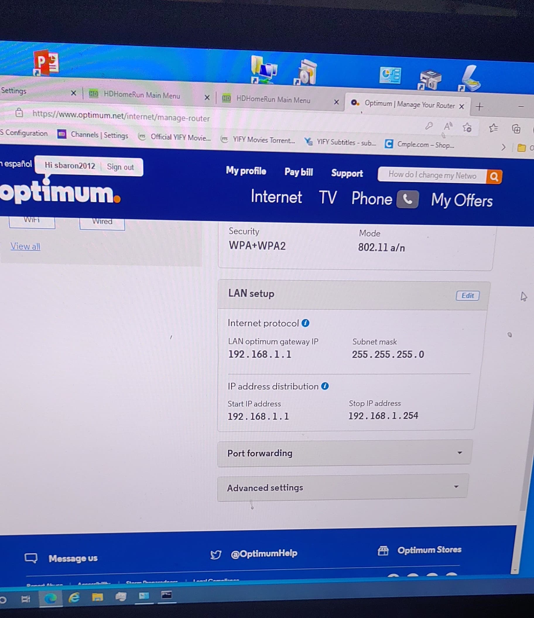

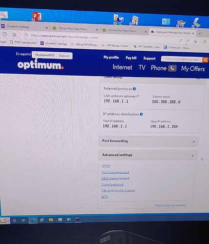

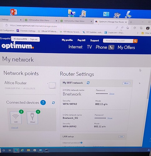

I'll post photos the router settings page. You'll see. There is nothing
Here are ALL the settings....
Yeah from what I read on optimum devises is they had an update that removed most of the settings to default an ip on your local lan. Some said you could limit the End IP Address to like .200 and you can then hard code IP addresses above 200 on your devices. But I don't think the HDHR will let you set that on its end. So you would still be screwed on that.
