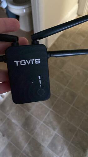

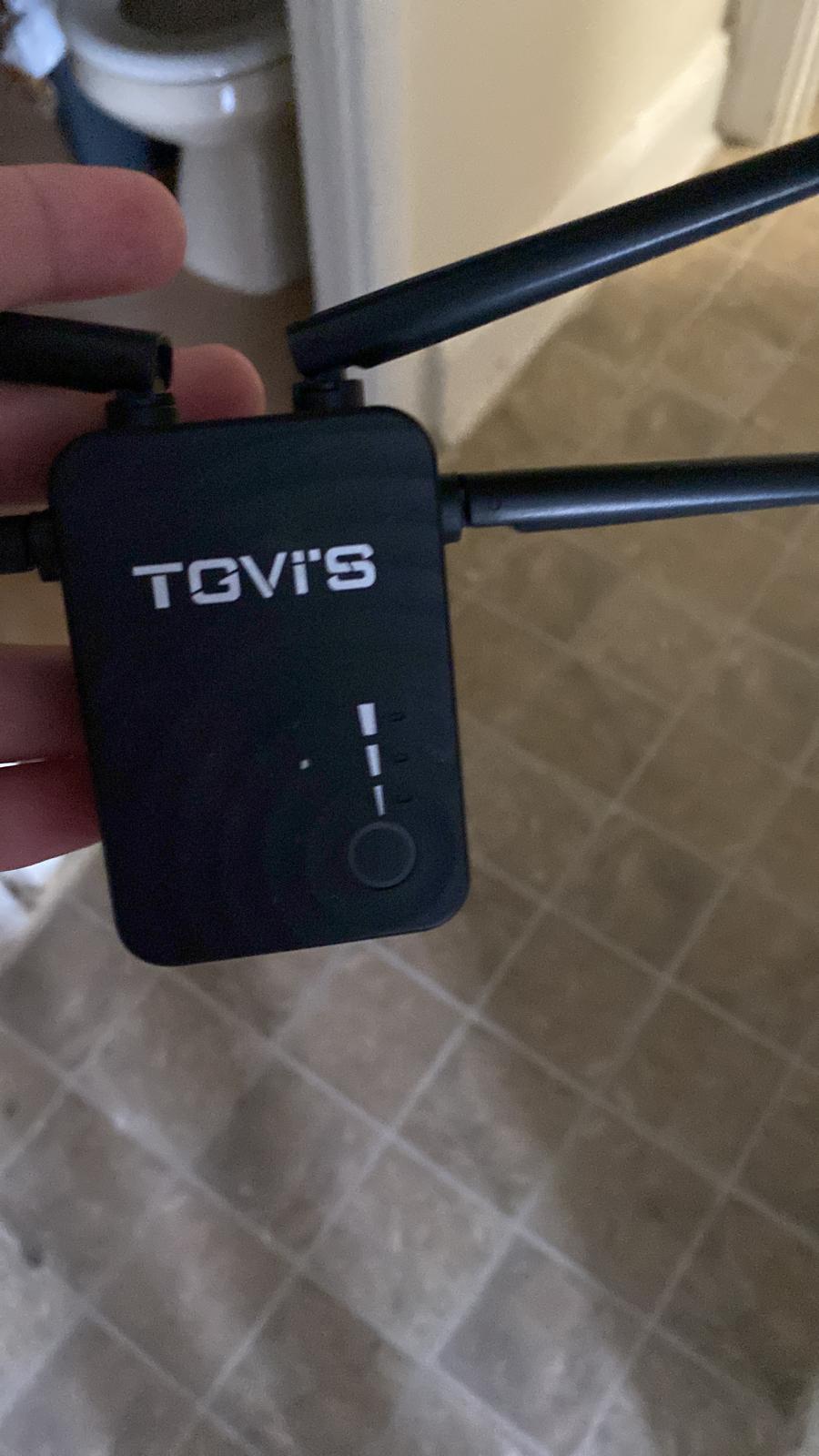

Another option I'm considering is maybe trying to go back to my small plugin wifi Repeater I was using before this Wavlink Router. It was a small simple repeater, but it had 2 Ethernet ports at the bottom (most have 1), so I can make that work. And I saw in web page settings of that I saw a section for port forwarding. So I'm gonna try to transfer everything back to that repeater, and see if I can indeed just activate the port forwarding from that directly.
I can't recall the name of the brand that repeater is, something like TGVI. I Believe.

So I pulled out my old little Wifi Repeater that I used before getting this Wavlink Router. I had to make adjustments to make it work, but I got it done. Mainly the Router had 6 Ethernet ports. So I was connecting my, HDHR Flex 4k, My Channel Master DVR+, and my new Tablo Quad. So changing back to the small Repeater that only had 2 ports, I had to lose one. So I googled how to connect the Tablo via WiFi, which for some reason isn't as simple as you'd think. But I got it connected via WiFi. So the 2 ports are for the HDHR, and the DVR+. As they don't have a wifi connection option.
So at first I set it all up, as I used it before. In regular repeater mode. Now the reason I tried this changing back to it, is cause I saw in the settings page this repeater does have a section for Port Forwarding. So I set it as regular repeater, and tried the port forwarding. But it didn't work. The remote viewing was still saying my report isn't visible.
So the next thing I did. I did almost by accident. I clicked in the settings page on Bridge. And it reset everything. And now I get what was mentioned here before that the web settings for the repeater now disappeared. Cant access it anymore. But now everything I connect to this repeaters wifi, was now getting IP address like from the main router!
So it's funny, the repeater has a physical switch on the side that you move between 3 positions, AP, Repeater, Router. So that switch I still have on Repeater mode. But when I click Bridge it bridges in repeater mode? That's something the WavLink was missing.
So now in Repeater mode, with Bridged setting. I went to my main cable routers settings page. And I could easily setup the Port Forwarding, cause all my devices including the PC running the Channels Server, were now there on the router page as connected devices. So I just Forwarded 8089. And walla! I got remote viewing capability!! For the first time!!!!
