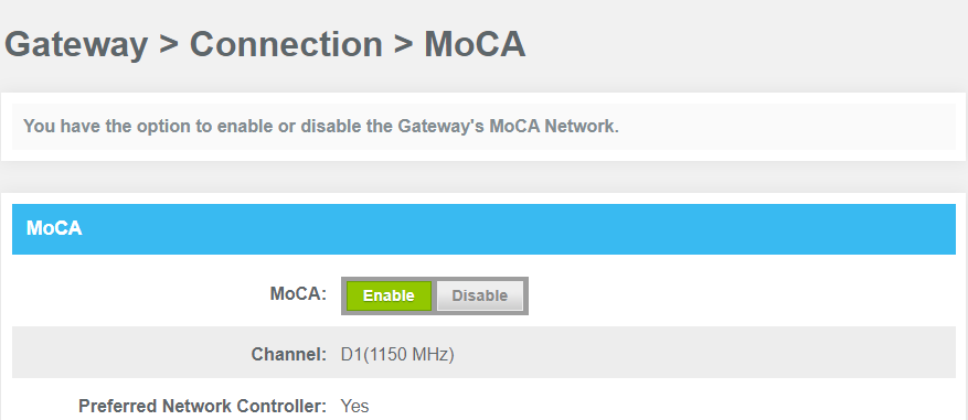

The XFINITY/MODEM router has built in MOCA so you only need 1 additional Adapter. If your MODEM/Router does not have MOCA then you need at the minimum 2 Adapters.
One way to find out if your Modem has MOCA is to login to the web page usually found on http://10.0.0.1 for xfinity.
yep I do have it...but whats weird is I already have mocas in my house 2 one from the basement to the attic but it still says no mocas detected in the modem. do they only work in pairs?

my coax comes into the home and goes directly into a splitter. 1 goes to the modem and 2 goes into a moca adapter. that moca adapter goes into the modem ethernet. the coax then travels to the attic where I have another 5 way splitter. 4 go to the bedrooms. and the 5th goes to another mocha adapter. which goes ethernet to another switch.
These 2 moca adapters work BUT I have attempted to add another moca in one of the bedrooms and it does NOT work. I just turned on moca in the modem and I havent changed anything yet but the modem says it doesnt see any moca adapters on the network which I thought was kinda weird.
Why are you connecting the Ethernet from the Moca to the modem if the modem has Moca ? If the modem has Moca active you should not connect the ethernet from the moca to the modem ... the coax is enough.
The moca ethernet should connect to a switch or some device. Not connected to your modem.
i got it now...its working...WHOO HOO!!!

Did you make sure you have no Ethernet from your Moca connected to the router if it already has coax connected to it ?
