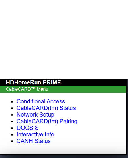

Found the IP address via router app.
When selecting "CableCARD Menu":
It displays No CableCARD installed

To get host id etc ... you need to go to ... get Your Prime IP replace it in the below.
http://YourPrimeIP/cc.html

CableCARD information is missing
Go to the web page for your HDHomeRun device (click on one of the tuner numbers on the Tuners tab in HDHomeRun Setup), then click on CableCARD Menu. If the Card Manufacturer, Card Authentication, and Card Validation lines all show as none, this indicates that the CableCARD is not in a usable state. The most common cause of this would be if the card is not inserted correctly. The card should be inserted with the colored label facing up, and the 68 pin connector going in to the HDHomeRun. It will require a slight amount of force to seat the card in the socket. Approximately half an inch of the CableCARD will remain outside of the HDHomeRun when fully inserted.
If the card information is still missing and you have verified that the card is inserted correctly, try another CableCARD.
I would think if the cable card was working in your TiVo and you didn't zap it with static electricity and inserted it correctly in the Prime and it doesn't work, it's probably the HDHoneRun Prime and that you should contact Silicon Dust support.
Sincere thanks for everyone's assistance and patience; x100
Card installed & paired
