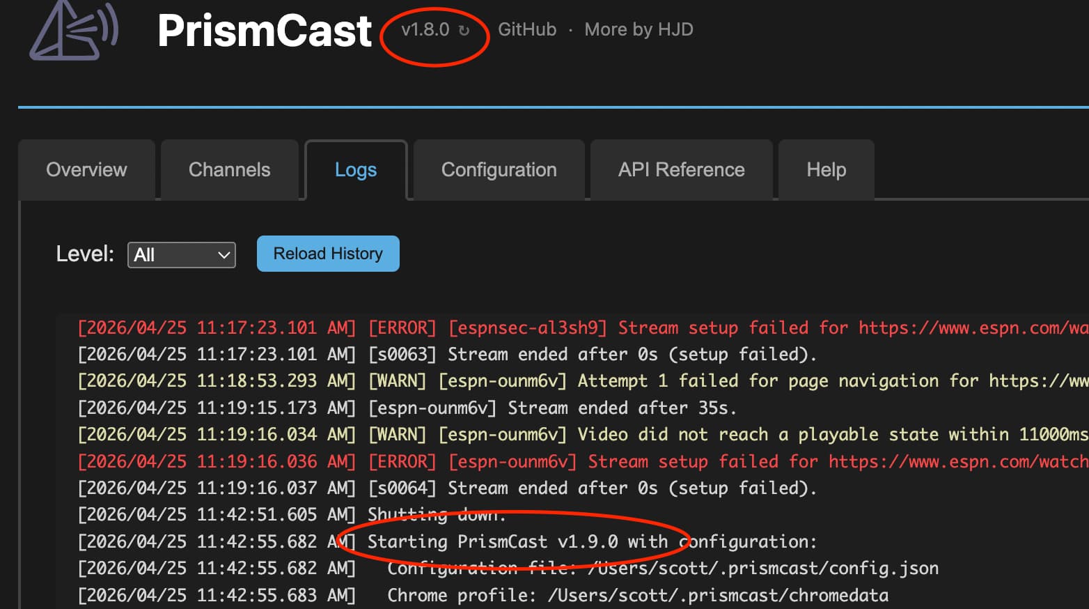

EDIT - Actually the channels do tune when I click through Channels. However, the below does show up when I click the "verify" link within Prismcast. I'm not sure why I am getting different results when clicking through the verify vs. tuning through Channels (which is using Prismcast). So hopefully this is much ado about nothing.....
Curious if others are having the same issue I am. I have YTTV and login to Disney.com within Prismcast. I don't use these channels much, but when going through and "re-validating" all my channels this morning, noticed that all Disney channels (Disney, Jr, DXD) are bringing up the webportal, but the video doesn't auto launch and you have to click the "play" triangle within the video window to start the video.
Like I said, no major loss for me, though I am worried that Disney may port this over to ESPN eventually which would then be a major issue since I rely on Prismcast for all ESPN content now. Or if there's a setting to address this within Prismcast, would love to pre-emptively solve this before it hits ESPN.
