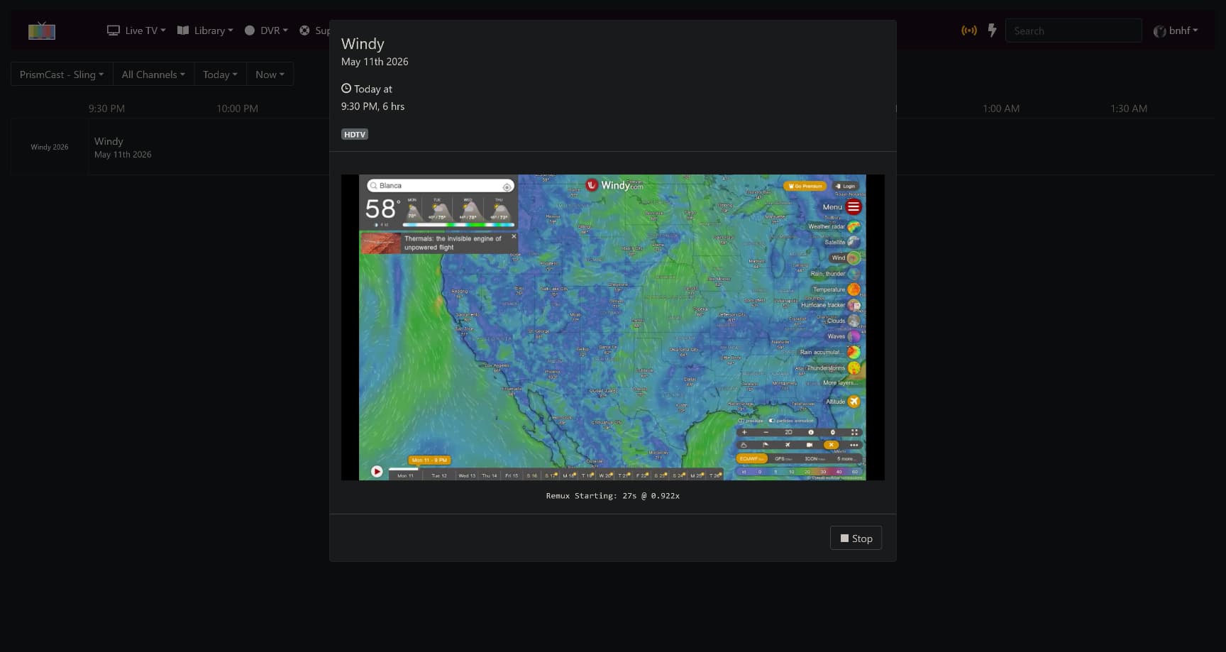

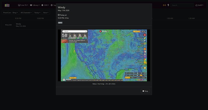

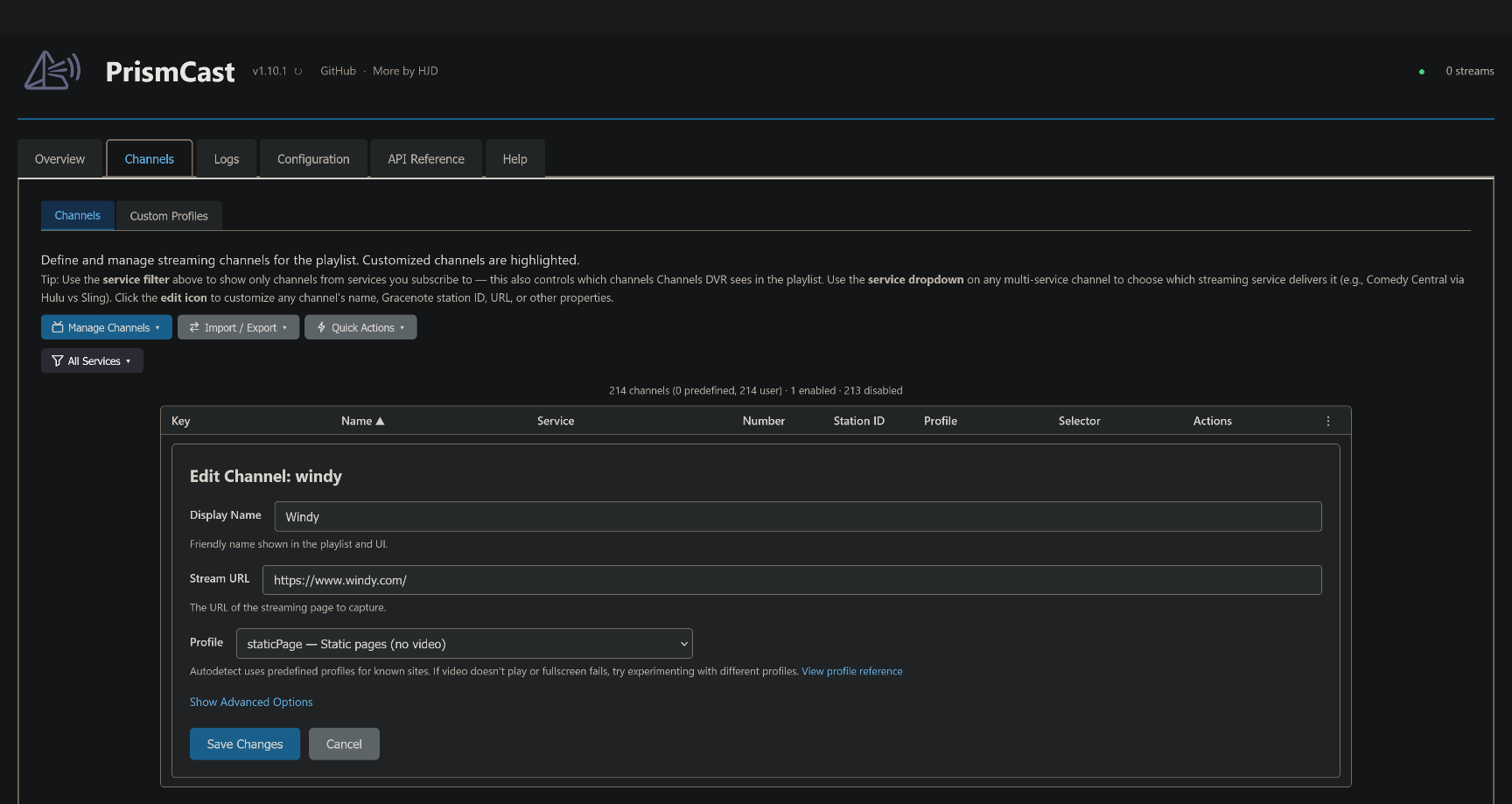

I'm trying to add a profile for Windy, but says it already exists as built in. But where do I find it?
It seems clear how to use this with providers, but I'm having trouble utilizing it for static web pages.
I just added it. Nothing here regarding it already existing:
oh I was adding a profile.
Ah, I was confused by the services section at the top of the form. I thought I had to pick one, vs it being helpers.
OK boom!
I've got Weatherscan, Windy, and doppler back up and going. Thanks everyone!

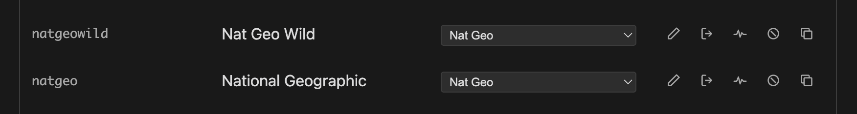

I've migrated my system to a new computer, everything is up and running just fine on 1.10.1. only issue is that no matter which service is selected in the dropdown, it is opening up Spectrum in the Chrome window. That's fine if I'm only watching/recording one thing at a time, but if I have multiple things scheduled at the same time, Spectrum gives a too many streams error. For example for National Geographic, it will open the Spectrum link and not the Nat Geo link. I have logged into Nat Geo, so that's not an issue.
EDIT: I want to clarify that doesn't seem to be for all the services as ESPN will open in ESPN.com, but this opens in spectrum

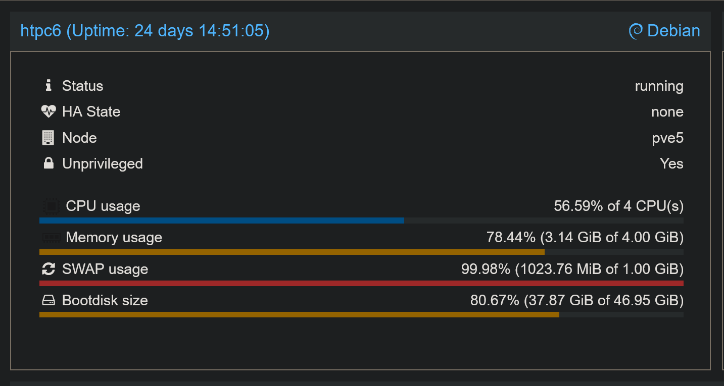

I'm trying to restart the prismcast container but the log says there is another instance running. If there is an orphaned PID file, I am unable to find it. I've tried to restart the docker service but that doesn't solve the issue.
Error: another PrismCast instance is already running (PID 31). Stop it before starting a new one.
(there is no PID 31)
Thanks
Im not sure it will work for you but here is what works for mine:
# Cleans the virtual display and the PID lock so it survives a Docker restart
entrypoint: >
sh -c "rm -f /tmp/.X99-lock /tmp/.X11-unix/X99 /root/.prismcast/prismcast.pid && /usr/local/bin/docker-entrypoint.sh"
entrypoint: >
I'd like to understand what's causing this in your installation, as the docker-entrypoint.sh script is already set up to handle this type of "unclean" shutdown:
# Remove stale X11 lock files from previous container runs. Without this, Xvfb refuses to start after an unclean shutdown.
rm -f /tmp/.X${DISPLAY_NUM}-lock /tmp/.X11-unix/X${DISPLAY_NUM}
im really not sure why but until i put that line in every docker resart i got an error and had to start over from scratch?
