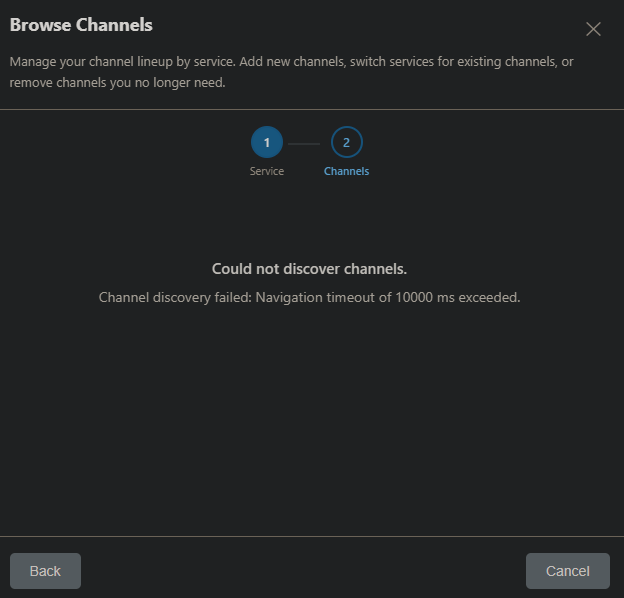

Thanks for the suggestion. I previously thought that as well so previously had just logged out and logged back in to Max using the wizard in PrismCast as well as using the link in the PrismCast channels list to individually authenticate one HBO channel thinking PrismCast stored those logins but that didn't help.
So acting on your suggestion, I just went in to Max and reset my home location to reregister my IP with them then cleared all cookies, cache and other data stored in Chrome on the Mac Mini and deleted everything. When I opened PrismCast back up, I went thru the wizard and logged into all of my providers, which "should" have relogged any discrepencies in location, IP or login info. I even went as far as stopping/starting PrismCast, which usually triggers Chrome to maximize and minimize as it validates every provider login on startup but for some reason, I no longer see that happening either, which is something new but yet YTTV channels still work thru PrismCast where HBO channels do not.
So going a step further, within the Channels tab in PrismCast, I selected the "Manage Channels" tab then selected "Browse Service Channels" and two providers were listed, YTTV, which displayed dozens of channels as expected but when selecting HBO Max, no channels were listed as available from that provider. So if nothing else, your suggestion at least discovered that discrepency as well so thanks.
So, at face value, it appears that I have lost any predetermined channels for HBO within PrismCast because it says none when I browse the service channel list. Is that because PrismCast still isn't recognizing that I am logged into Max or is something else out of whack? I can open Max in a separate tab within Chrome with the PrismCast windows still open beside it, Max clearly shows I am logged in upon opening the browser window and can manually navigate and play anything I want within Max thru Chrome on the Mac Mini, which tells me it's not a IP/location thing, yet PrismCast still returns the following in the PrismCast logs when I try to tune to a HBO channel from ChannelsDVR:
"Stream setup failed for https://play.hbomax.com: Channel selection failed: HBO tab not found in homepage menu bar. HBO Max subscription may not be active."

So after a complete uninstall and clean reinstall (not restore) of PrismCast, the issue is the same. It look exactly like it would when the channel ID is incorrect but with others saying theirs works fine, I am hard pressed to pursue that path any further. PrismCast takes me to an authenticated home page for Max but that's as far as it gets with the PrismCast logs showing the following:
[ERROR] [hbo-jlmgj5] Stream setup failed for https://play.hbomax.com: Channel selection failed: HBO tab not found in homepage menu bar. HBO Max subscription may not be active.
So I even went as far as adding a few additional providers I normally don't just to see if any others have this issue and none of them did. Services I was successfully able successfully authenticate and tune to in Channels via PrismCast (some directly, some using YTTV provider login).
YTTV, TVE channels, Starz, Paramount+, DisneyNow, USA, Food Network, USA, Fox Sports and Disney + so why not Max?
Chrome opens, and clearly shows I am indeed logged into Max but PrismCast is not recognizing it, sits on the Max home page and fails to open the requested HBO channel with the PrismCast logs showing the following:
So at this point, I am completely out of ideas.
