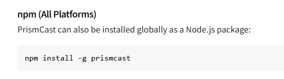

I’m struggling with downloading prismcast from GitHub. Downloaded zip file to my Mac but no dmg file
@llzel Use Homebrew.
I guess you missed my message above? There are prerequisites to download and install -- and then PrismCast itself is installed using one of those (Homebrew or Node in the case of MacOS):

npm (All Platforms)
PrismCast can also be installed globally as a Node.js package:
npm install -g prismcast
To upgrade to the latest version, use the builtin upgrade command or npm directly:
prismcast upgrade
# or: npm install -g prismcast
Once installed, you can start PrismCast with:
prismcast
I saw it I guess I have to install node.js on my Mac first. Correct?
Its not necessary. You can install without it
brew install hjdhjd/prismcast/prismcast
